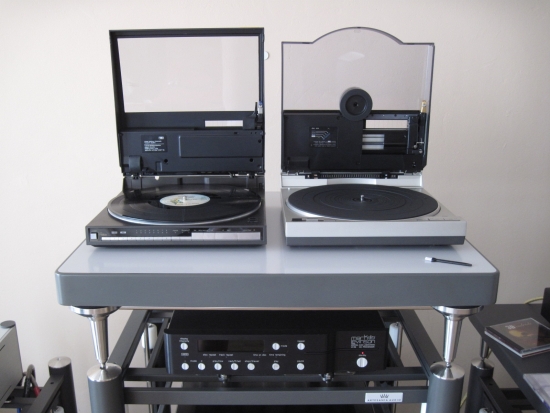

I have acquired a Technics SL-10 (1982 !!).
I don't have the EPS 310MC cartridge that was with it.
I am using the Technics P 30 S cartridge with JICO elliptic stylus.
I simply did a little maintenance by replacing the tonearm motor belt, lubricating the same mechanism with silicone with teflon and placing 500,000 silicone in the descent of the tonearm.
Great turntable; silent perfect rotation stability; Very well muffled and great sound.
It is a pity that the EPC 310 MC does not already have a MM-MC selectable mobile coil cartridge preamplifier incorporated.

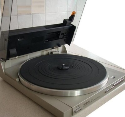

At the polar opposite end of the quality scale from your SL-10, I have a Technics SL-3 in my collection. The SL-3 is a DC servo control belt drive linear tracker. I bought it new, as part of a midi system, for my then wife-to-be and it sure looks the business with its chunky aluminium platter. The tone arm descends rather abruptly though and I could do with your assistance in replacing the damping fluid! But no matter as I retain it mainly for its looks and tend to spin my vinyl elsewhere. 🙂

I would love someone to correct me but on my SL5, there appears to be no way of refilling the lowering device with damping fluid. I had mine stripped down and could see no way of doing this. The arm on my turntable drops quite quickly as well and although I don't think it is causing any damage to the cartridge, I would like it to be slower. I am pretty sure the SL7 and perhaps the SL6 have the facility to top up fluid but not in models before that. Like I say, I would love to be corrected.

The Technics turntable tonearm buffer I think is all similar.
There is a cylinder with a central shaft lubricated with dense silicone (300,000 to 500,000). Operated with a solenoid which, when activated, drops the tonearm.
It is easy to remove. Just screw and remove it to the right.
I advise photographs at each step of disarmament and then assemble it correctly.
The silicone is placed between the cylinder and the shaft.
Place the "lever" as it is in the photo before disassembly.
