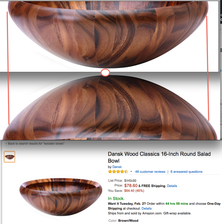

I've seen wooden bowls that would make beautiful radial horns, you could make a pair of 90 degree horns from one bowl and some matching hardwood panels with hand tools in a few hours.
Allow another few hours for finish work, and another hour for vacuuming up...
Art
Did I mention under $200 each? 🙂
Best,
Erik
Eric,
My math was wrong in the previous post, you can make a pair of 60 degree horns from a single bowl, for wider dispersion you need to figure one bowl each.
Act now, you could get a pair of 16" bowls for $157, and still have $243 to buy some nice exotic contrasting wood for the top and side panels...ummm, ebony...
10" bowls are going for $50 or less..
