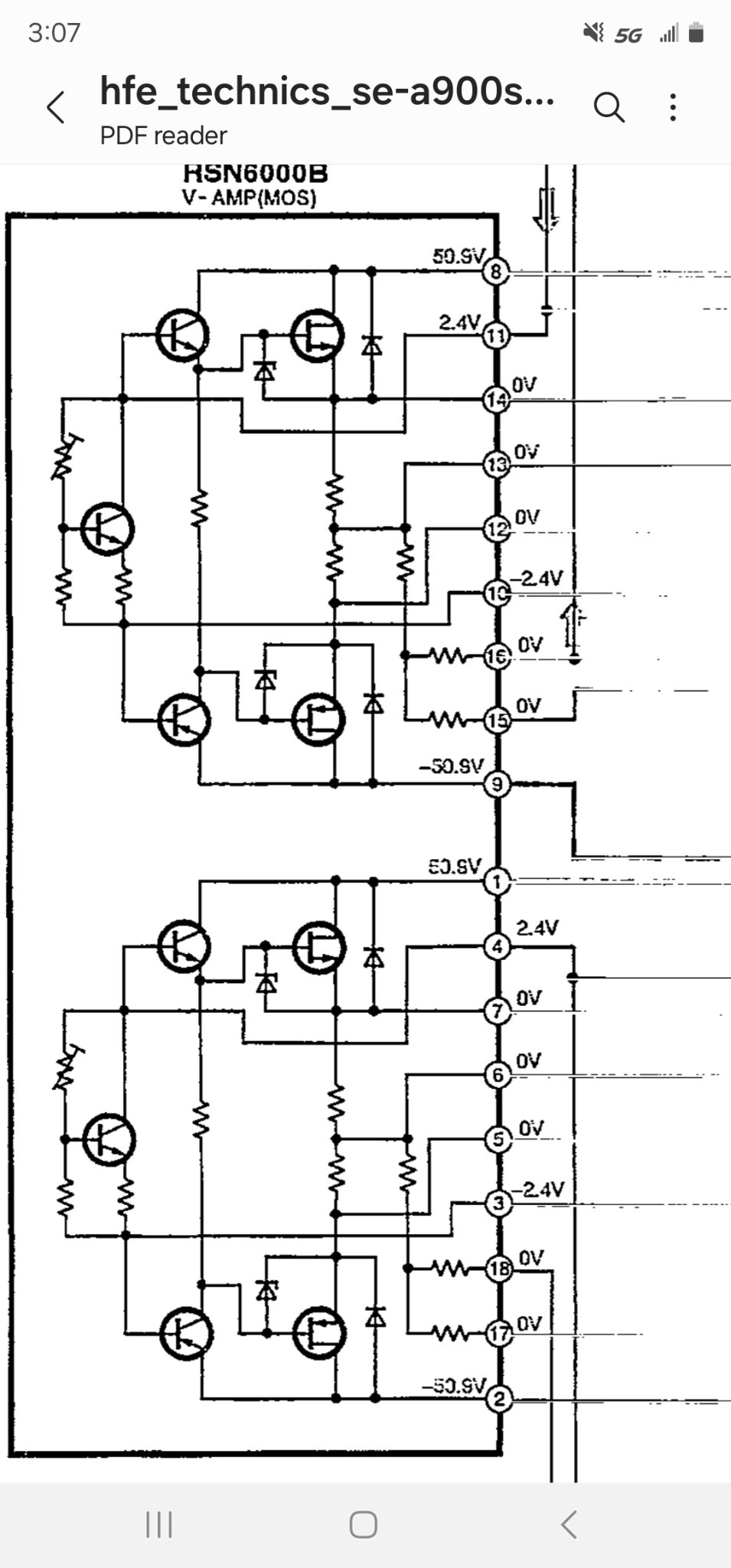

This amp has one chip on input for both channels, providing voltage gain, followed by discrete output stage as power pack with bjt drivers and mosfet outputs. Running at +/_ 50 volts.

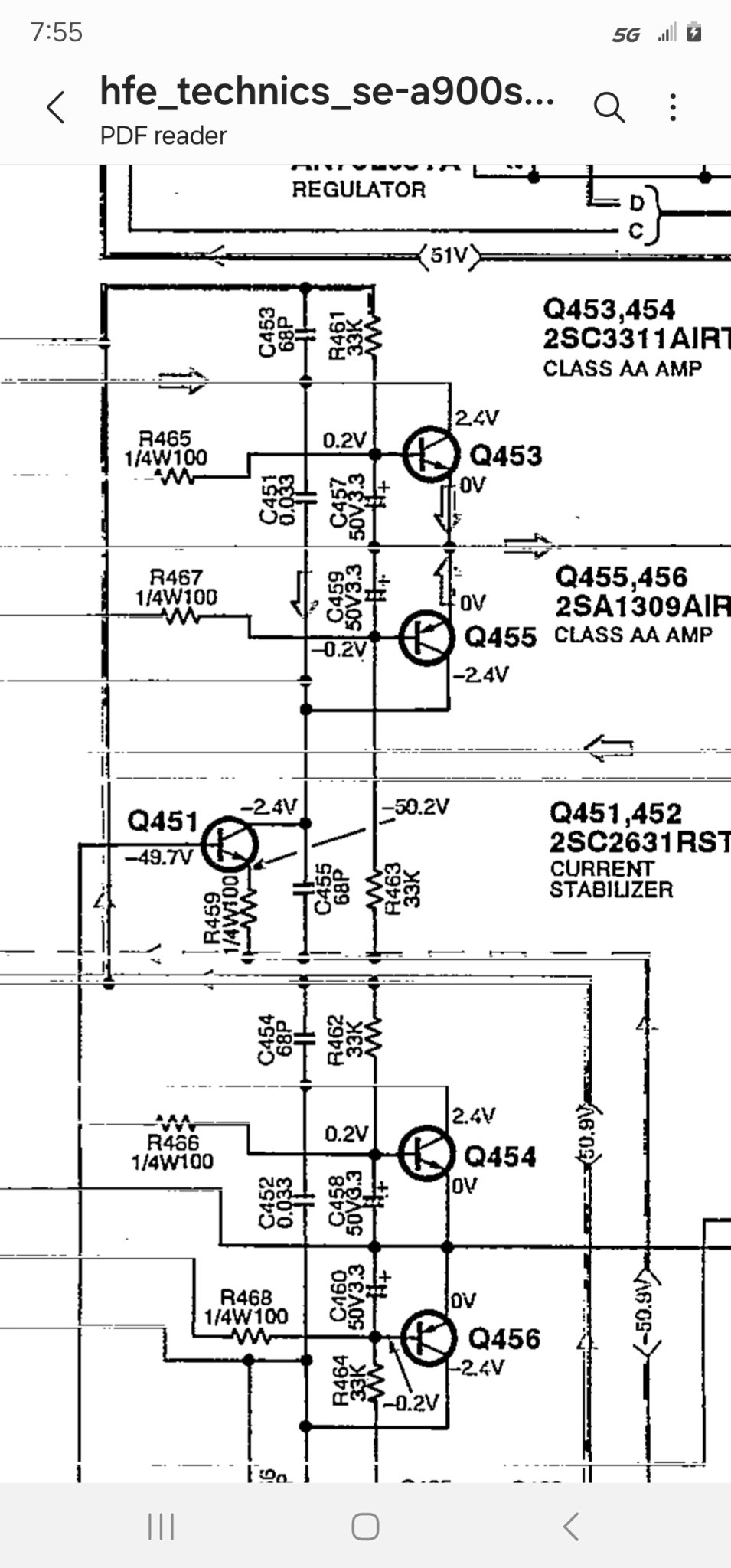

There is complete service manual at hifiengine. I would just check if all the expected voltages at checkpoints are as in manual.

That's absolutely correct.This amp has one chip on input for both channels, providing voltage gain, followed by discrete output stage as power pack with bjt drivers and mosfet outputs. Running at +/_ 50 volts.
The AN7062N IC basically contains the famous input circuit of the SE-A100...
followed by the output stage, which is in the RSN6000B V-MOS source follower in combination with 2SC3311airta & 2SA1309 airta BJT's.
That's the voltage amplifier. The current amplifier is in the SVI3205B hybrid block and is definitely not a V-MOS, but a BJT EF blaster - but, I'm not really sure whether there isn't a MOS-FET source follower power amplifier in there.
If that is the case (I think it was!), then this hybrid block will unfortunately have a constant power dissipation of about 2 * 10W, but that will never heat the heatsink to 60°C.
