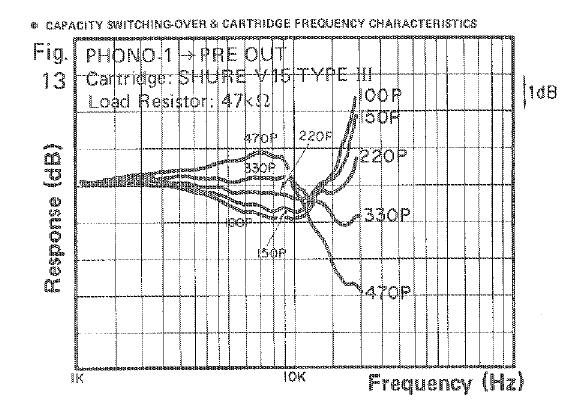

I don't know wether the cable just goes to a terminal on the back of the turntable or wether the cable goes directly to the phono pre.
In case the cable goes from the turntable internals to the phono pre I just can strongly recommend you that you keep an eye on the capacitance of this cable!!
Moving magnet cartridges are depending on the exact value of capacitance to work properly!! That means to give a neutral frequency response.
For every single mm-cartridge the manufacturer recommends a capacitance which includes also the value of the cable. These values are around 100-200pF and are often already provided by the cable alone! Typ. values of cables are around 100pF per meter!
If you don't keep an eye on this you'll wonder why mms sound that bad (no heights, too much heights) and convert unnecessarily to MCs which are less sensitive on capacitance (but have other troubles).
All the best and please let me know in case I expressed myself not understandably, Hannes

Thank you for helping me to understand better the dynamics of what helps and hurts the TT to sound better. I understood just fine!😀
This was not an expensive TT. It was $150 USD or maybe less in 1978. It doesn't do anything exceptionally well like more expensive TTs but it doesn't really do anything bad either. Plus it is a reliable workhorse.
The cables from the TT to any Preamp are what is in question. At one end are the traditional cheap plastic RCAs attached to cheap shielded cable (0.1 inches in diameter), that are attached at the other end to a PCB inside the TT where they are soldered. The wires from the Tonearm/Headset are also soldered to this small PCB, so the PCB is the interface between the Tonearm and the Cables and the Internal Ground.
Capacitance, this is why I was asking if there was a kit to replace the cables that was already designed to keep all the values where they would allow the TT to perform best (at a reasonable cost). OR someone with experience on these to tell me what they designed/used with the same issues in mind. I don't have any equipment to measure Capacitance. Also, I didn't know what value I needed to be with a MM cartridge. (thanks Hannes).
So that is why I am here, but I am getting the feeling that I should just cut off the old RCAs and solder on some better new ones!

Ok I understand better now.
First let me say that the Technics is a perfectly fine turntable that to replace with something similar performing is very hard today.
Further don't forget that 150$ 30 years ago are a lot more today (inflation) and in addition production costs were far lower back then because the production volume (number of produced/sold units) was extremely much higher than today. Today this is a tiny market not even of interest to the big players.
No need to talk smallish about your technics!
Now to the interesting part of my posting:
Tell me your cartridge and I'll try to find the capacitance recommendation of its manufacturer (or ask people that might know), so that you have a basis to decide.
Further I would recommend that - in case you still want to replace the cable+plugs - you use a cable with a capacitance of about 100pF/m and use 1m length of it.
2nd it would be necessary to know how much capacitance is on your phono preamp input (usually stated in the technical details of your pre, usually in the owner's manual).
Then you know how much in total (you just need to add these 2 numbers) you have.
Increasing it is not the problem (if you have switchable capacitance, you can select anyway, otherwise you can just solder in additional capacitance), decreasing is not possible. That's the reason why I recommend 100pF/m and 1m length. Depending on your phono pre this is a solid figure to start.
All the best and have fun with your technics, Hannes

Hi Hannes,
So I did my homework and my preamp is looking for an input of: 2.5mV/47Kohms, but it says nothing about Capacitance. I contacted Rotel directly and they didn't have that info anywhere in their system.
My Cartridge is a Shure M97xE and has the following specs:
Optimum Load 47 kilohms, 200 - 300 picofarads/channel, including tone arm and amplifier input capacitance.
DC resistance 1550 ohms
Inductance 650 millihenries
I found a place online that sells better replacement cables for Technics Turntables for only $20 USD and that is right about what this is worth for an upgrade (59 to 65pF per meter): http://www.kabusa.com/frameset.htm?/index.htm

Hi Keith!
Great to hear of your progress!
The Shure is a great choice for sure! It even rhymes ;-)
Just a pity there's no data on the rotel pre!
If you could tell me the exact model no of your Rotel pre, I could have a look.
By the way, ~60pF per meter is a bit on the low side, but of course the lower the better. Increasing it is not the problem. Depending on the Rotel, you will eventually need to add some capacity (easiest to solder an axial pp-cap in the the RCA-plugs to achieve this).
All the best, Hannes
