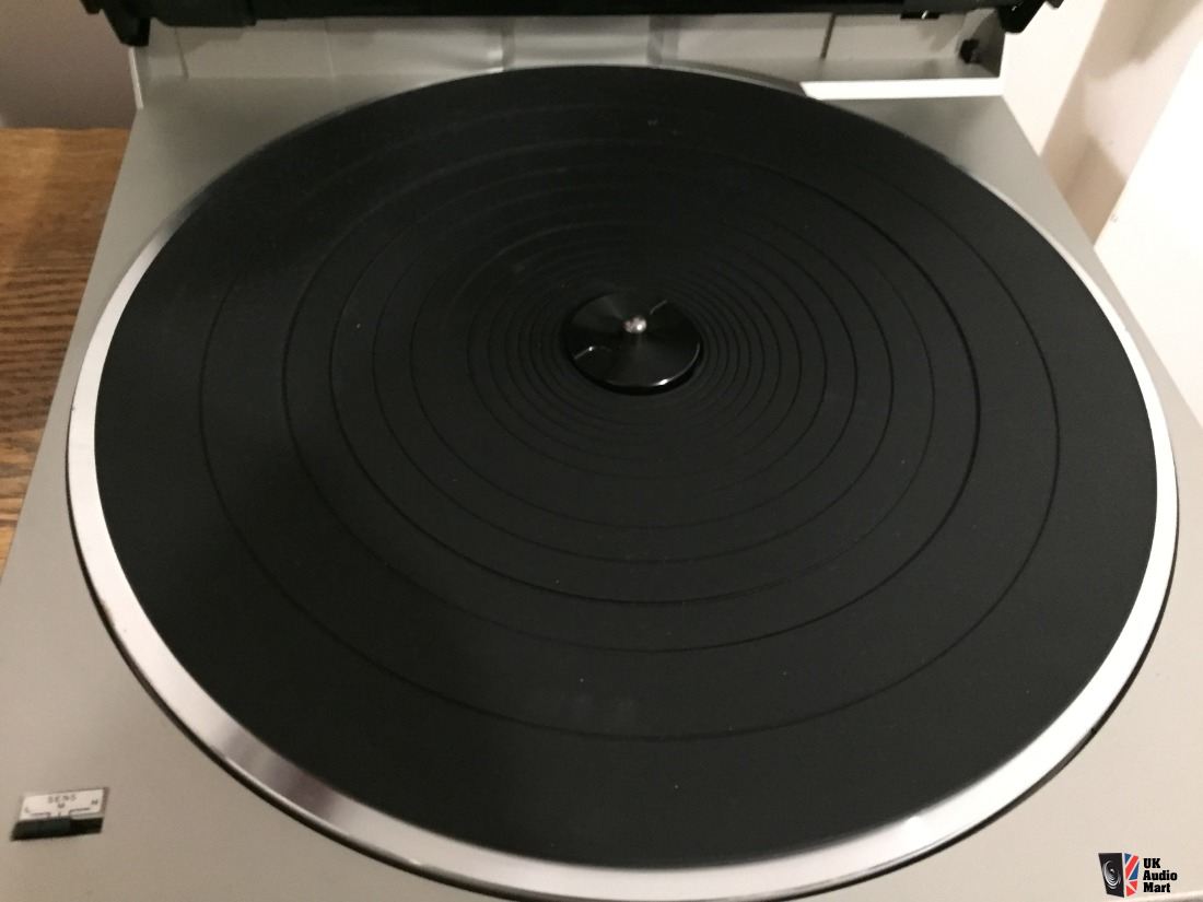

Hi. I need to buy a new rubber mat for my SL6 and do not have the original. Please can you give me the inner / outer diameter with the 45 rpm adapter hole and the thickness of the mat.
I think the outer diameter is 285mm and inner diameter is 45mm and thickness is 3mm but would be grateful if you could confirm this. I have found a company thart will make what I want but I need to get the measurements correct.

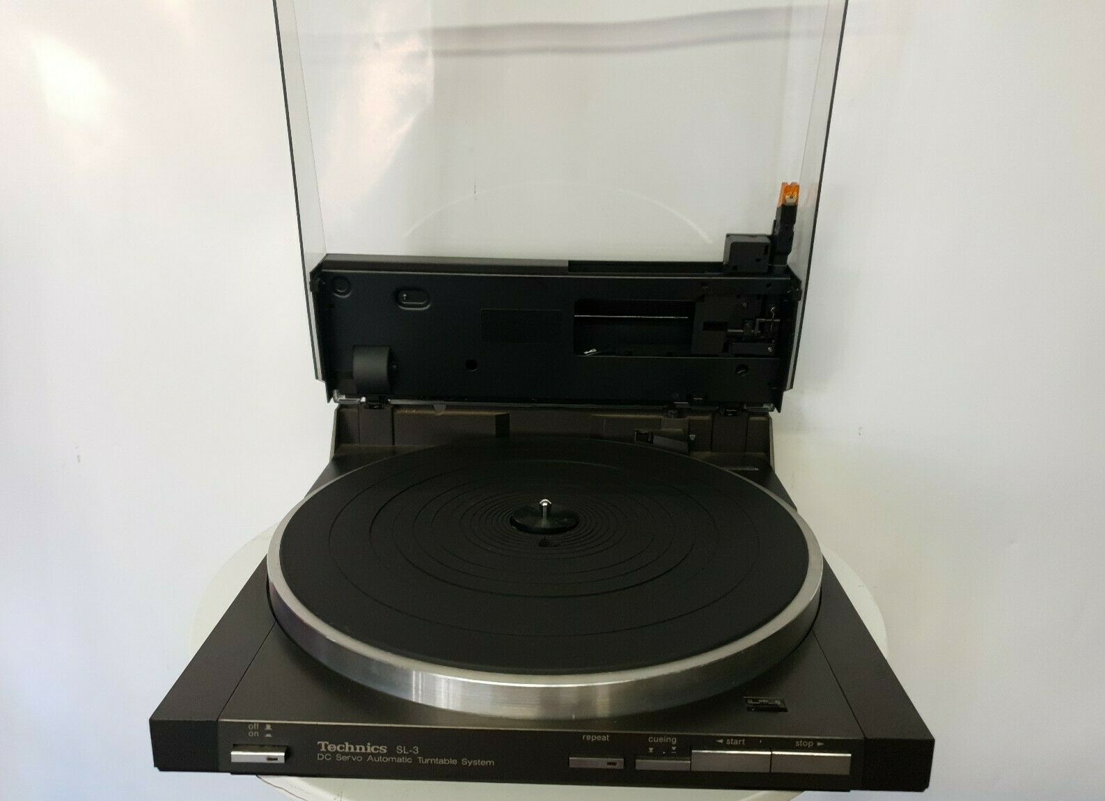

The mat on my SL-3 measures 286mm in diameter and the 45rpm adaptor hole is 40mm in diameter. Thickness is 3mm.
I think you have made a mistake with your inner diameter as a 45rpm adaptor has a standard size of 38mm.
The 40mm hole in my mat allows sufficient clearance for the 38mm adaptor so that it can pop up without hindrance. My mat is flat and does not fit into a recess.

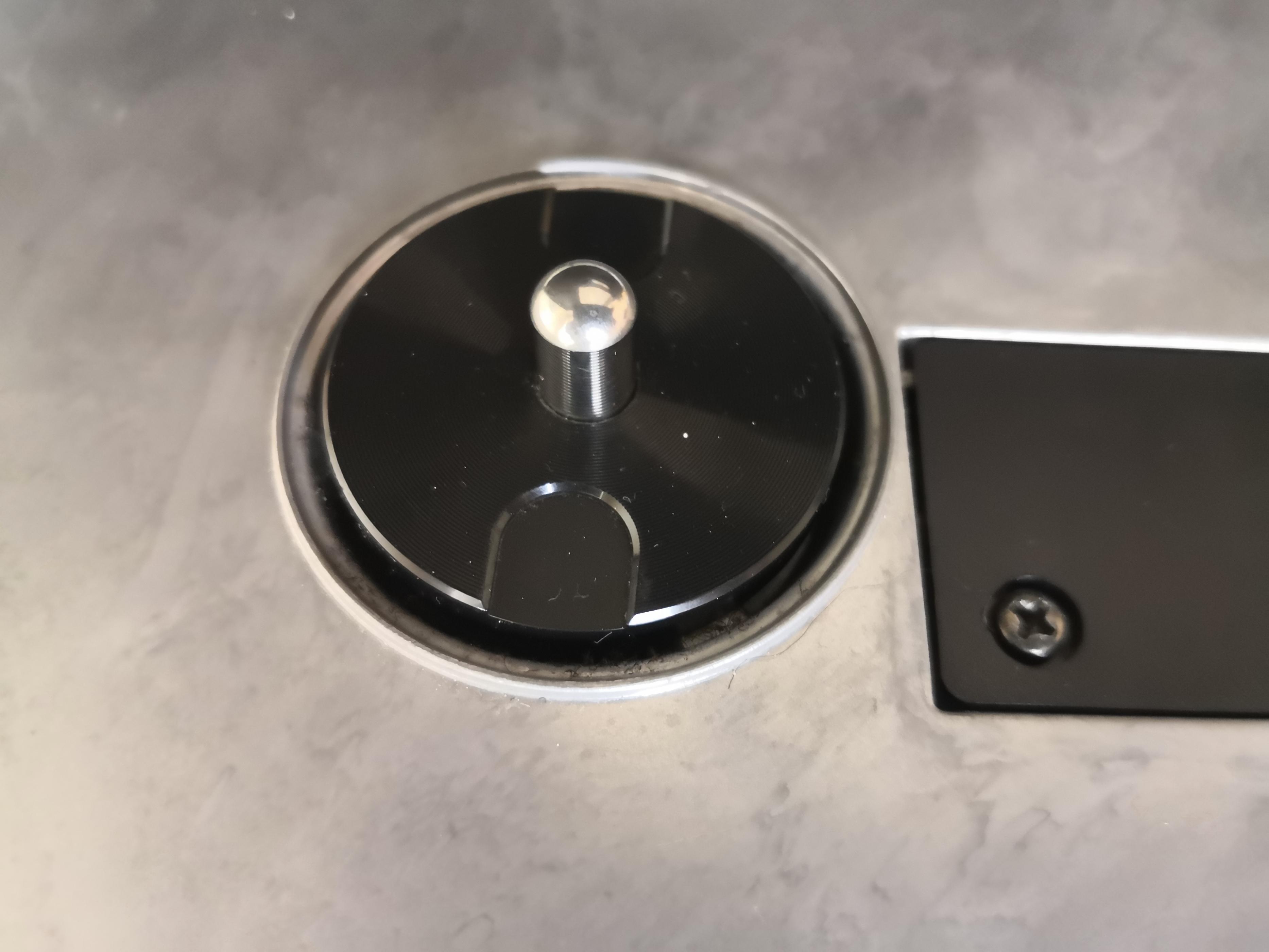

The comapny that will make the mat can only do a mat of a fixed thickness while the original mats had different thicknesses throughout the mat with a thinner section near the doughnut recess and ciuld therefre sit on top of the recess.
If the replacement mat is of a unifrom thickness then the section near the doughnut will sit higher above the recess if you know what I mean.
What do you think?
What do you think?
I don't think a mat of uniform thickness will detract from the operation of the turntable. May not look as neat a fit as the original mat, that's all.
I attach an image of an SL-3 and an Sl-6 for comparison purposes.

Re-reading your posts. I think I now understand correctly what you mean. On your photo, it appears there is a circular raised lip (not a recess) on the platter around the central opening for the 45rpm adaptor.
In that case, the diameter of the hole in the middle of the mat would have to be large enough to clear that lip.
