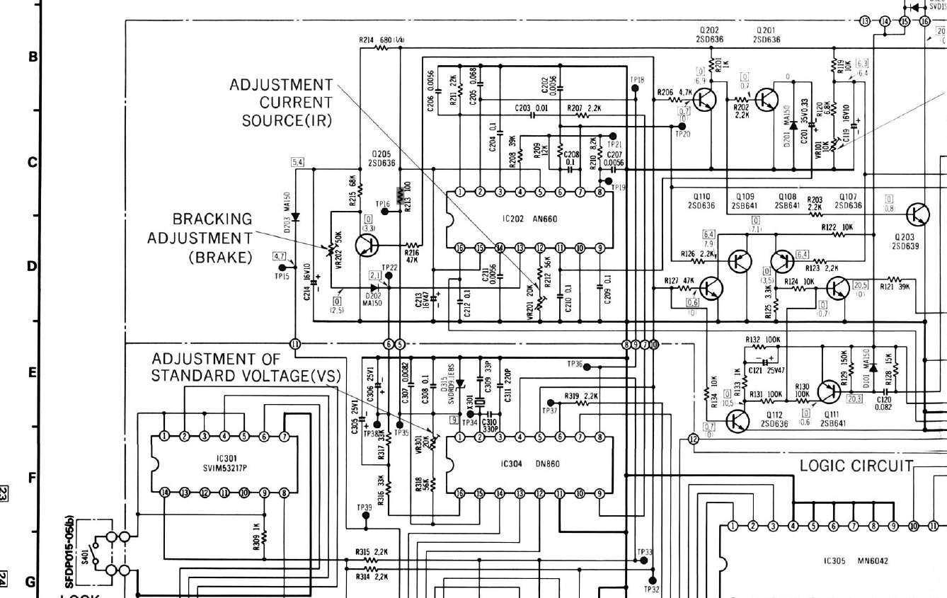

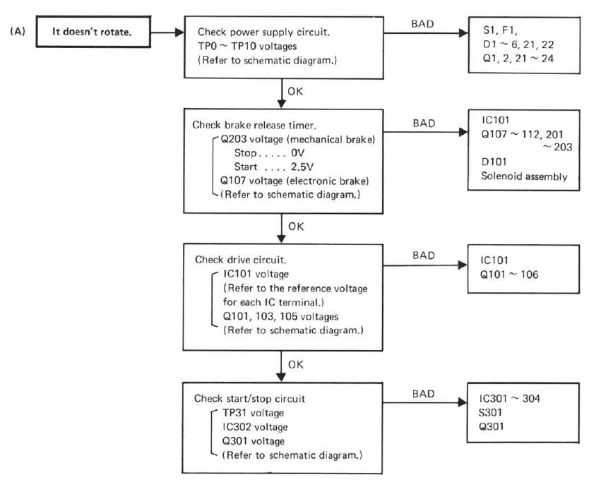

The turntable stopped spinning in between a record change. One second everything was normal, next second it was not spinning anymore. I opened it up again and started checking. The Trouble Shooting section in the service manual starts with the voltages and moves on to the brake logic and ends up with blaming IC301 to IC3014 for the possible cause. This is where I got confused.

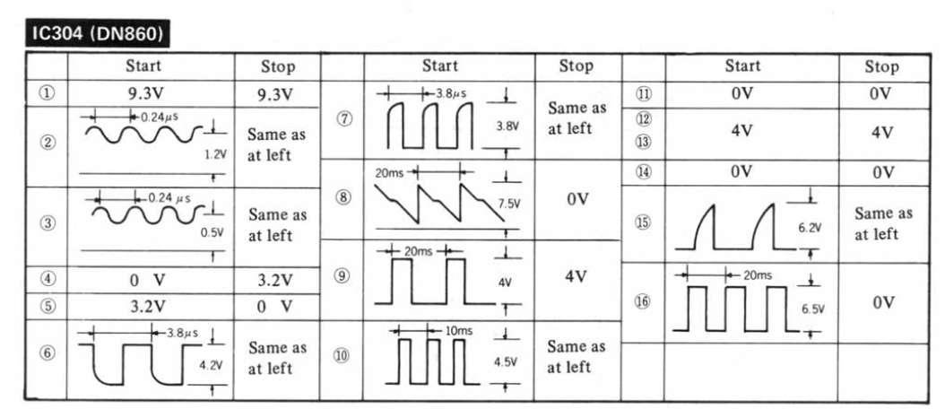

As far as I can see, my voltages are correct. The brake mechanism is working, but when it comes to pin-9 on DN860, I see no change between Start and Stop voltage readings. On the scope screen the only state I can observe belongs to the Stop case, although all other voltage readings follow the status changes as indicated in the service manual between Start and Stop conditions.
Observing the Start/Stop changes in other pins but not observing any changes on pins 8 & 9 tells me that this DN860 is faulty. Is my logic correct or is there something else which may cause this IC to malfunction? Anybody experienced with the caprices of SP-15s?

Do you have 3.8us on pin 6 (FO) and pin 7 (FI) on the DN860?
Yes, I have them both, with correct period (3.8us) and with correct voltage amplitude.
If start/stop signal transitions are correct then yes, seems likely the issue is the DN860, though it's rare for it to fail.
Thank you for supporting my observations. You are correct, not much on failing DN860s out there, that is why I was not clear with my deductions.
