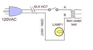

Because the fuse blows right away, indicates a short somewhere. The most likely area is the power supply or possibly the output devices. This amplifier uses a pair of large scale integrated circuits (LSIC). These are the two black things connected to the heat sink. To eliminate the possibility of a shorted power transformer, unplug the white connector cable running from the transformer circuit board (green) to the main board (brown). There should be a disconnect at the brown board. Then replace the fuse and try turning it on. If the fuse stays ok your problem in on the main board. If it blows there are 4 rectifier diodes on the small green board that could also cause it. Otherwise it may be the transformer.
There are 4 larger power supply diodes on the main (brown) board near the two standing black capacitors that must be checked. You will need a decent multimeter to check these. Lacking that, there is little more you can do yourself.
Also, to save on fuses, a series light bulb tester is very handy. This means putting an incandescent lamp (60 to 100Ws) in series with the AC line. This is something you make yourself.

I have also noticed, by studying the manual, that the front panel power button does not control the AC mains voltage directly. Under normal operating conditions, when the AC plug is connected to the house power, the power transformer is always seeing voltage. The front panel button activates control circuity that operates relays (blue boxes) for applying DC to the unit. It does this by connecting the transformer's secondary voltage to the main bridge rectifiers. Those 4 diodes on the main board.
So what this means is if you can just plug it in with a good fuse (power button off) and not try turning it on via the front panel button, and it doesn't blow, the transformer and control voltage diodes on the green board are good. No need to disconnect the white (ribbon) cable. But if the fuse blows when pushing the button on, then there is a short somewhere on the main board. Most likely a rectifier, capacitor or even one of the output modules on the heat sink.
The rectifiers can be checked with an ohmmeter suitable for checking diodes. There should be high resistance in one direction, and very low resistance in the other direction. Low resistance in both directions would indicate a shorted diode.
