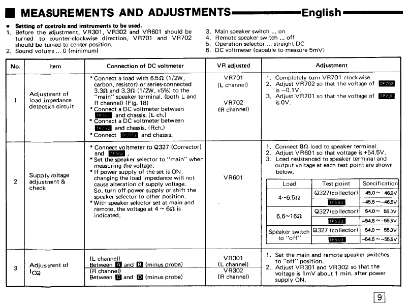

A manual link helps. FWIW, the little text fragment in #4 is of the adjustments procedure from the SUV9 here: https://www.hifiengine.com/manual_library/technics/su-v9.shtml
I've attached below a larger snip of the adjustments seen in that manual in English.
There is a difficulty following what this is for since it is not a straightforward class AB amplifier so this is'nt a typical class AB output stage bias current adjustment. The adjustment is for the load sensing detector which switches to lower power rails when low impedance or parallel pairs of speakers are fitted. This is necessary because the power supply is based on a small E-I power transformer which "sags" under a heavy 4 ohm load to protect the single output pair. The 6.5R test resistor then, is only representative of a load which should be the switchover point between 4 and 8 ohms. Knowing how variable speaker impedances are, it seems a pretty specific value to assign but I imagine anything around 6R will work as well in practical application.

Connect TP703 to chasis?
That's right, before you make the adjustments. Remove the connection afterward.

The Multimeter is first attached to TP703 and Chassis or do i put wire in the earth and attach to TP703.
I need dc volt of 0v for 701 and dc volt of -0.1V for 702.
Yes, they are asking to short TP703 to chassis ground during the adjustments.
This appears to override switch Q702, forcing its collector low.
