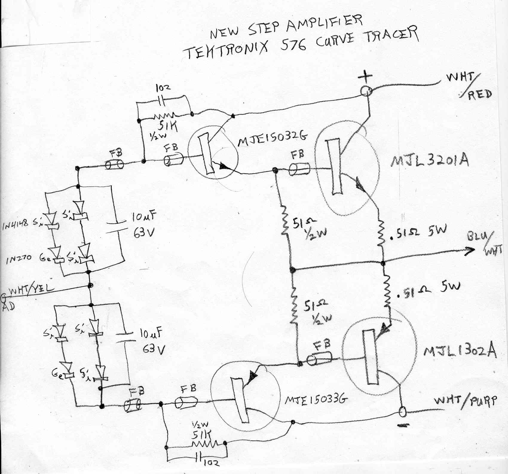

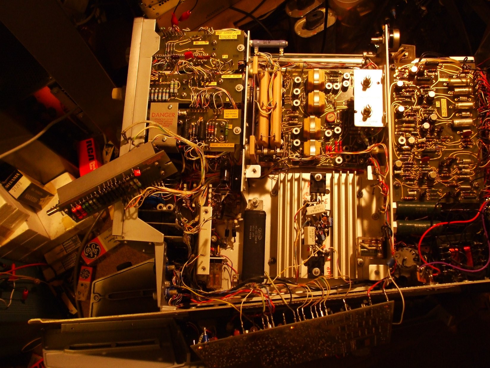

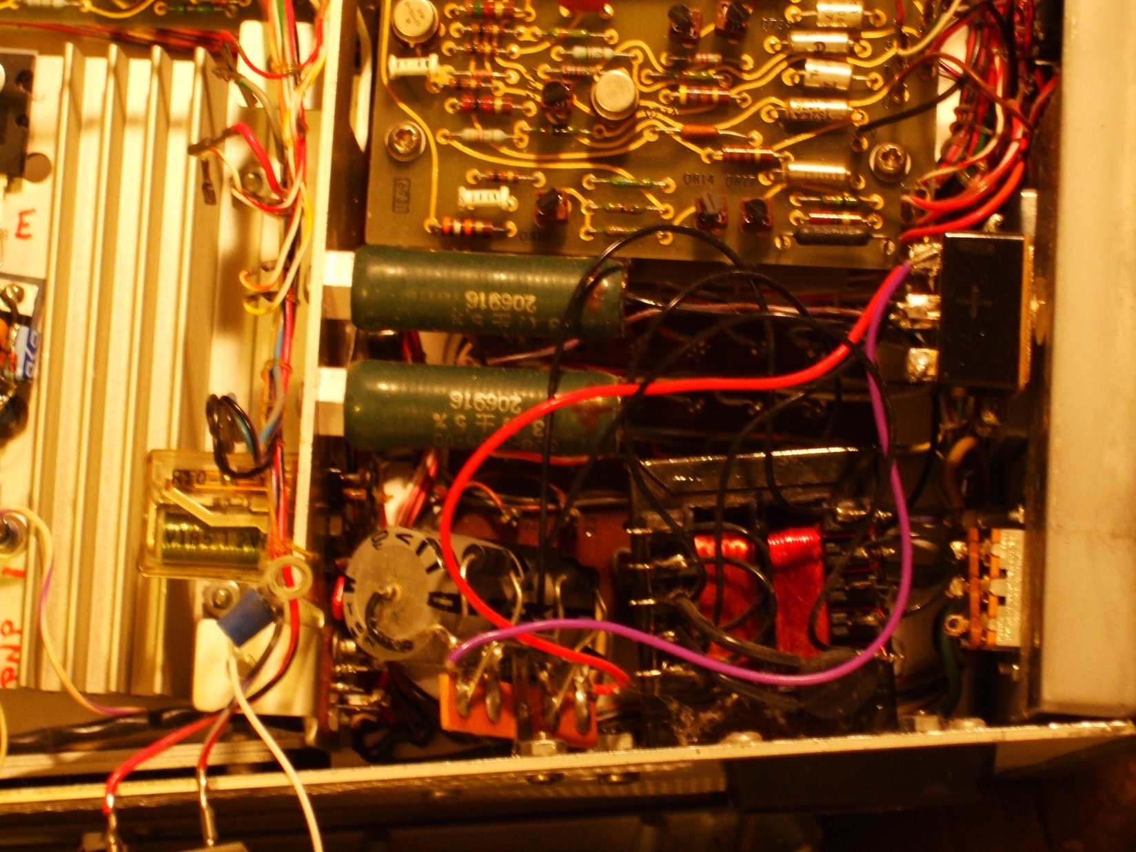

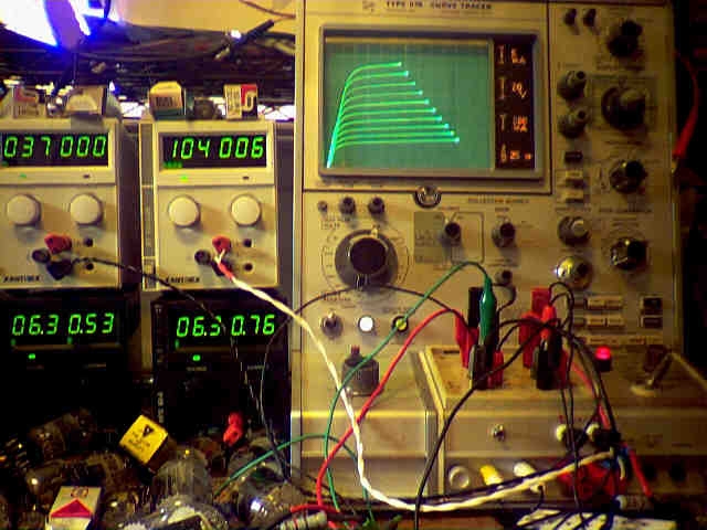

The "grid" (gate) voltage stepping does not have enough range for most tubes. A boost supply can be added which is switchable in series with the normal V step amplifier supply. Then the step amplifier assembly on the big aluminum heatsink (behind the step amplifier PC board) has to be replaced with HV transistors. I converted to a complementary design using MJL1302A and MJL3281A 260V transistors plus MJE15033 and MJE15032 250V drivers. (pics below) There are some 350V versions of all these available too.
Then some other parts in the step amplifier circuit need upgrading to higher voltage: CR391, CR393 changed to 600V 1 Amp. CR384, CR386 changed to UF301 3A 800V, C391 and C393 changed to 22 uF 350V.
The grid V stepping on this unit can now do a +/1 170V range, plus a fixed added V (like 50V) for grid 2 curve sets.
I also modded the collector supply switching to change the top 1500V scale to 750V (safer, and can supply higher current then for TV Sweep tube testing).
The E sense contacts on the test plug-in unit and the associated DUT toggle switch contacts were changed over to select one of two external screen voltage supplies. (so two different type tubes can be compared by just toggling the switch).
This way screen V only gets applied when a particular DUT tube is being curve traced.

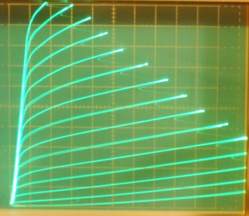

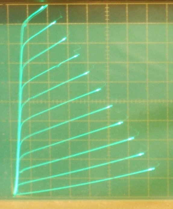

Then the step generation digital circuitry got modded to do 15 steps (selectable) instead of the 10 steps standard. TEK went out of their way to limit the 4 bit counter to a count of ten. Just pull out pin 12 of IC U72 (SN7400). A D/A resistor, R64, has to be changed to 1/2 value for a 1,2,4,8 current sequence. I just put a pot across it so it could be calibrated accurately.
There are also some connections on the "blue ribbon" connector to the plug-in DUT box that provide for external Vertical and Horizontal amplifier connections, plus two sets of contacts for relay switch-over from the normal internal Vert. or Horiz. signals. These were brought out to BNC connectors on the side with toggle switches for activating them. This is useful for things like plotting screen current from either a sense resistor below the screen supply or a DC current probe source (TEK AM503 ) or a TEK P5200 HV differential probe (maybe for UL, UltraLinear, tube setups).
Last pics show some of the new capabilities being used, like 750V plate sweep, and 15 traces. Crazy Drive linear tube operation. (found using the curve tracer)
