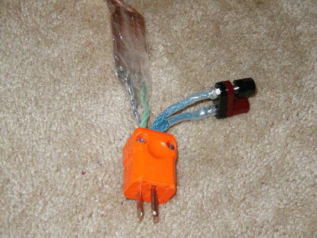

You should check out the DIY Cat 5 cable instructions at http://www.geocities.com/venhaus1/diycatfivecables.html these things are awesome. I tried them at home on my setup in place of my Nordost Flat Line and liked them more. They take a while to make but you really can't beat the price. If you make them and dont like them at first give them time to break in, I have yet to understand how a cable needs time to break in, but after 70 hours or so they sound amazing. The most amazing part has to be the price...they are so incredibly cheap to make and they sound great. the capacitance thing has been brought up as an issue but it isnt like they have a higher capacitance than any other wire out there, it is said on the website that they compare to other high capacitance wires like kimber kable, etc. I think that if a little more capacitance is what you have to have to get that low of inductance then it might be worth it. I listened to them with both a Curcio ST-70 and a Fisher power amp and neither one of the amps had a problem with the capacitance. Just throught I would throw this out there.
I just made myself some 6 foot CAT5 cables with a pair of 9 conductor braids for each. Prior to using the CAT5, I was using acoustic research 16 gauge speaker wire, which was working pretty good. I don't think my system has the resolution to enable me to hear any major difference between the AR and the CAT5 cables...though with the CAT5 cables it SEEMS like sounds are more defined. When playing music, it is easier for me to distinguish different instruments. Note that I said it SEEMS like this...I really have no way to prove that these cables are any better or worse than the AR cables. My amp is a Kenwood VR309 and my speakers are Sony SSMF515s.
