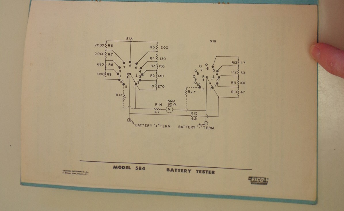

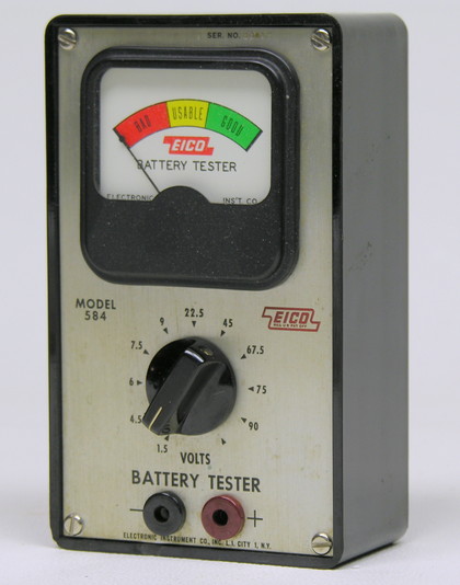

For years I have used an Eico type 584 battery tester. It measures voltage under a nominal load and has served me well for ages.
Interesting, uses a ~6.5 ohm shunt (6.8 + 137 parallel to it for meter) for 1.5V batteries, which gives ~230mA. This gives a roughly 9 hour rate of discharge for a AA. Seems to be testing at roughly C/10 then, also with 9V batteries
Interesting schematic, simple enough to cobble together, maybe with a cheap switch like this:
