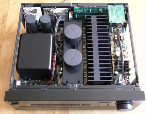

I have a Sony TA-f808es integrated amp not working I posted on another thread. I was advised to test the filter caps, so hence this posting about the caps.

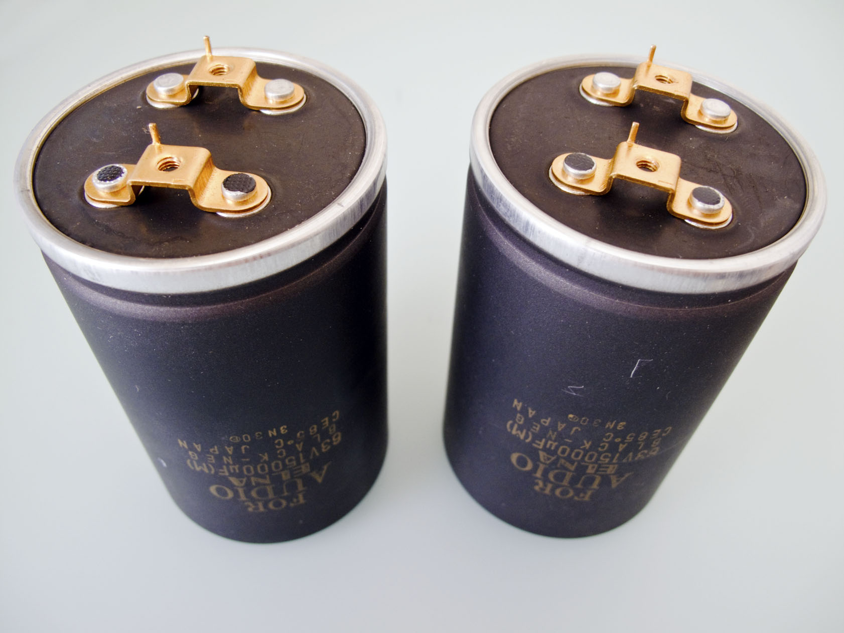

This post is about testing and locating replacement for the massive screw-type electrolyte filter caps (show in the enclosed photos).
They are Elna 'for audio' 15,000 uf, 63v, 85ºC behemoths, measuring 63mm dia. x 104mm high to screw terminal. (Diameter is important as they fit into a plasitc clamp mounting bracket.)
I have a Fluke 179 multimeter, but capacitance test limit is 10,000uf so testing them reads 'OL' (over the limit/range).
I'm a novice and don't know how to test leakage, but here are my other readings if they mean anything:
Left cap: / Right cap:
41.04 ohms / OL
.985 DC volts / 1.2 DC volts
Do my results mean anything, and how do I test leakage?
Do my results reveal that I need to replace them?
I searched high and low and can't find replacements to match on-line?

When you say "not working"...did you measure the power supply voltages? The best way to measure an electrolytic cap is with an E.S.R meter. You can use a bigger cap like 18000uf or even 20000uf...not a problem. As long as they are same voltage rating or higher all will be fine.

If you've got the caps out of the amplifier, try them with a DC supply to see if they are the cause of the failure.

Don't cut them open.
Search for the method to measure leakage current and the method to determine ESR.
Download the datasheet to see what the specification is.

Other way just place back the caps, plug the cord & measure the DC voltage on them...
usually DC voltage on caps is VAC * 1.414 or just a little less...
if you can disconnect all the load, just trafo, bridge diode & elco's...
That for now so we know what cause this amp dead, maybe no by the elco's they looks good 😀

If no ESR meter is present, one can also look at ripple on the supply rails with a scope.
BTW, these big can-type caps from reputable manufacturers usually last a long time in regular domestic use. Good quality parts can be as good as new after 40 years in some cases. Even if they do fail, nothing dramatic happens - you may not even notice the reduced peak power until eventually the unit starts to produce audible hum. We're usually talking ~35-year-old units at this point.

Just connect them to a DC supply and see if they charge up. Then disconnect the DC supply and see if they hold their charge. This will be a VERY BASIC indication of their functioning. At this moment you are just trying to ascertain what has caused the amp to fail. They might well be leaky and they might well be faulty but if they still function as caps the amp will work to a fashion.
There have been some very good posts provided on the forum in response to your question about testing BIG caps but if you are a novice some of the advice may not be appropriate or easily applied with your present knowledge, so let me summarize some reasonable options for you.
a) First of all finding out why the amp is not working would be my first priority, and if it is because of the CAPS then great, but if not you still have a more important task to pursue.
b) Agree with the post that talks about measuring the ripple on the power supply with the caps in-circuit, this will tell you much about the health of the power supply (PS) circuit (but not thoroughly determine individual CAP characteristics) and you would need an oscilloscope and the know-how for hooking it up safely to measure the AC ripple on the DC voltage rails of your amps power supply...again maybe not your thing and there is high amperage here that can be dangerous and harmful.
c) Since you already have the CAPS out of circuit (and hopefully properly discharged them!) you can do some easy static testing as follows:

iii) Buy an ESR meter to measure the internal resistance of the cap - over time caps build internal resistance and often fail
- caps that are 3 - 10 times the internal resistance stated by manufacturer are problematic and could fail catastrophically
- by far the best choice for older or suspect caps is an ESR meter - you can build one in 3 days from this kit:
Ana Tek Corporation
After static testing is done you will know how healthy the caps really are and whether you even need to replace them. There is no expiration date on these BIG caps, but the ESR (equivalent series resistance) will usually tell you if an older cap is in trouble. This meter sends a 'smart' pulse-signal through the cap at VERY high frequencies to cleverly measure equivalent series resistance inside . Regarding replacement parts, finding exact replacements for caps/clamps is part of the 'fun' of this hobby since most manufacturers of original caps are long out-of-business by the time they actually fail, finding the right size and specifications for any cap requires careful research and plenty of money ($$). Good luck with your amp project.
