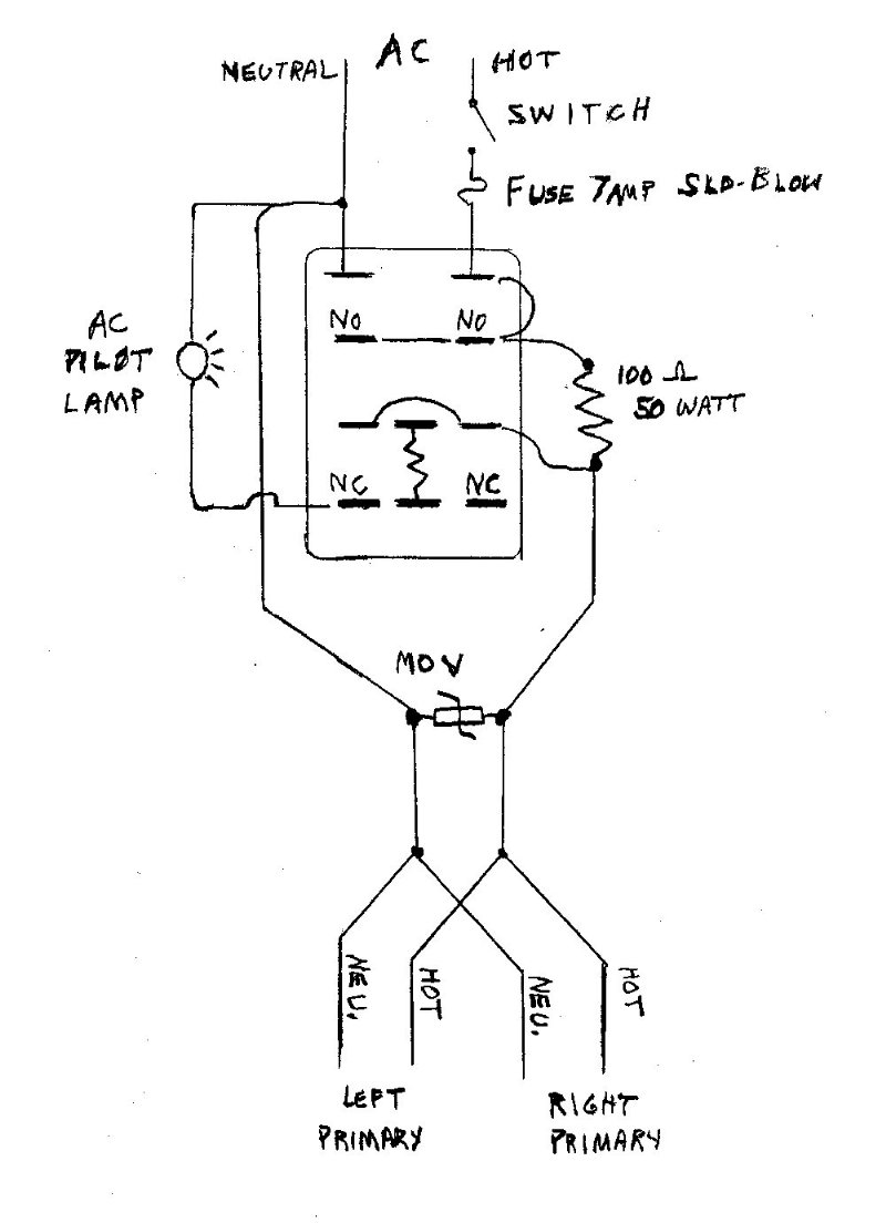

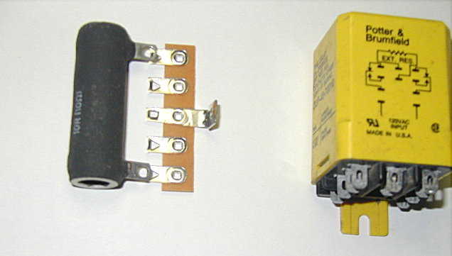

Several years ago I purchased several used P&B 120 VAC time delay relays from an eBay auction. Since then some have failed but I still have 3 that are installed and working. You can see the selection available now at eBay:
All Categories
I used a Potter and Brumfield CUF-41-71012 relay and with it a 75K ohms resistor = 4.4 sec. delay, 140Kohms = 7.3 sec, 200 Kohms = 9.7 sec. delay. The time before the relay closes its contacts is dependent on the circuit in the particular relay you use. Which relay do you have?
I use a 25 to 50 ohm power surge resistor in the large ceramic case rated at (I believe) 50 watts between the relay and the amplifier to control the incoming 120 VAC. The value for this surge power resistor is dependent on the amount of capacitance to be charged.
Most relays now available have a knob on top to dial in the delay time desired and don't require attaching a small value resistor to control its timing circuit.

I have had no problem or issues using this system. But, it is important to have a light that turns off when the relay contacts close. One time a relay did not close and the surge resistor was left in circuit for a several minutes until I smelled it getting hot and realized there was a problem. This fault could start a fire! Exact values of delay and surge resistors were adjusted by trial and error to give the final time delay that seemed best for my particular amplifiers.

If I were a trained EE I probably could crank out some equations to determine the best time span to allow those really big caps of yours to charge. I found that 7 seconds was enough for me to charge up around 130K of uF -- without the lights dimming very much; and with 50 ohms resistance in the AC between the relay and the amp/s. Also, you have to consider the stress placed on the diode bridge as the large caps are charging. Is your transformer an old type IE or a toroid? But, it is generally agreed that any amount of capacitance in a power supply beyond ~50k uF a suppression circuit of some kind is required so as not to fry the ON/OFF switch or blow out the diode bridge.
If you look at my schematic in the previous messages you can see how I connected a small AC bulb to light up while the delay contacts were NOT tripped and that when the circuit does trip the bulb would be disengaged. I have my relay and other parts of the delay circuit mounted up in a metal case (from an old AT computer power supply). So, I watch what happens when I flip its master switch to engage the relay circuit and if the AC bulb does not go off as the delay time expires I know the relay has "stuck" or is not functioning properly. If it were to do so the surge resistor would still be in the AC circuit and it would continue to get hotter and hotter.
I suppose I could mount a thermal switch close to this resistor that would cut off the AC if it got too hot. Check the schematic for a Hafler DH-200 on how these thermal switches are used.
I never bothered with a transient suppression circuit as I never sensed the relay contacts were chattering.
