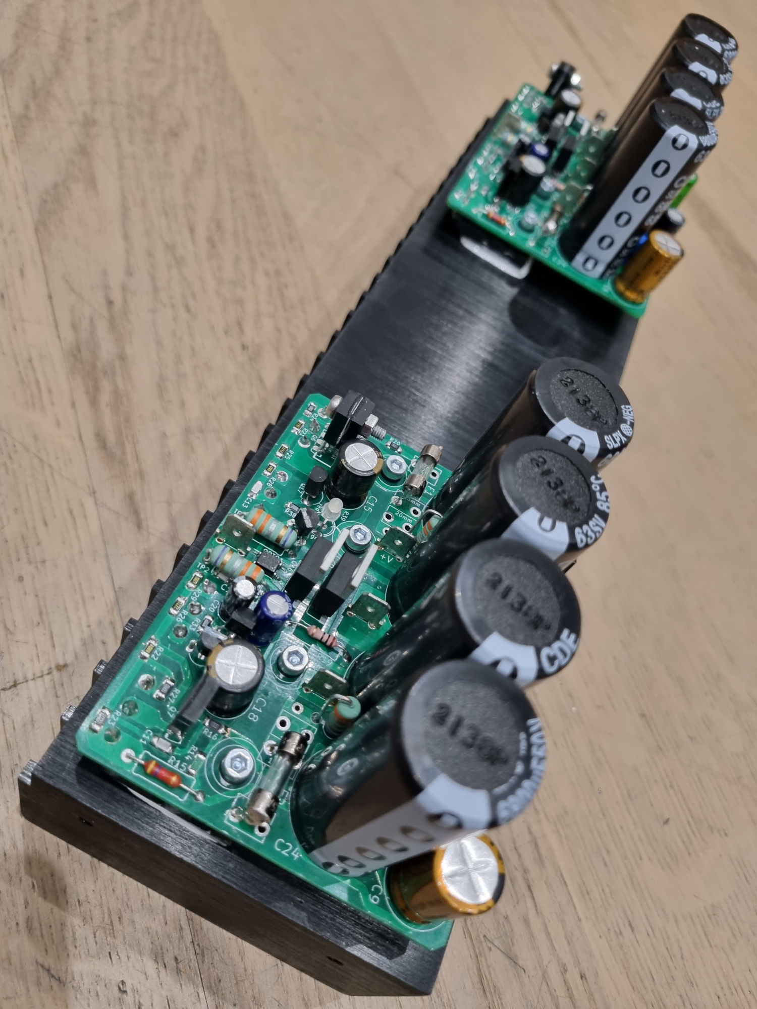

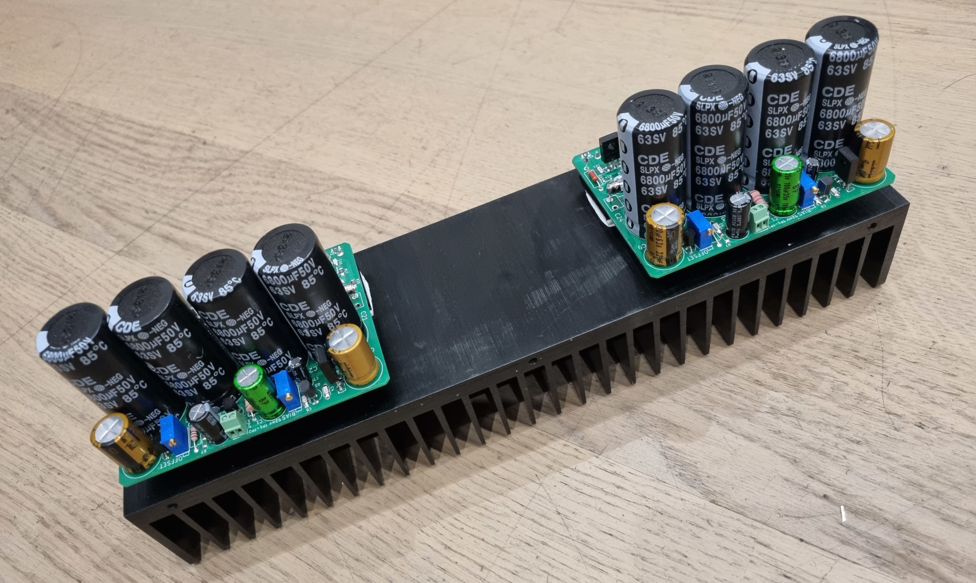

I built the boards, everything seems to work fine, except the green side of the dual LED doesn't go on, only the red at power on for a few seconds and if offset is adjusted for high DC. I double checked the schematic, maybe it's because I tested with a +/-38V PSU. Also I used VOM1271 to drive the mute mosfets. I will carry out more tests and post pictures soon. @Bigun, do you prefer me to open a new thread for my build?
Reactions: StevenCrook
I’m happy to see you continue in this thread.
That LED comment gives me dejavu, meaning that I may have experienced a similar issue, so it’s worth looking back through the thread for the solution.
edit: post #232, the LED is a mistake from me 🙁
It can be fixed as described but darn it should have put this information somewhere in the first post. I’ll add it.
edit 2: I see that post #314 is where I made my fix. I feel bad about that, I owe somebody a beer.
You fella’s are tempting me to build some more boards myself, to get the TGM8 into my home theatre set-up.

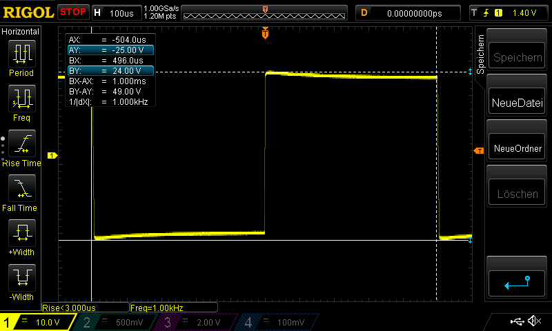

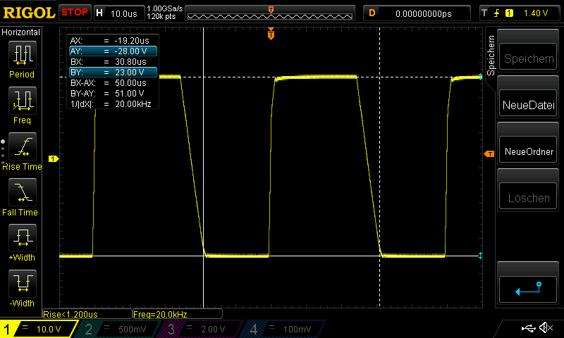

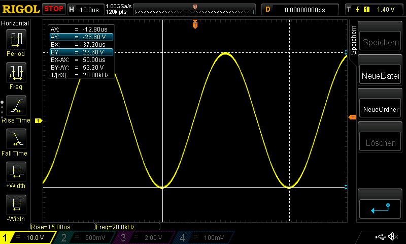

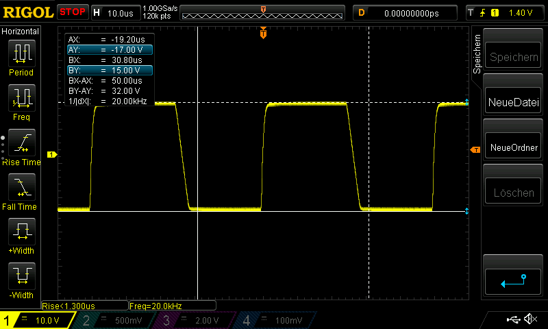

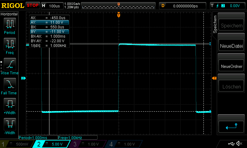

I inserted the diodes as shown in #314, now the LEDs work as intended! Here are some pictures and scope shots taken at the 8R load resistor. Nice and stable up to very high power. Sine is symmetric all the way up, the square waves have some offset (see the blue highlighted "AY" and "BY" values in the box in the upper left corner): more offset with more power and also with higher frequency. Does that indicate a problem or build mistake?
