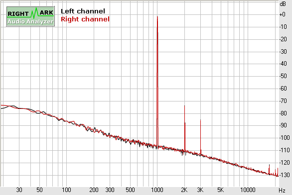

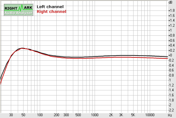

Here are some measurement results for the Kora 3T MM SE - the frequency response using precision (<0.1% error) reverse RIAA and the distortion spectrum for 1kHz 1V RMS output. Both graphs are typical for production units.
Cheers
Alex

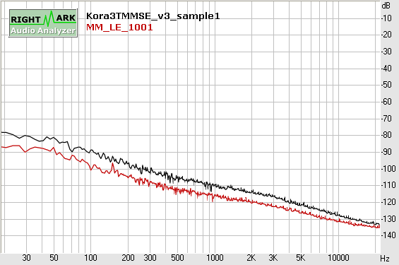

The most important difference between the SE and the LE versions is in the type of FETs used - LE uses a completely different type of FETs with about 6-7dB lower noise. Also there are differences in the quality of passive components used and their matching. All passive components for the LE version are matched to 0.1% between channels, output capacitors are Black Gate and premium resistors are used in several positions. That is all I can say as the LE is still a production item.
Cheers
Alex
Here is a noise floor comparison between the Kora 3T MM SE and MM LE units I've done some while ago.
