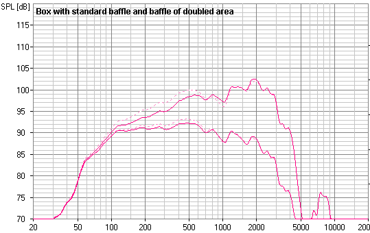

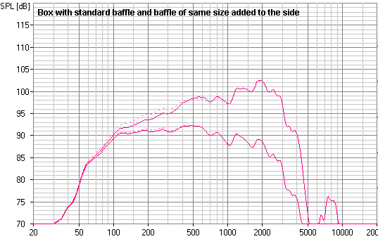

Simply doubling the "baffle area" by positioning a second driver alongside the first will give you up to 1.5 dB. See my simulation in the diagram to the right (stig5.gif). Dotted line is for the added baffle.

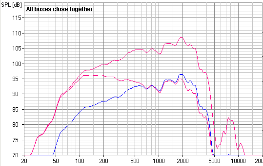

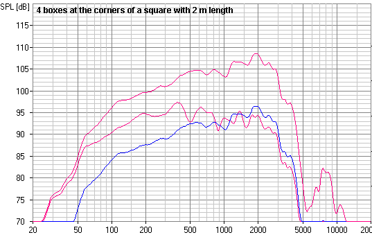

Putting four drivers in a square could give +6dB - with still only one driver working. See how the on-axis response (upper line) is more affected than the power response - which was to be expected.
Another effect caught my attention: I simulated four drivers in the corners of a square with 2 m side length. Upper red line is the combined on-axis response, blue line same for a single driver, lower red line is the power response (second from left Stig3.gif).
(third from left Stig4.gif) is the same, but now with all drivers grouped closely together at 40 cm distance. On-axis response would not change in free space, but the power response would be raised by almost 5 dB at 100 Hz. So it would be a good idea to have those H-frames not too wide apart. 😉

Lastly, we should not confuse the effect of the baffle size on the SPL. It will produce the results the Rudolf indicates, but this is a result of the change in where the baffle related 2Pi tp 4Pi transition occurs, not changes is efficiency of the drivers.
When looking at efficiency it is a simple matter of summing the input power. To keep the radiated SPL of each individual driver constant at the single driver level, the power delivered into the 2 driver system increases by 3dB, the three driver system by 4.77 dB and the 4 driver system by 6 dB. The the efficiency of the 2, 3 and 4 driver system increase by 3, 4.77 and 6dB as well. Or you cam look at it as the two driver system produces the same SPL as the single driver with 3 dB less power. The 3 driver system, the same SPL with 4.77dB less power and the 4 driver system the same SPL with 6dB less power.
