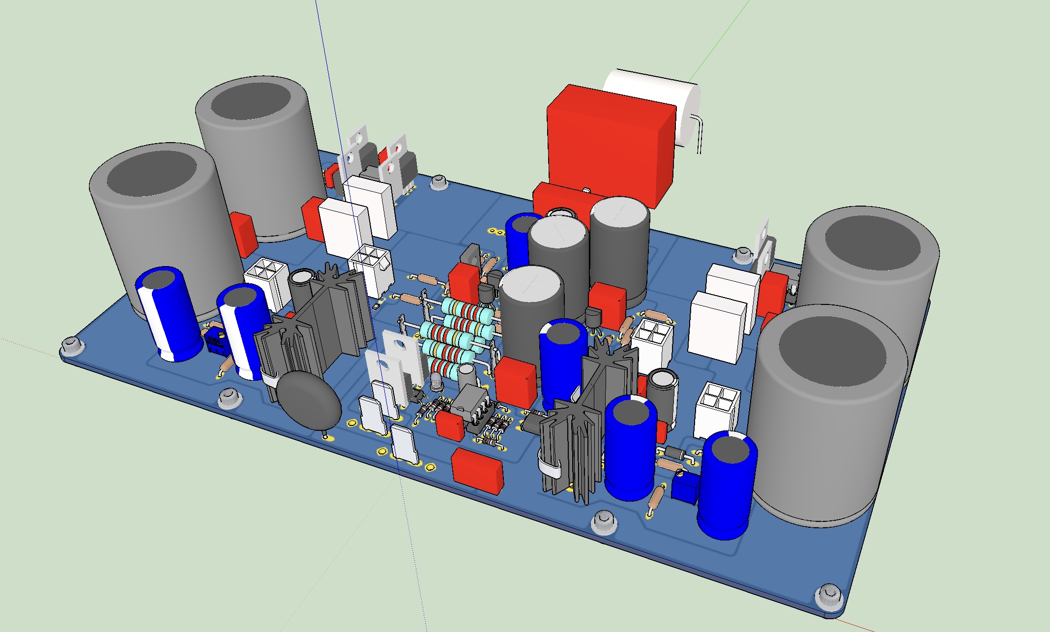

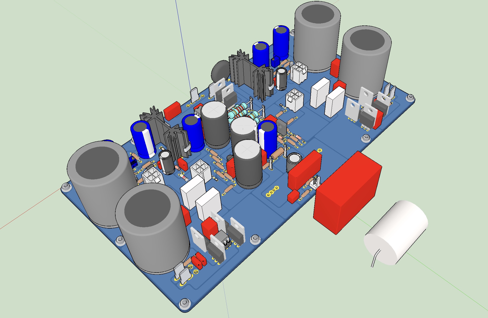

This amp is the evolution of the Alpha BB amp bit combined with the popular Smooth Like Buttah (SLB) active bridge cap multiplier power supply all integrated on board. The amp uses the wonderful Aksa Lender front end with the superb hybrid P channel Aleph output stage. In combining the Alpha BB with the SLB we have essentially simplified one of the most time consuming and difficult aspects of building a Class A amp: making the power supply and connecting it. We have also decided to include a custom solid state relay (SSR) speaker protection and delayed start circuit designed by jhofland. The SSR protection is really new - so testing it on veroboard remains to be done. In the mean time, JPS64 has not wasted any time and has come up with the following layout.
Notable features of the ABBB amplifier:
This is about as close as we can come to a single-board Class A power amp. All that is required is to connect the transformer secondaries (4 spade FASTONs), connect speaker +ve and +ve (2 spade FASTONs), audio input (2pin JST), and chassis GND (1 spade FASTON).
Of course, the 2 TO-264 BJTs for the cap multiplier need to be connected to a heatsink capable of removing about 10W to 15W each. The two TO-264 IXYS MOSFETs need to be connected to suitable heatsink or CPU cooler capable of removing about 100W. Note that many CPU coolers have a large enough pad to accommodate both BJT as. MOSFET size by side. We recommend Noctua PWM fans for silent operation.
The nice thing about mounting the actives to the heatsinks is that they are on flying leads with 4pin polarized Molex connector. So the amp board installation and actives heatsink installation are separate operations. And you can pull the amp board out of the chassis without removing the transistors from their heatsinks! How convenient is that?! We tested this on the SLB ans another one of Hugh’s amps and found that it works superbly. Very convenient.
The addition of an on-board DC protection circuit and power on time delay will help to prevtndameg to the speaker and eliminate turn on thump. It is a small and unobtrusive circuit near the output FASTON terminal.

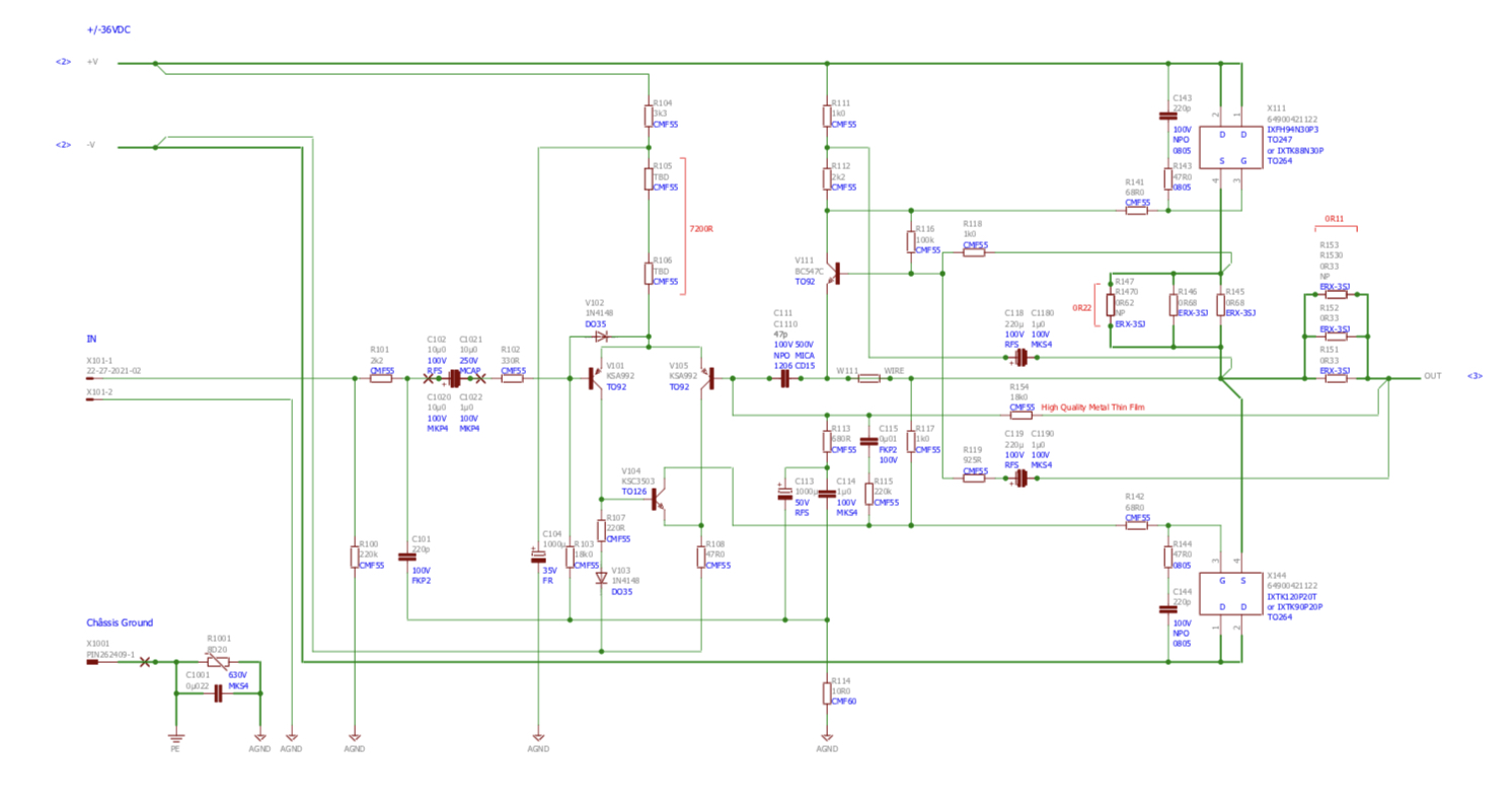

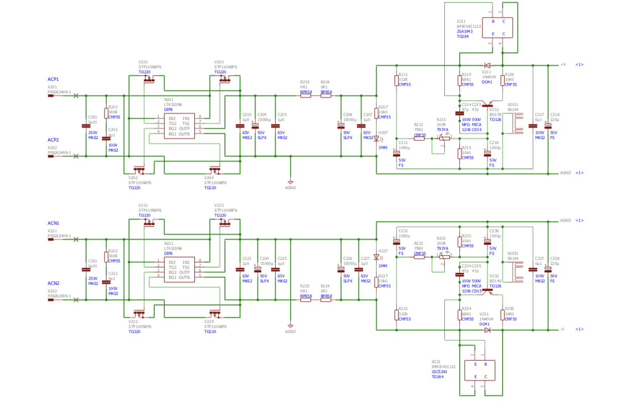

Here are the preliminary schematics:
We still need to test the DC speaker protection circuit - so I will post that schematic once it has been verified to work.
I want to acknowledge the circuit designs by Aksa and Jhofland used in this amp and JPS64’s superb layouts. Without their help - this amp would not be possible.
For now, if anyone is interested, please put your name and number of boards you would like in a list below. Once we have enough critical mass, I will open up a new GB preorder listing on my Etsy shop to collect funds. The Etsy interface should help me with the logistics for efficient GB order fulfillment.

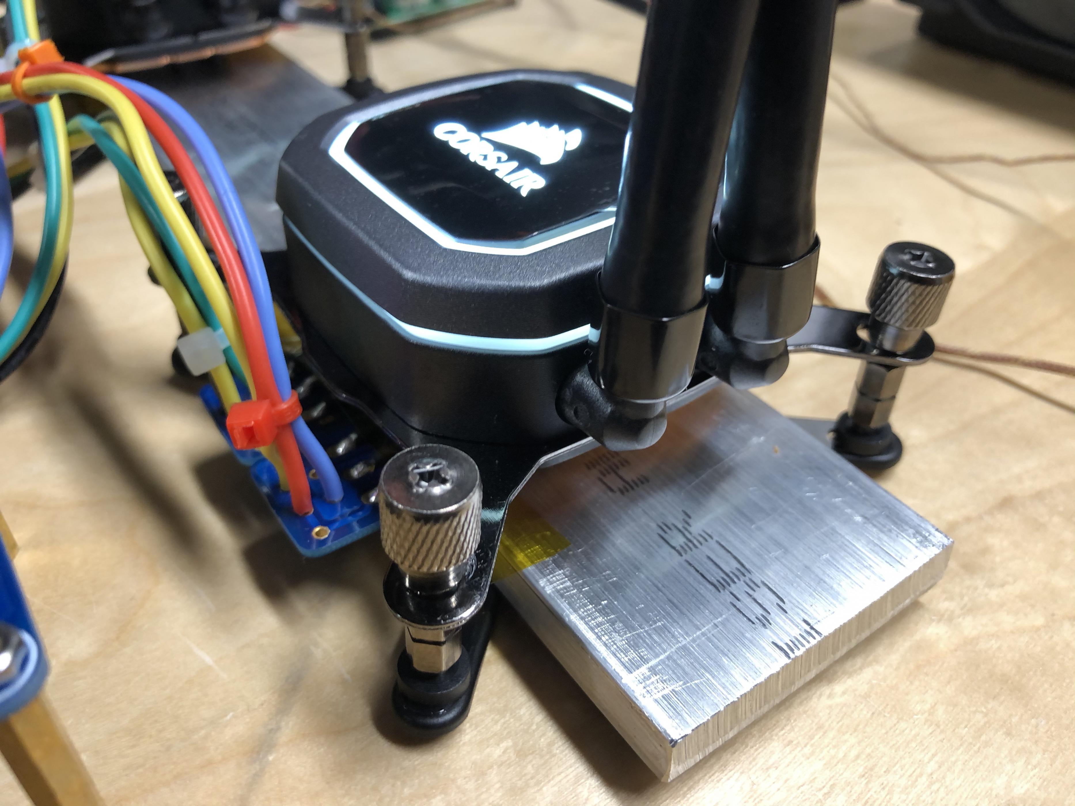

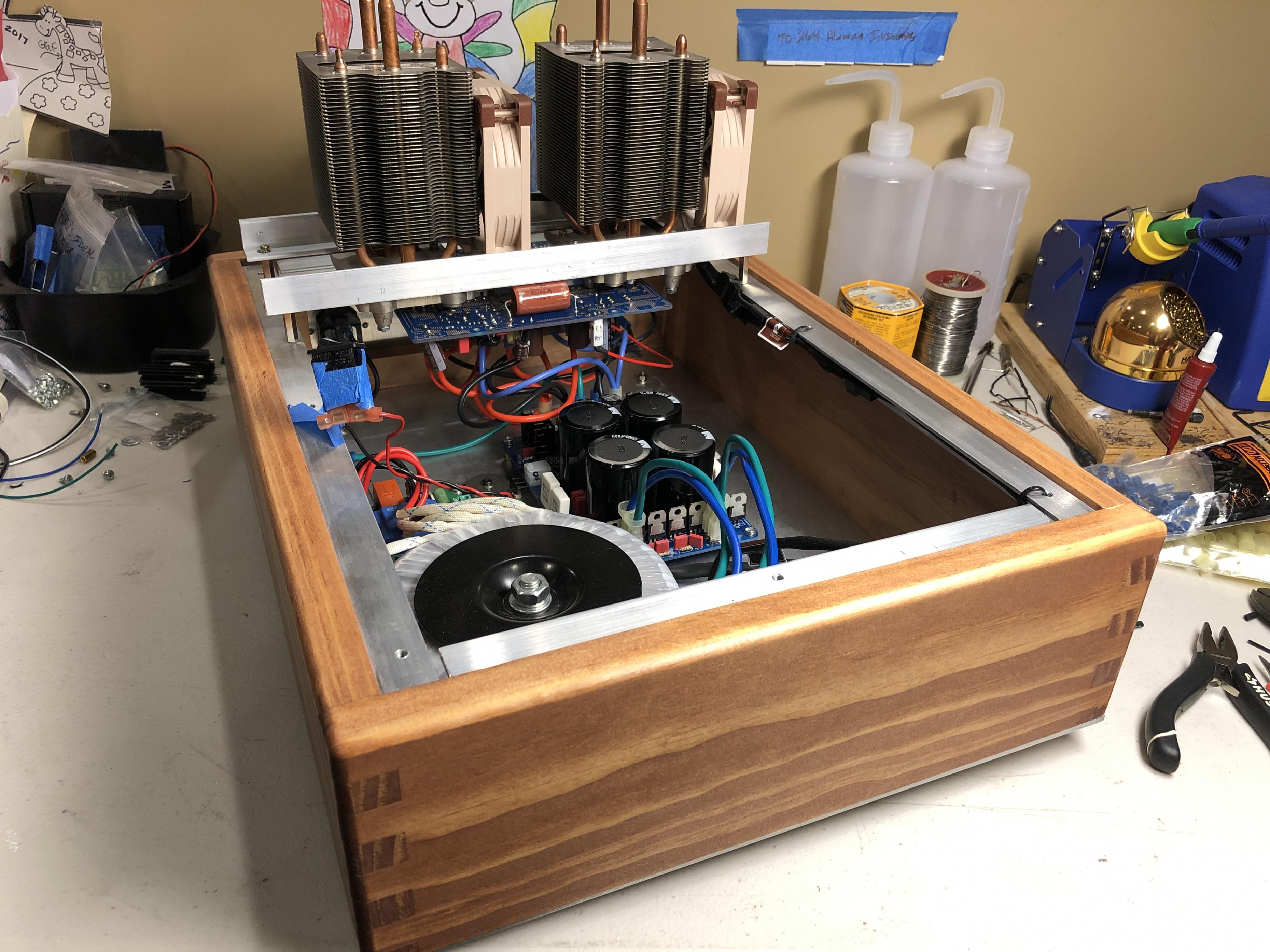

Edit Dec 11, 2019: Gtose finished one channel of his ABBB and he did it with water cooling! It measures superbly and makes 60w!!!

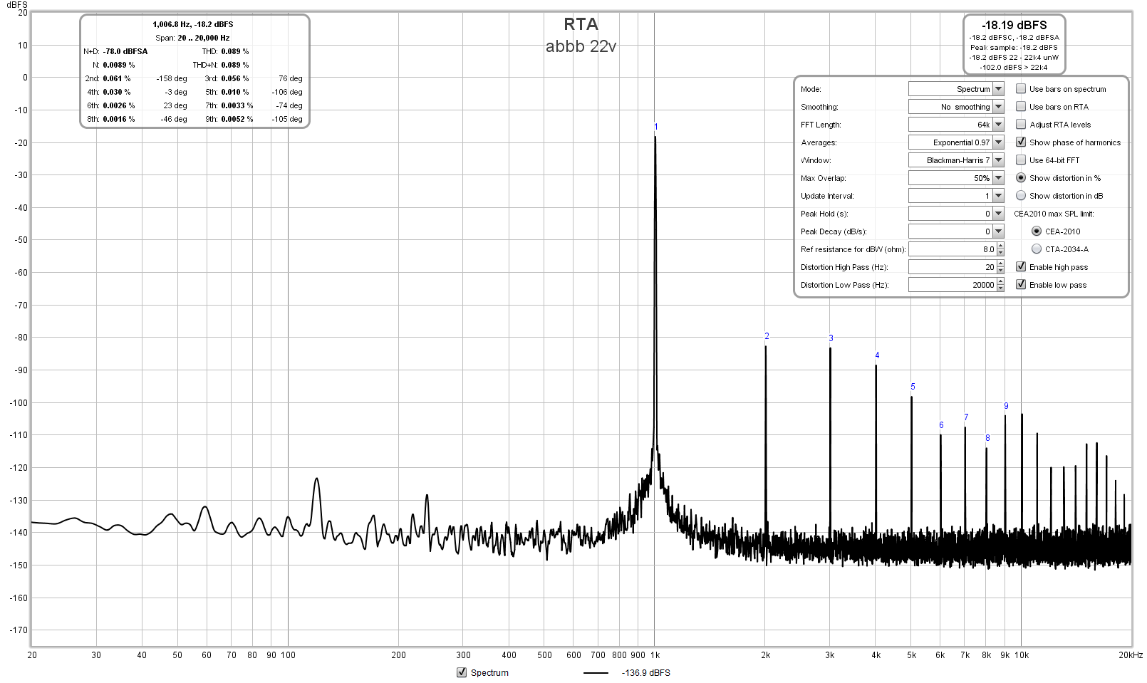

FFT showing 0.089%THD at 60Wrms into 8ohms. Note that this amp's topology is pure Class A - it has no choice but to run in Class A.

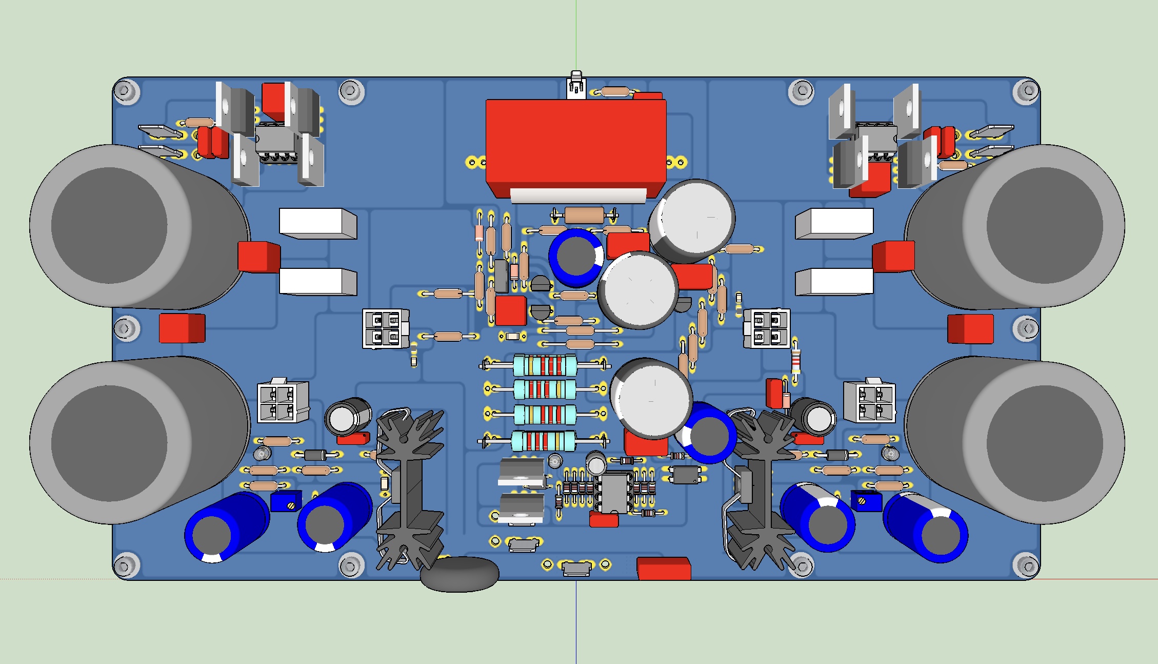

What is the 3rd DIP-8 on the lower middle of the board? I don't see it in the schematic anywhere??? Also, can the KSC3503 be a D for Hfe or do we need to find E's by some miracle?
Jwjarch,
That DIP is a dual comparator which is used to control switch on and DC sense for the speaker. It's not included in the circuit yet.
A 'D' version is not needed. High beta does not define high open loop; you can use any cooking pot KSC3503 here. What is important is Cob and ft, and that transistor is very good.
Magnificent coordination, layout and design to XRK, JPS64 and Jan - this is really stunning work. But to builders, remember that each output, two for each channel, will need forced air cooling using a CPU cooling tower. This will dissipate a lot of heat.........

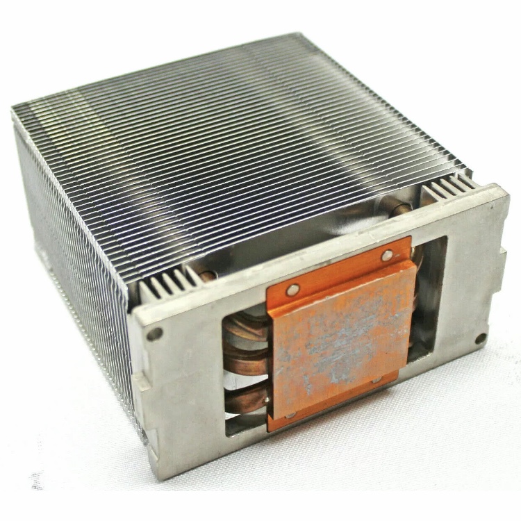

I have 8 of these guys to put to use. I've posted this info on the Alpha thread before, but if anyone needs a cheap cooler here you go. They were made to dissipate at least 130W on Xeon servers and have large copper pads on the bottom. Should be able to handle one mosfet per cooler I would think. Need 4 for an ABBB. I used these to test out my Alpha 20 build and they worked really well.
HP ProLiant CPU Heatsink DL580 DL980 G7 LGA1567 570259-001 591207-001 | eBay

Thanks for the tip on the heatsink - the copper pad looks big enough for both cap Mx and MOSFETs. I just ordered a pair from different seller for $10ea shipping included. Last 2 though.
But this part number looks like a good heatsink for our purposes.

Are these heatsinks suppose to work with a fan?
Asuslover, yes, these are NOT passive heatsinks. They need a constant flow of air. A 92x92mm computer case fan would fit well. Noctua and Arctic have silent fan models and an additional resistor can be added to slow the fan down and make it even quieter. Just be careful not to add too much resistance and stall the fan out.

Can you provide some rough dimensions of the copper pad on the bottom of these? Also, can that be drilled? I assume only a blind hole would work and a thru hole would compromise the heat pipes?
If they cannot be drilled, how to you secure the device to the sink?
