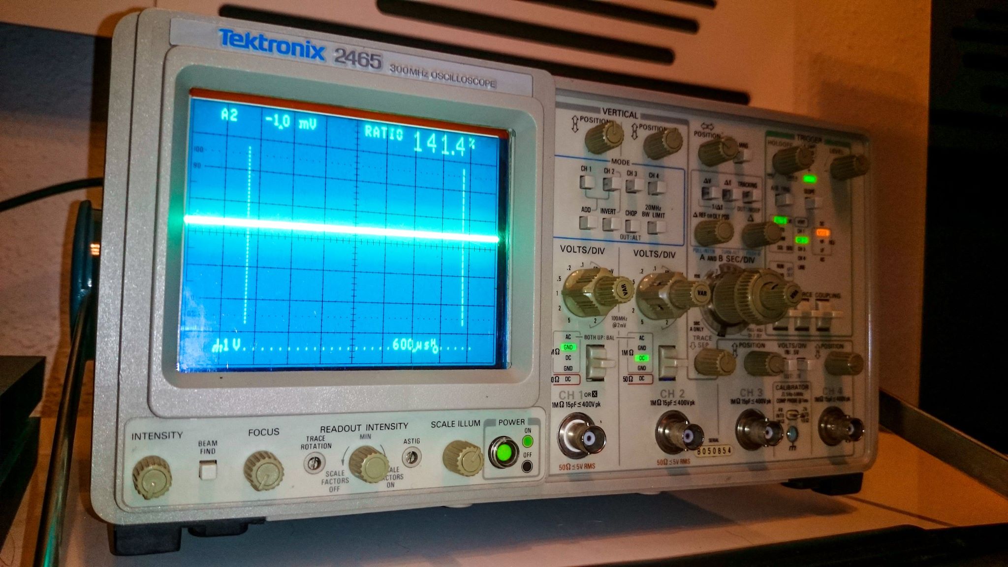

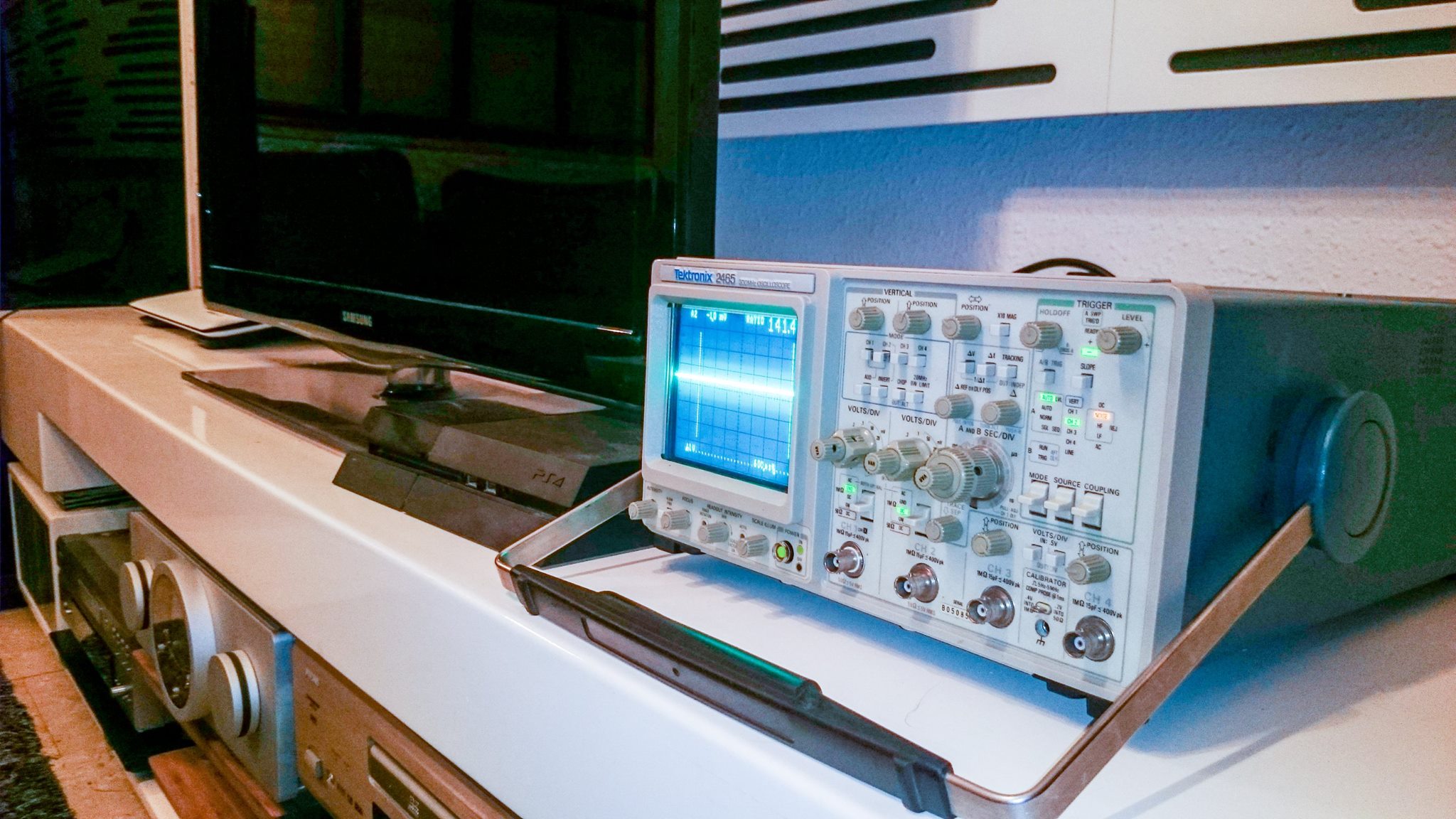

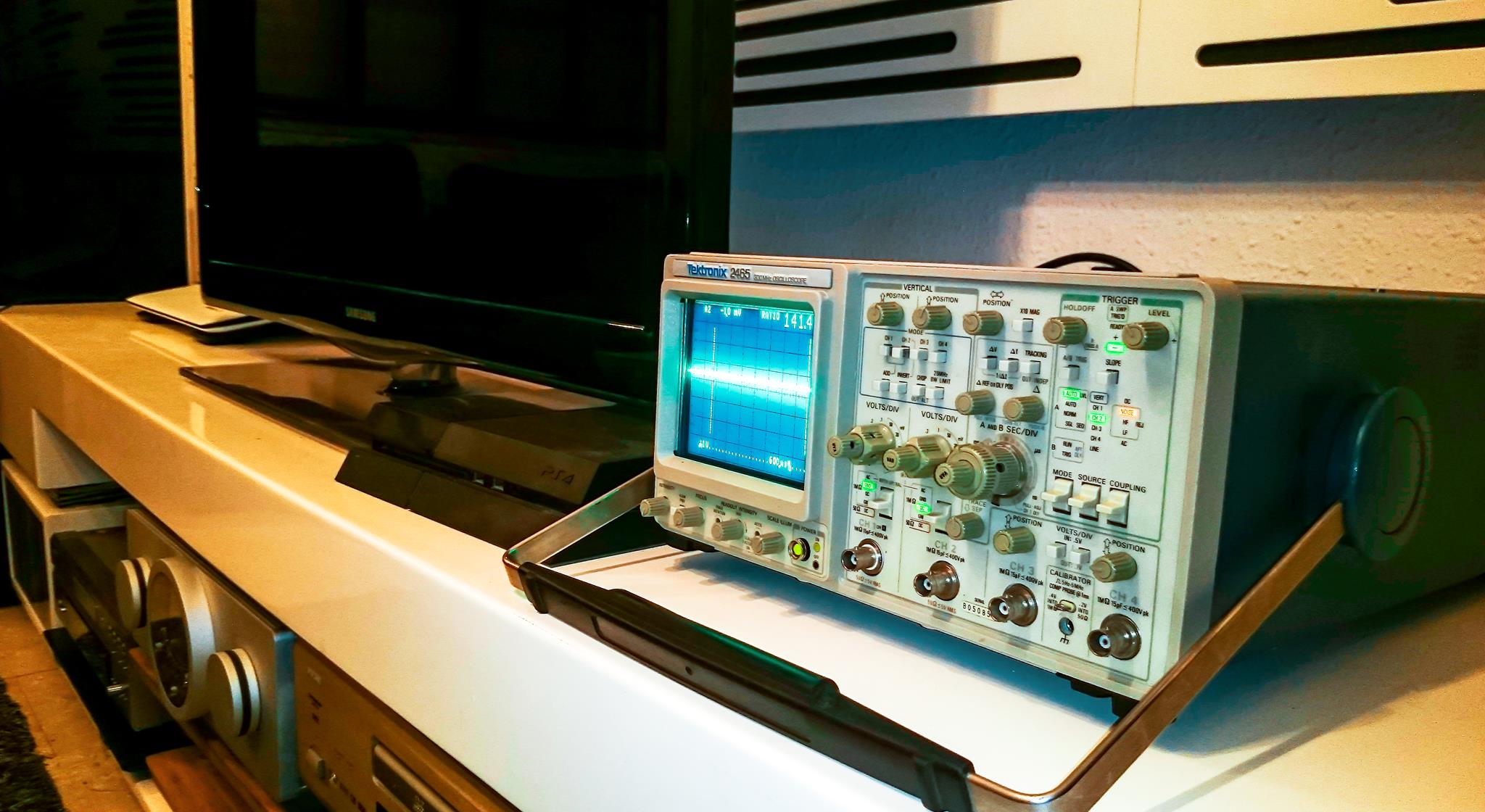

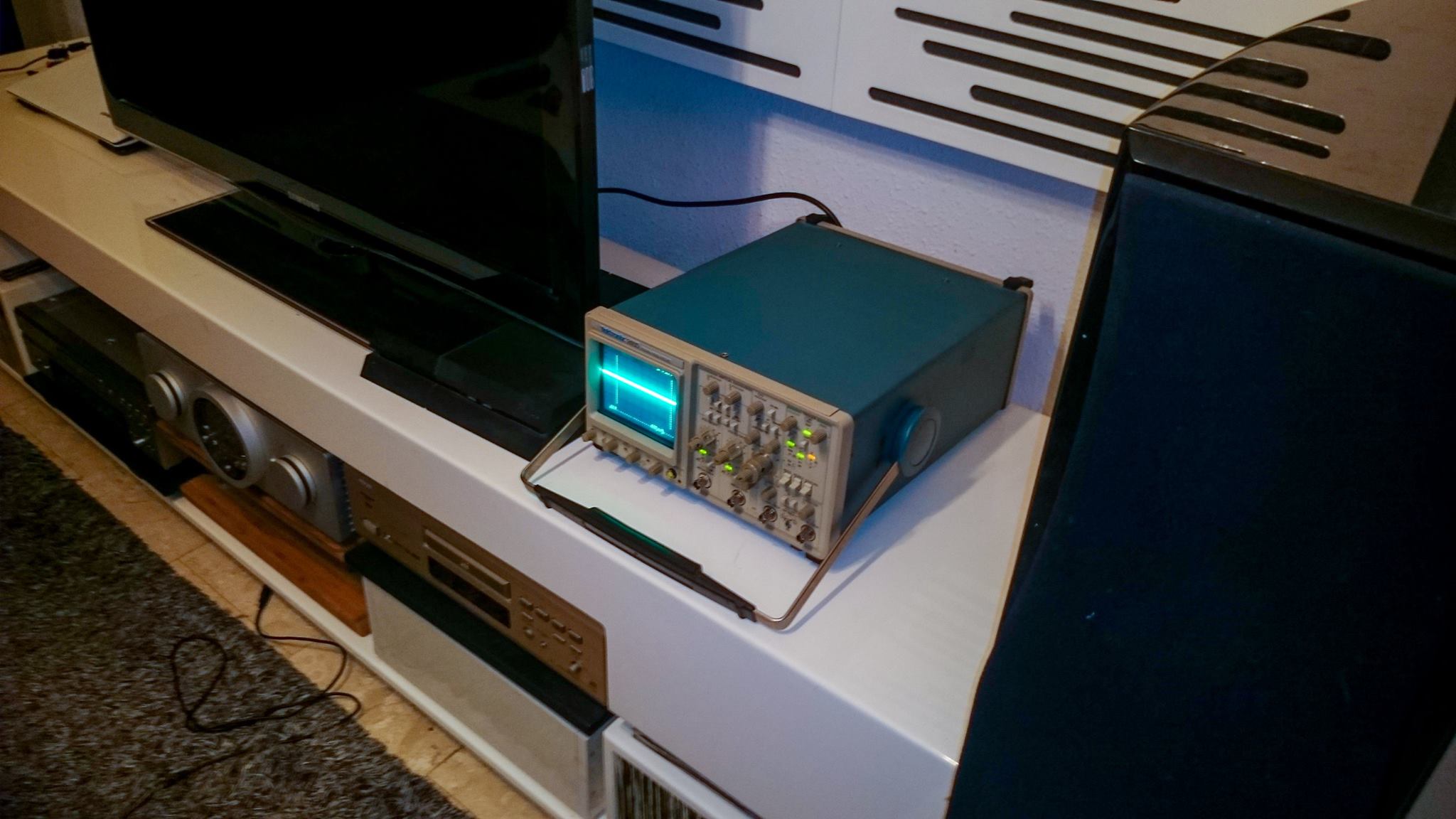

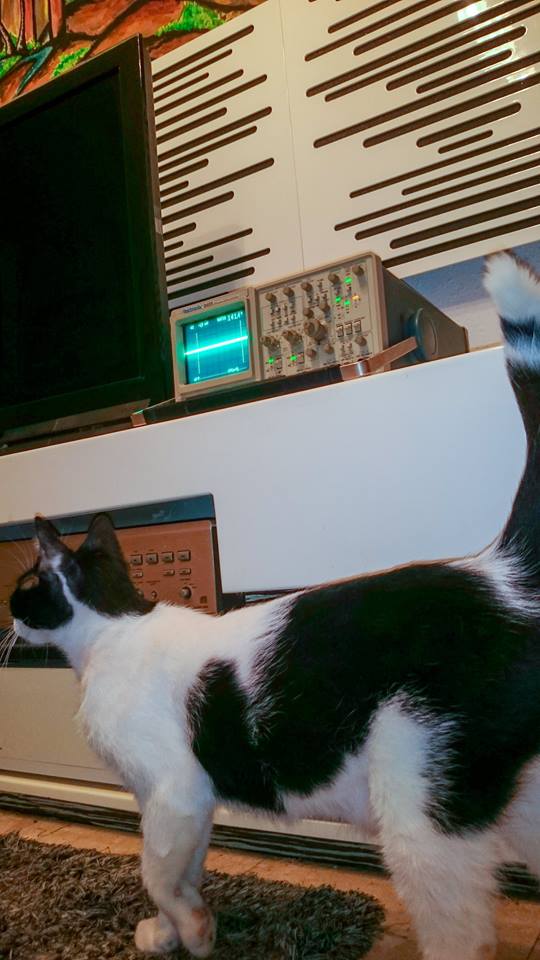

A good friend gave me today the best gift I have ever received
Tektronix 2465 😀
4 ch
300mhz
Recommendation on a good Probes
To complete the set ?
Tektronix 2465 😀
4 ch
300mhz

The 2465 is one of the finest analog scopes ever made. I use mine every day.

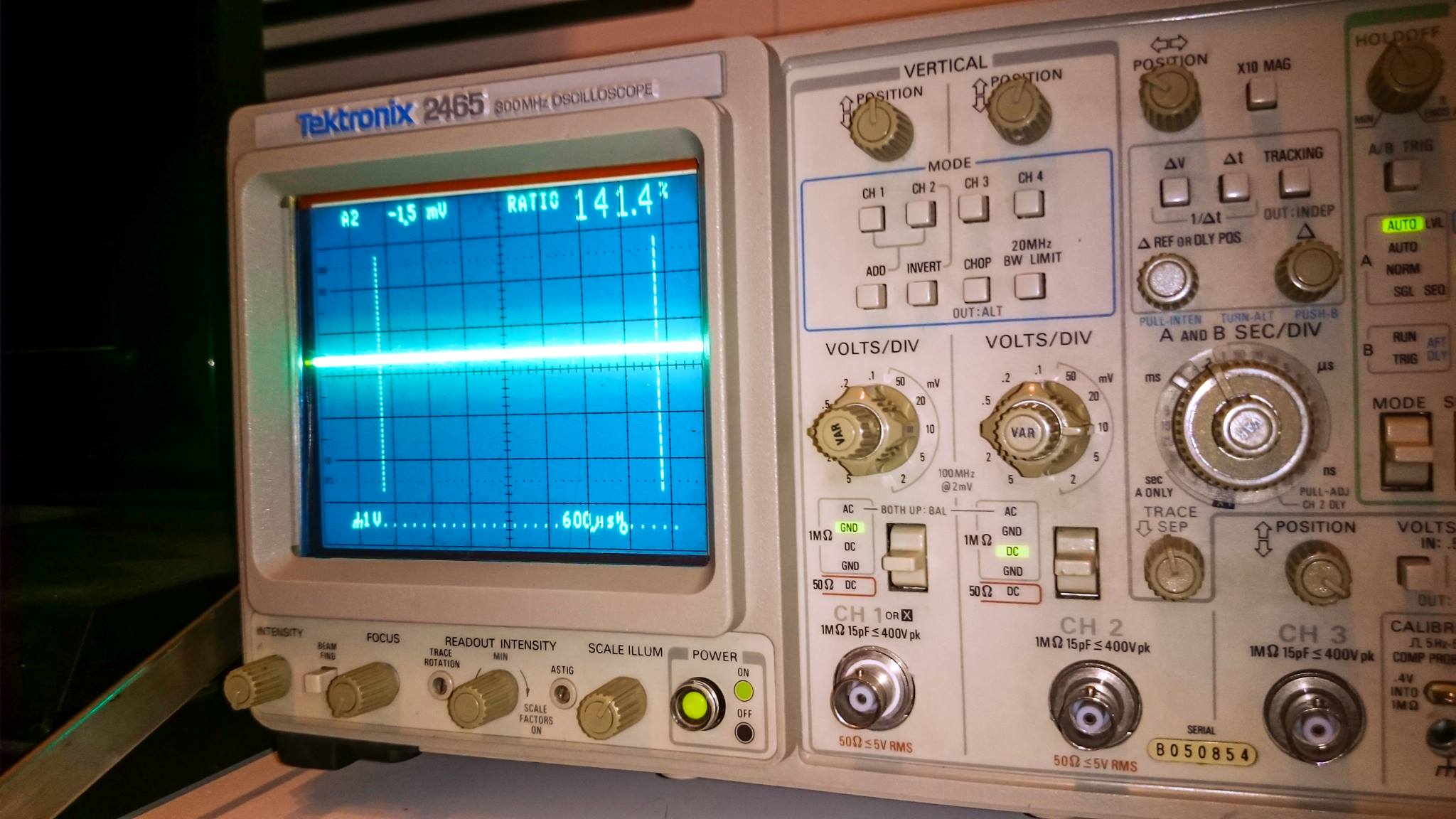

After I buy probe
I'll check it in a comprehensive way.
Especially the condition power supply capacitors.
Scope of the new condition.
He was an Israeli high-tech company as a back up scoop.
And almost not used.
I could not believe when I saw his condition
New new new.
It seems as if just out of the box and placed there

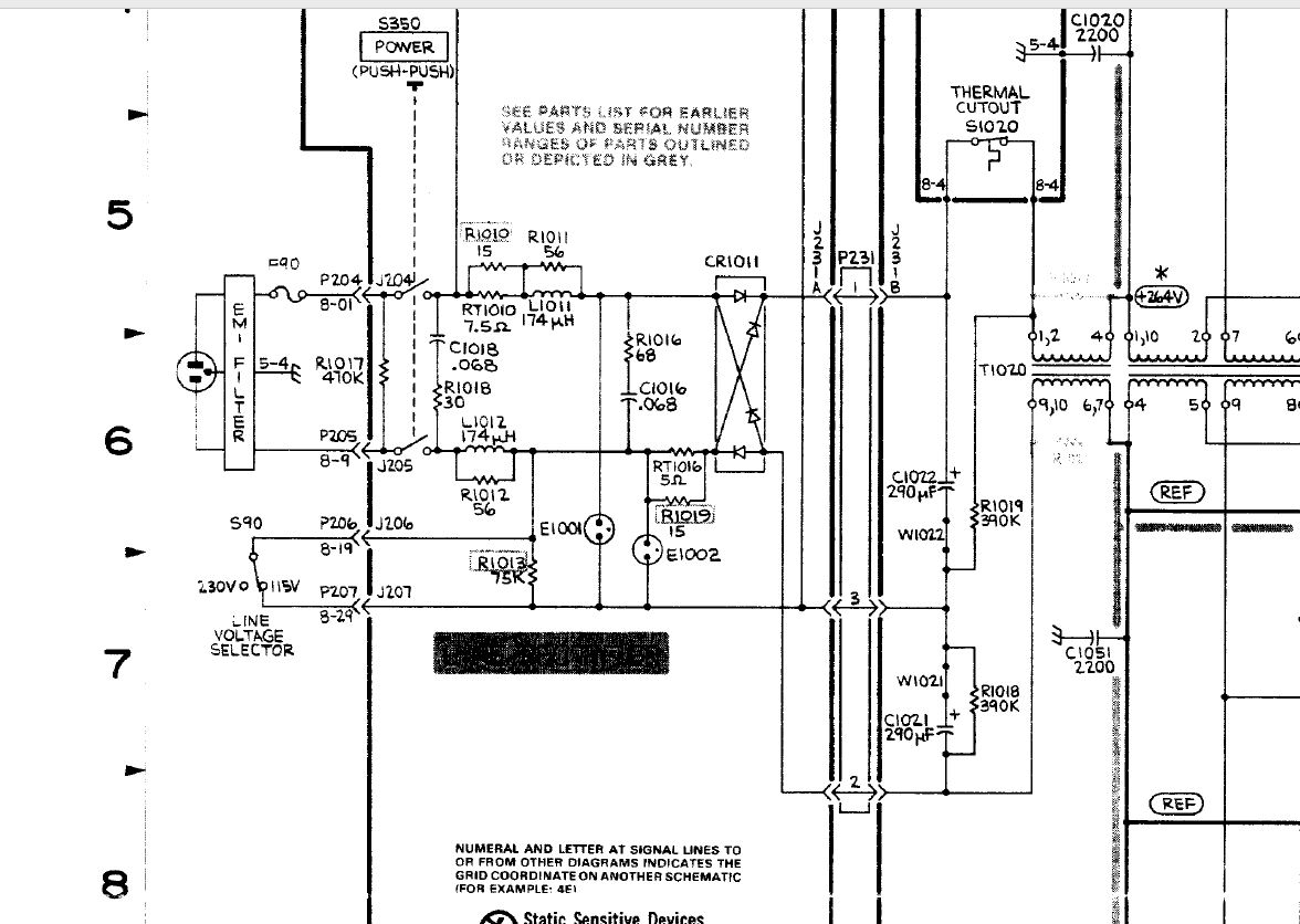

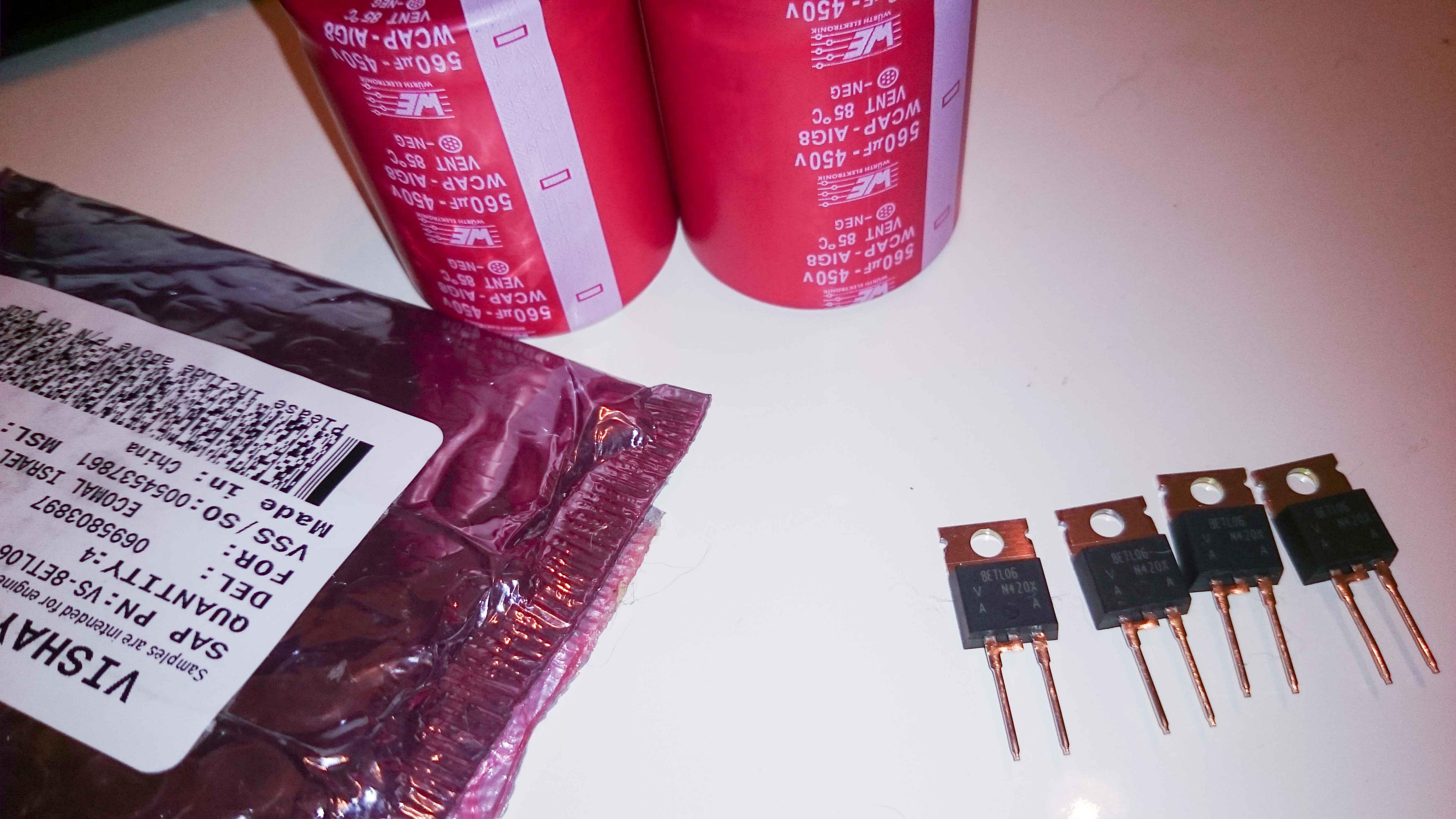

My plan as a security measure to check lll the power supply electrolyte capacitors esr
the Smoothing capacitor 290UF
My experience in the past Switching Power Supplies always I up the value without a problem (of course maintaining the voltage required)
i have Capacitors WE 560UF 450V whether it be a problem to replace the original 290uf to 560UF 450v ?
And second question
two safety x film capacitors 68nf
I have currently in stock 100nf X CAP
So does changing the value of 68nf to 100nf possible ?

I remember when we got our Tek 2467B MCP scope in, big $ at the time, we were all in awe. We could see glitch stuff that no other scope could see at that time.
Make sure you get as high as possible ripple current spec'd ecaps. The 560uF would probably have higher ripple current specs than a lower value, but it is ripple current that counts. Do not cheap out on this component.
I would not bother changing the x caps, why?
For probes, I have P6139A that came with the TDS3054B, of course I recommend them over anything else 🙂
Your cap changes should be fine, as long as they fit. As for probes, original Tek with the scale changing input is the best option. Look on ebay for a reasonable price. Another source is a test equipment rental company. You can usually pick up some used probes for a low price from them.

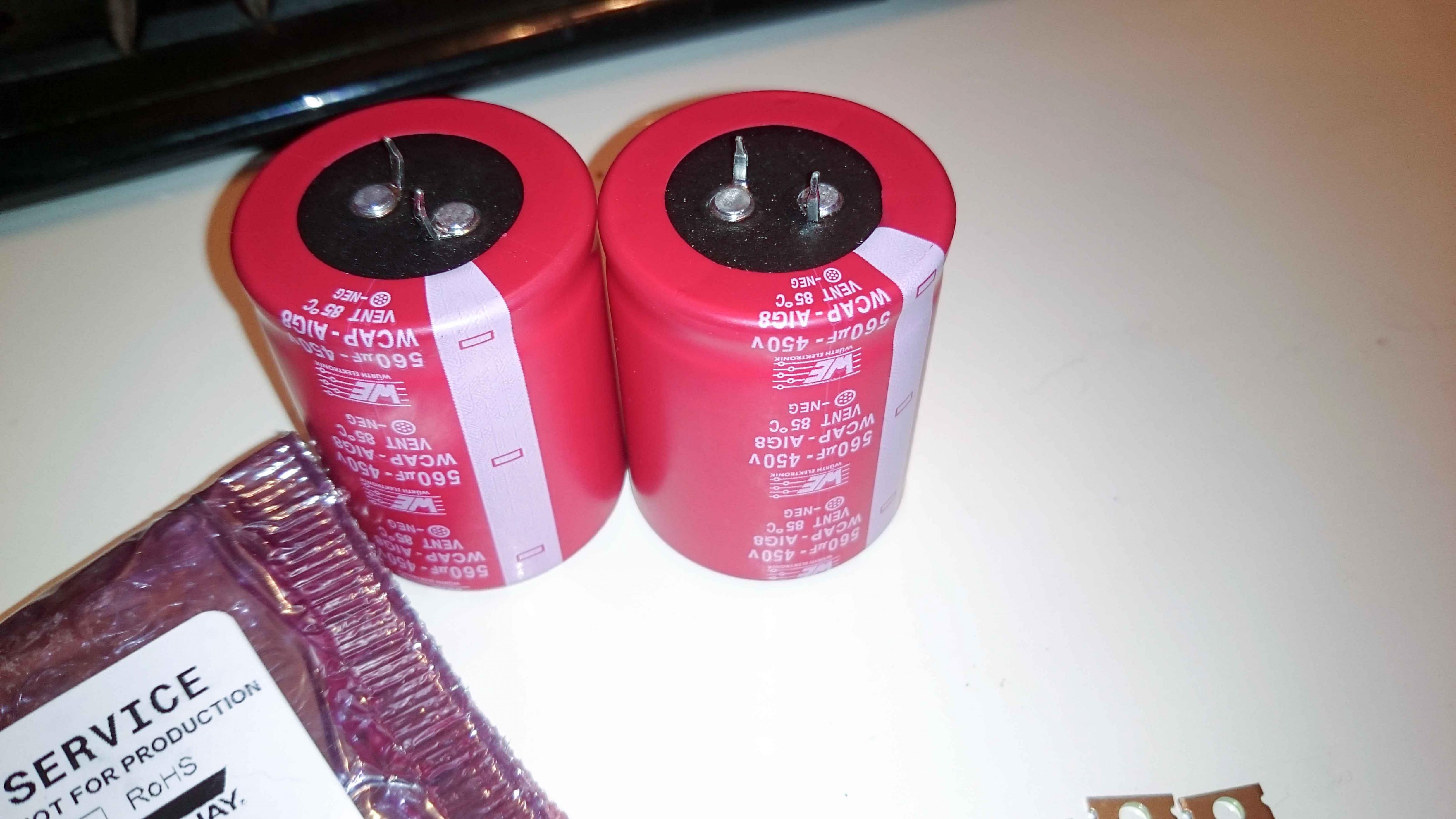

first step
I'll change the smoothing capacitor to Wurth Electronics 560 UF -450v -WCAP-AIL8 ( ESR that I measured 0.09 )
(I hope I fit in diameter 42 mm . Length 47 mm )

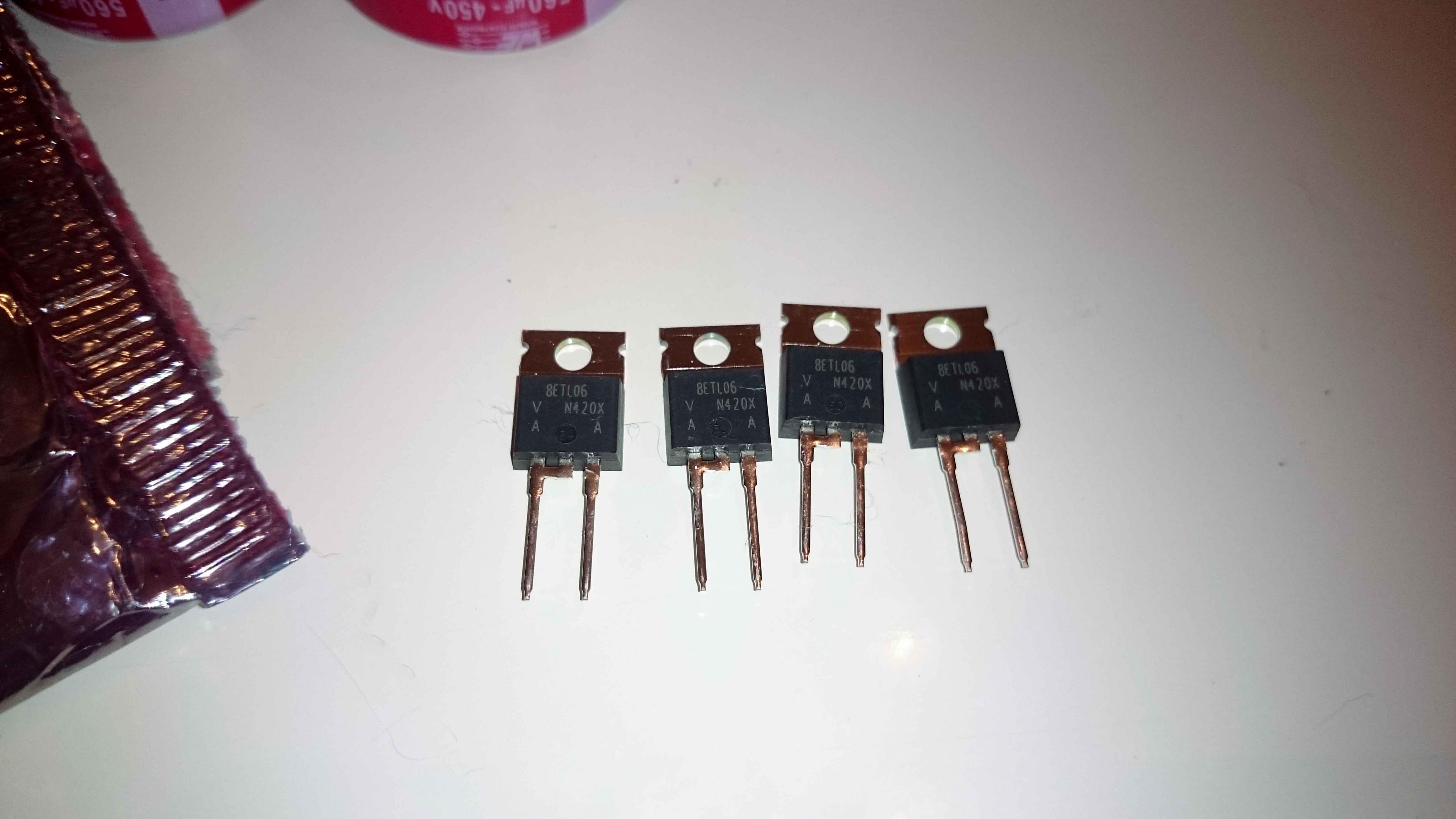

2) In addition the diodes bridge I'll change to diodes of vishay VS-8ETL06-N3 ultralow forward voltage drop.
3) All electrolytic capacitors in the high voltage area I will try to replace the event that I have in stock
4) Voltage Regulators area I would replace the capacitors to solid polymer capacitors

Of course, there are some documented problems with the 24xx series scopes, but keep in mind that Tek sometimes made changes along the way so it is tricky to generalize.
The article by CondorAudio makes some strange statements (like a 100uF coupling cap has to be exactly 100uF for the voltage to be exactly -8 volts). Anyway, it seems like his scope had many problems and was worth some preventative maintenance while repairing it.
Think twice before blindly replacing parts that may not need replacing, or because someone else replaced them, and know what an acceptable ESR should be, while measuring in-circuit.
If you really want to go through a scope and replace parts and improve it, why not get a non-working one and fix it? Mot of the older Tek scopes (e.g., 400 series) are fun to work on, and the parts are easier to get.

I would not change any components with different spec devices. And as said above I would only replace components that were bad.
This is a precision test instrument designed by very competent engineers employed by a highly respected electronics company. It's not some audio amp built to a low cost. Altering component values, especially changing diodes to lower voltage drop is asking for trouble.
Sure any circuit can probably be improved upon. But are you going to invest the time to thoroughly analyze the circuit as designed? That means a university knowledge of analog circuit design!
Don't wreck a good scope by throwing typical audiophile voodoo at it, like bigger caps, "better" caps, faster diodes. This is all for naught!
