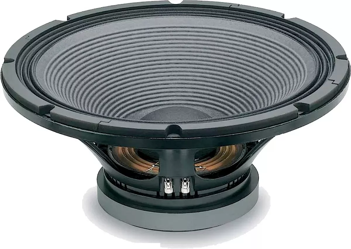

I built a subwoofer, 18 inches, BR, 120 liters, the speaker was designed as a PA subwoofer, Eminence Delta Pro 18 A. Ferrite magnet. Powered with a lot of power and Xover via DSP (Bheringer NX3000D, default cutoff of NXEdit software at 20 Hz)

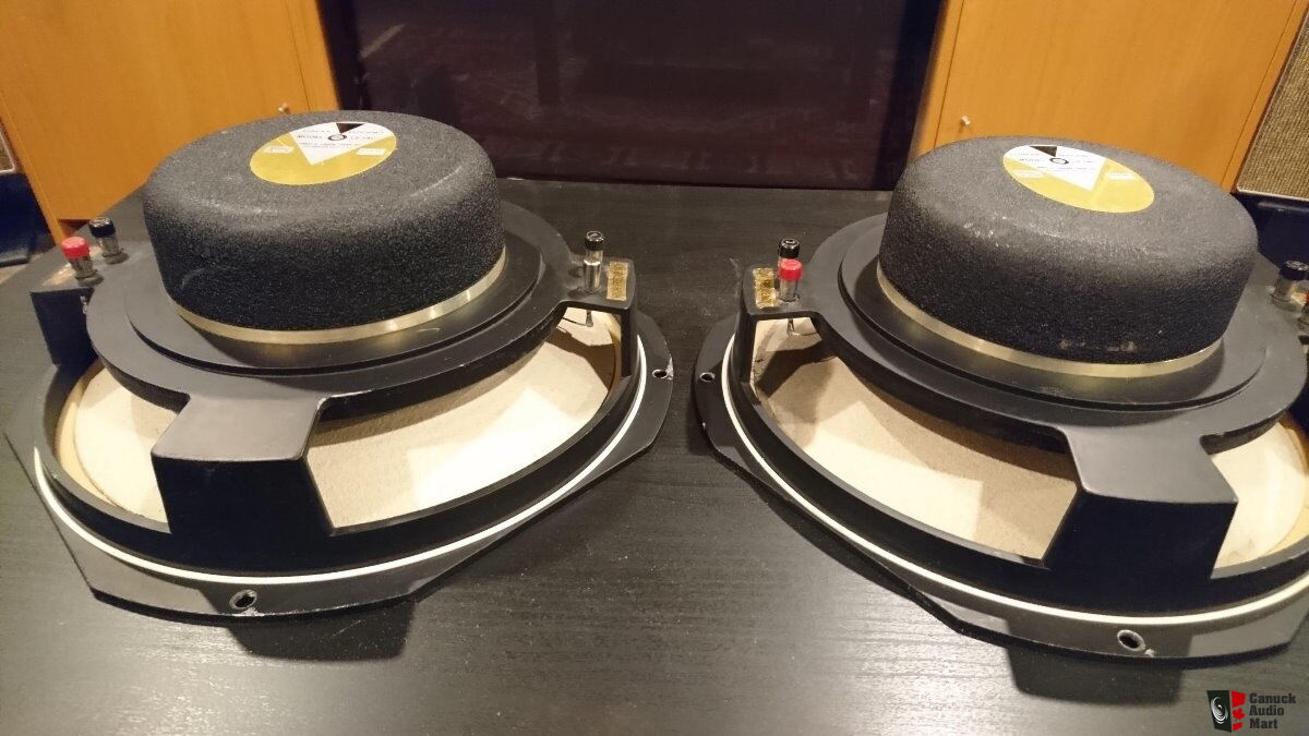

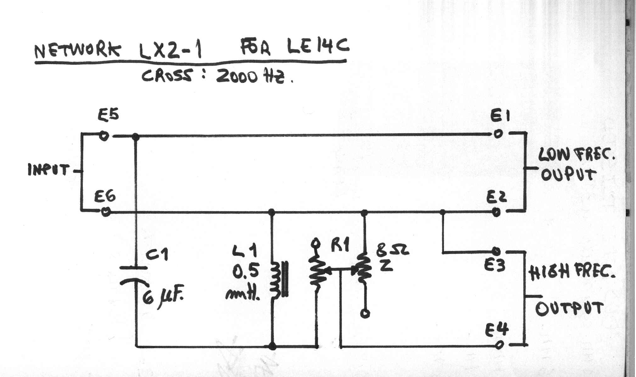

Also many years ago I had built (and I still enjoy it) a vintage JBL, BR, 80 liters, LE14C - it's the same as the LE14A - Alnico magnet. This one has less BL than the Eminence, but believe it or not, I hear that the bass is more natural and deeper. 😳 The xover is the LX-1, a coil and a capacitor to block the bass and protect the tweeter, but the twofer is direct all de power y FR to the VC. That is, the cutoff frequency is limited to the response of the amplifier, a NAD3020.
Obviously, the speakers are in the same room, although not in the same position.
I can provide more data on each of these speakers if necessary .....

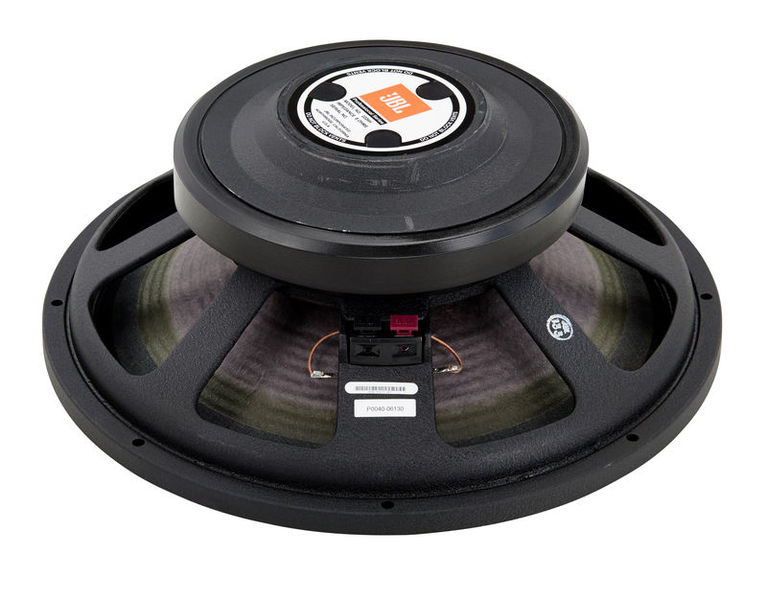

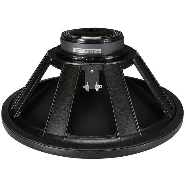

What would be the equivalence between Eminence = 18.9 T-M and JBL = 11000 Gauss? I've been digging around the net and I see that they are very different ways of measuring the intensity of the magnetic field, I can't use 1 Tesla = 10000 Gauss because then Eminence Delta Pro 18 A would have 189000 Gauss! Look at the size of those magnets, yes, I see that one is Ferrite and the other Alnico, but still...
By the way, I forgot to mention that LE14C/LE14A are 14-inch speakers versus 18 of the Eminence 18 A

Thanks for that, the theory is irrefutable, but... so I should deduce that the JBL meets better TS parameters - in general - than the Eminence, despite having a less powerful magnet? Is that so? What about the equivalences? What is the real comparison between both? And I should deduce that for that reason their low frequency reproduction is better? Something doesn't add up, definitely. What about the 20 HZ cut by default in Beringher through the DSP software, as I already mentioned? The JBL is NOT a speaker manufactured as a "subwoofer", the Eminence IS, and yet JBL comes in cleaner "down there" in my sound systems. Look at the crossover network and you will see that it reproduces the entire frequency range it receives from the amplifier, there is a "natural" filter there, the highs are absorbed by the cone, which has a higher Mms than Eminence at first glance, because the cone has corrugations, Aquaplas coating on its back, more sensitive suspension - foam - instead of the fabric/bitumen accordion, etc.
I must say that the VC of those JBL speakers is a classic that is widely copied today. It is 4 inches, the coil turns are concentrated in a smaller space, by using square section wire.
I sense greater reaction to weak currents there. Eminence has a VC of 2.5 inches and with several superimposed layers of common wire (I think there are three, I checked with the manufacturer at the time), it is a beast designed to pull other cars. At a rock show nobody is dedicated to analyzing harmonics, I suppose.

2) I was referring to the fact that Delta Pro 18 A has 18.9 Tm, but they are Tesla Meters, which I see is not the same as Tesla = 10,000 Gauss....but it is no longer important to know which magnet is more powerful given the previous point.

(You can isolate and quote a section like this.) I got my pair of JBL 2226H 15" Fs40hz for $125 (possibly vc replaced considering low price but still very high resolution bass). Pair LE14A would cost $750 with surrounds replaced; here both are abundant. My question is, would the LE14A/C be even better specifically for doublebass? My 12" small alnico vintage Rola(s) and Zenith didn't go that low (on the fundamental) but doublebass still sounded better (with more focused strength) than my smaller stuff.3) I was referring to what I hear as bass reproduction that is NOT "single note", but contains many overtones. I listen to a lot of jazz music, those double basses are my weakness...
What a coincidence !, there is a forum member friend who has two of those JBL 2226H and he can't decide whether to use them... I'd bet they deliver better bass ! 😊

I already mentioned how the LX2-1 crossover network that I attached allows the signal to pass through cleanly. No coils there to block mids and highs, let them pass, they will die mechanically there, the ribs of the cone end a few centimeters before reaching the VC to favor the reproduction of mids. It is a coaxial. And yes, I love it, it was a wedding gift from my wife's aunt who brought - from the USA to Argentina - two of these beasts in her suitcases to look good with her niece... When she met me she said: "Kid, you could have chosen something smaller"
