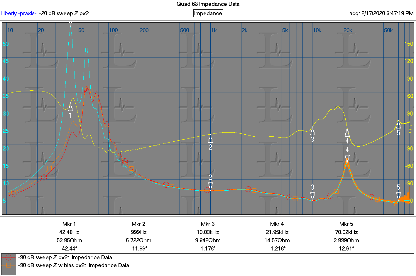

Quad 63 impedance measurements
Here are several superimposed impedance plots.
The taller one is at a 10 db higher drive level. the lower drive level plots are with bias on and bias off. I could only turn up the AC to about 40% before the discharge internally became excessive. As such the clamp circuit was not powered and shutting everything down at any higher drive level.
I think the drive levels are around 10V and 3V. The annoying ticking from the bad panel persuaded me to stop pretty quickly.
There really is no difference bias on and bias off. There is some difference related to drive level in the LF resonance.
This speaker is too sick to do much more testing until the dead panel is replaced.
