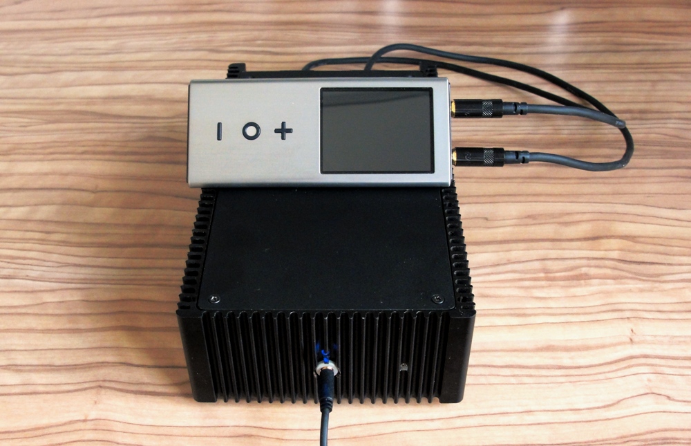

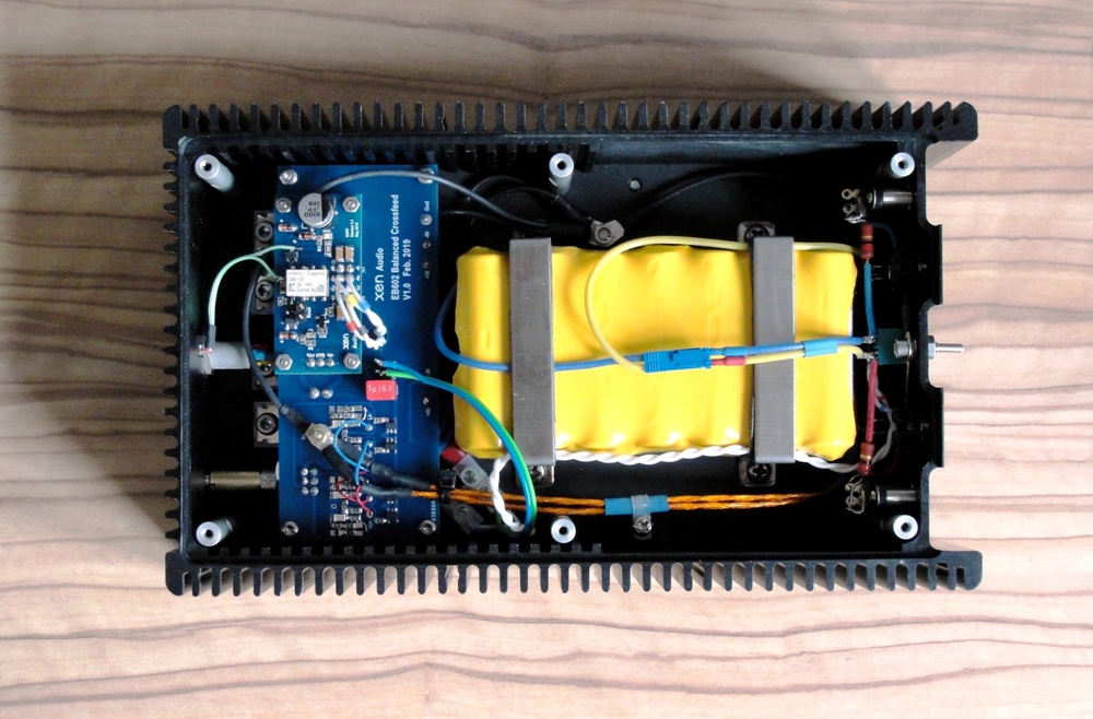

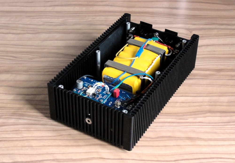

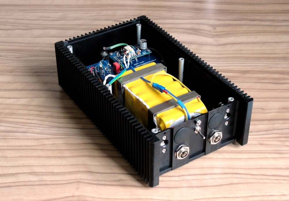

Independent Audition
As you can see the project has been finished for a while.
So we had the chance to have it gone through thorough auditioning in Germany.
"Powered by normal regulators, the initial impression was that the EB602 is very capable and transforms everything coming from the source into music at a very high level,
a very good amplifier that sounds very dynamic with very good control over the entire spectrum.
Detail, dynamics, space... it's all there. But presentation in general is a touch harder when compared to the DAO SE. "
But we discovered a comment in Ref.1 that reads :
"When I used an AC regulated supply (Linear Tech. LT317), the sound became harder, with more edge, and lost some of the smoothness in the high frequencies.
Low end was always very tight and extended with both supplies.
I must conclude that the battery PSU makes an audible difference and was well worth the time and cost."
So we repeated the audition again using 40x AA alkaline batteries as power supply.
“Indeed the Borbely didn't have the slightly hard side that I heard with the lab supply... in fact it sounded pretty convincing! “

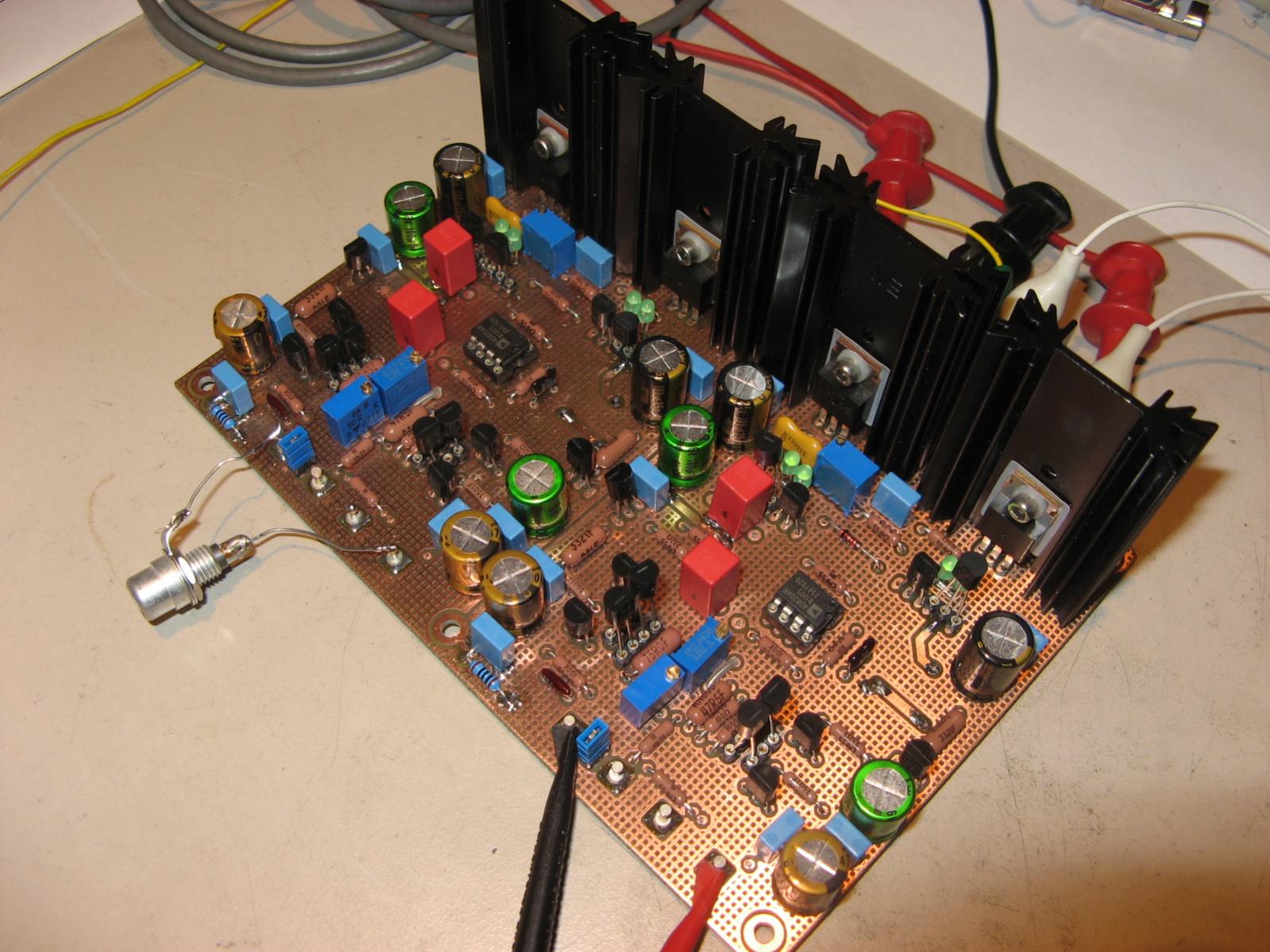

PMOS as Current Source
Apparently the PMOS of the Hitachi laterals are somewhat easier to find than the NMOS.
In theory there is no reason why the NMOS CCS cannot be replaced by a PMOS one.
And while doing that, one can modify the CCS into a modulated current source (MCS).
It is important to stress that while the MCS improves current driving capability and hence lowers distortion, it changes the distortion spectrum of the amplifier.
And this cannot be considered to have the same character of the original.
We have not built this, but decide to include it here for the interest of technical discussions.

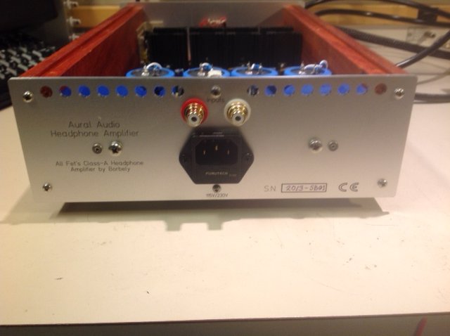

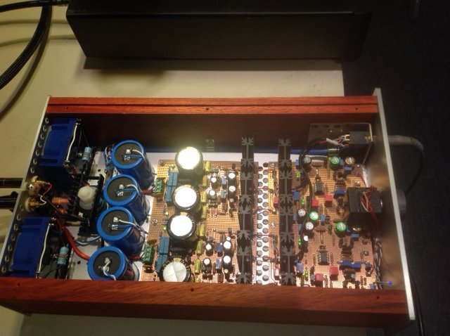

I built the original Borbely Headphone amp a fiew years back, with an Audial look. Full dual mono design, with CRC pre-filtering and all discrete Borbely regulators. I made all the pcb by myself... Glad to see that EUVL had a close look at it.
