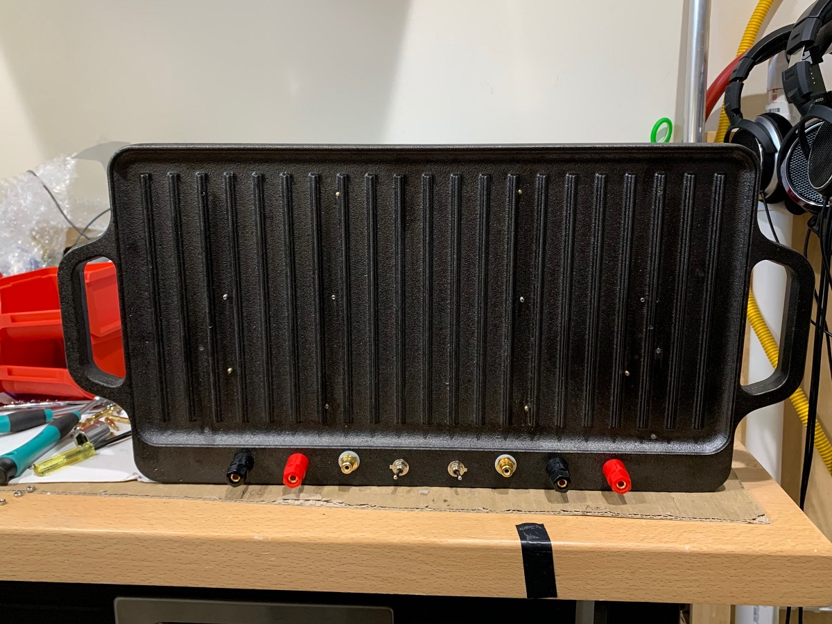

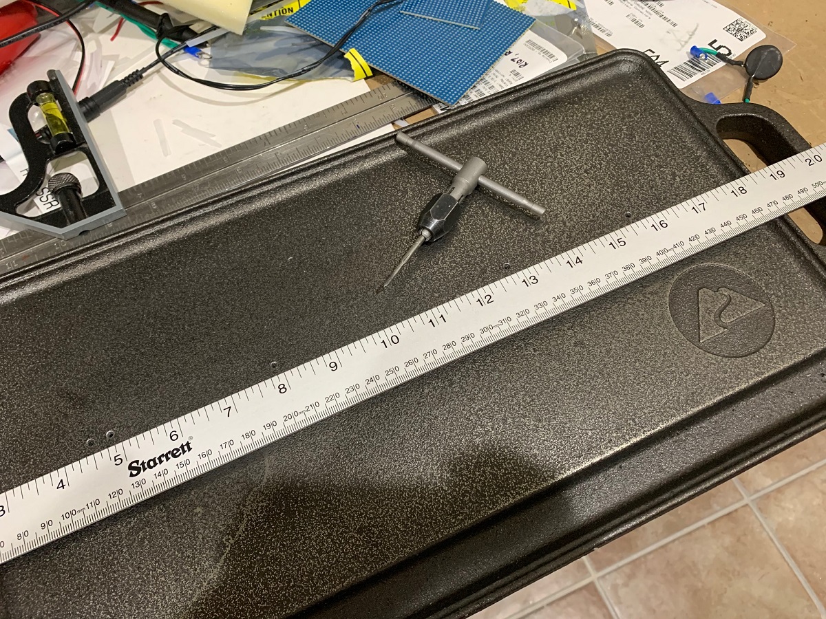

I had to do a little bit of sanding to get the surface smoother and more likely to transfer heat better. The drill and tap 4-40 or M3 tapped holes where you want to put the MOSFETs (I spaced them out evenly). Cast iron is very soft and drill and tap operation is like butter:

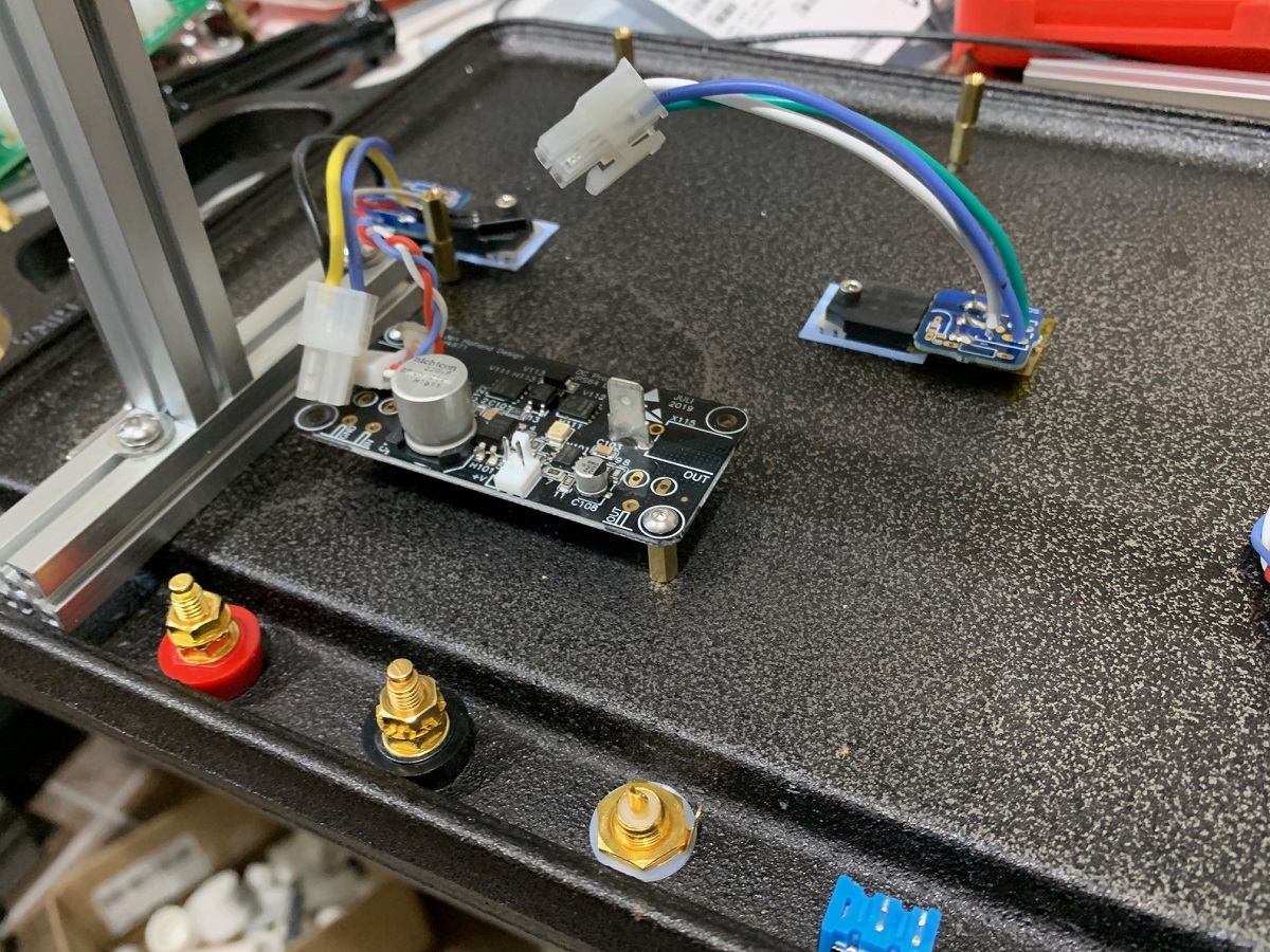

Here is a MOSFET mounted with a ceramic spacer (thermal paste will be required):

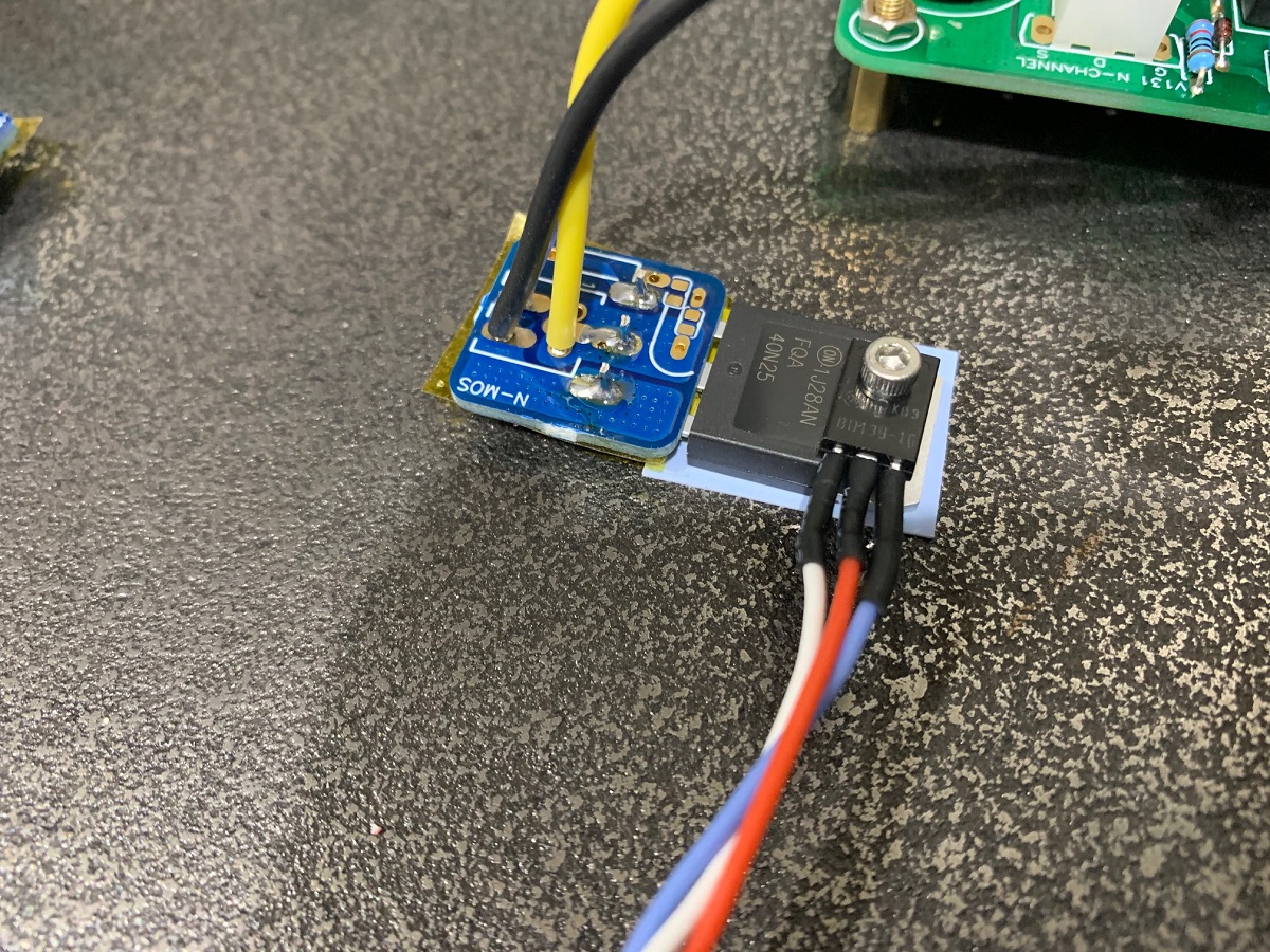

For the FH9HVX, I decided to use silicone insulators since the heat load was not that great and I think the silicone will conform to the texture of the cast iron better:

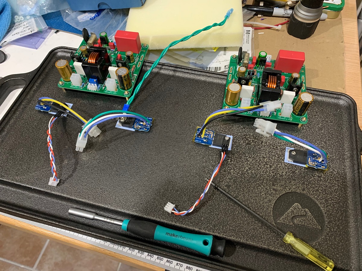

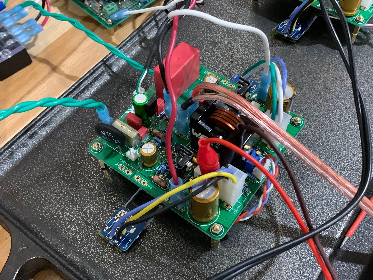

I am using little helper "snubber" boards to allow remote mounting of the MOSFETs which really simplifies the installation of the amp. The boards have built-in RC "snubbers" in case we run into oscillation issues. The snubber boards help to reduce the mechanical stress on the pins and the wires. I use ultrasoft silicone insulation, supple and soft high strand count RC race car wires for the wiring harnesses between the MOSFETs and the PCB. We used Molex Minifit Jr locking connectors for the MOSFETs. This lets me remove an amp in under 2 minutes. Thi s is the N-ch with a Vbe multiplier temp compensation sensor:

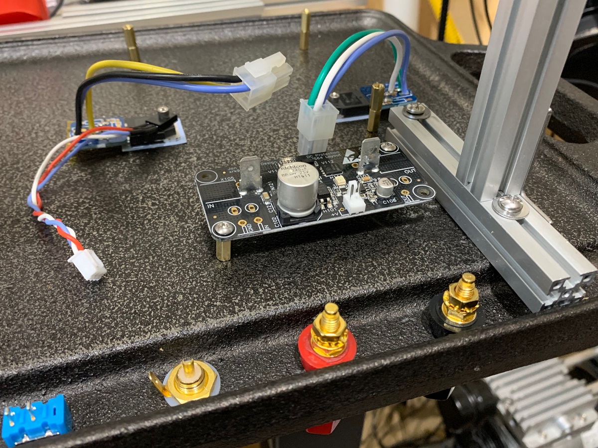

Here is the P-channel mounting:

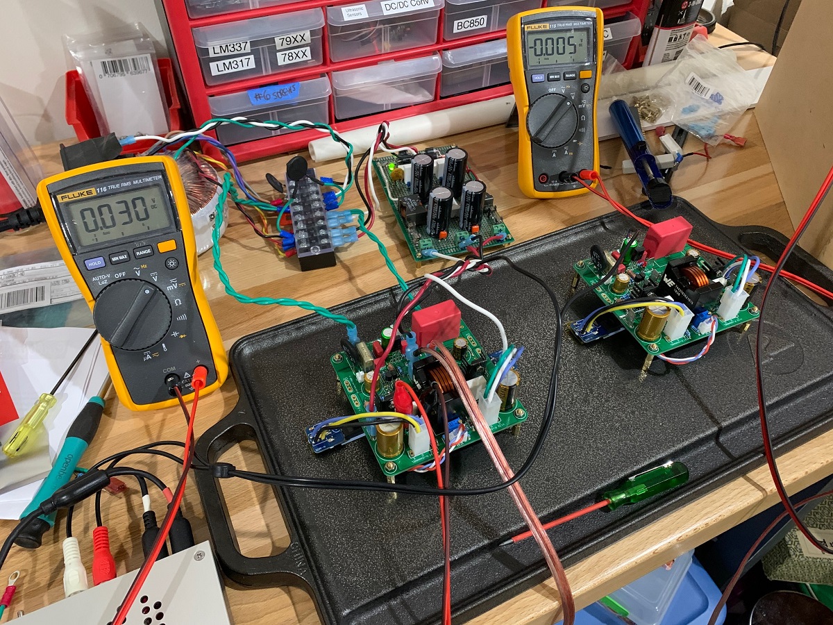

Here is the amp being tested using the griddle:

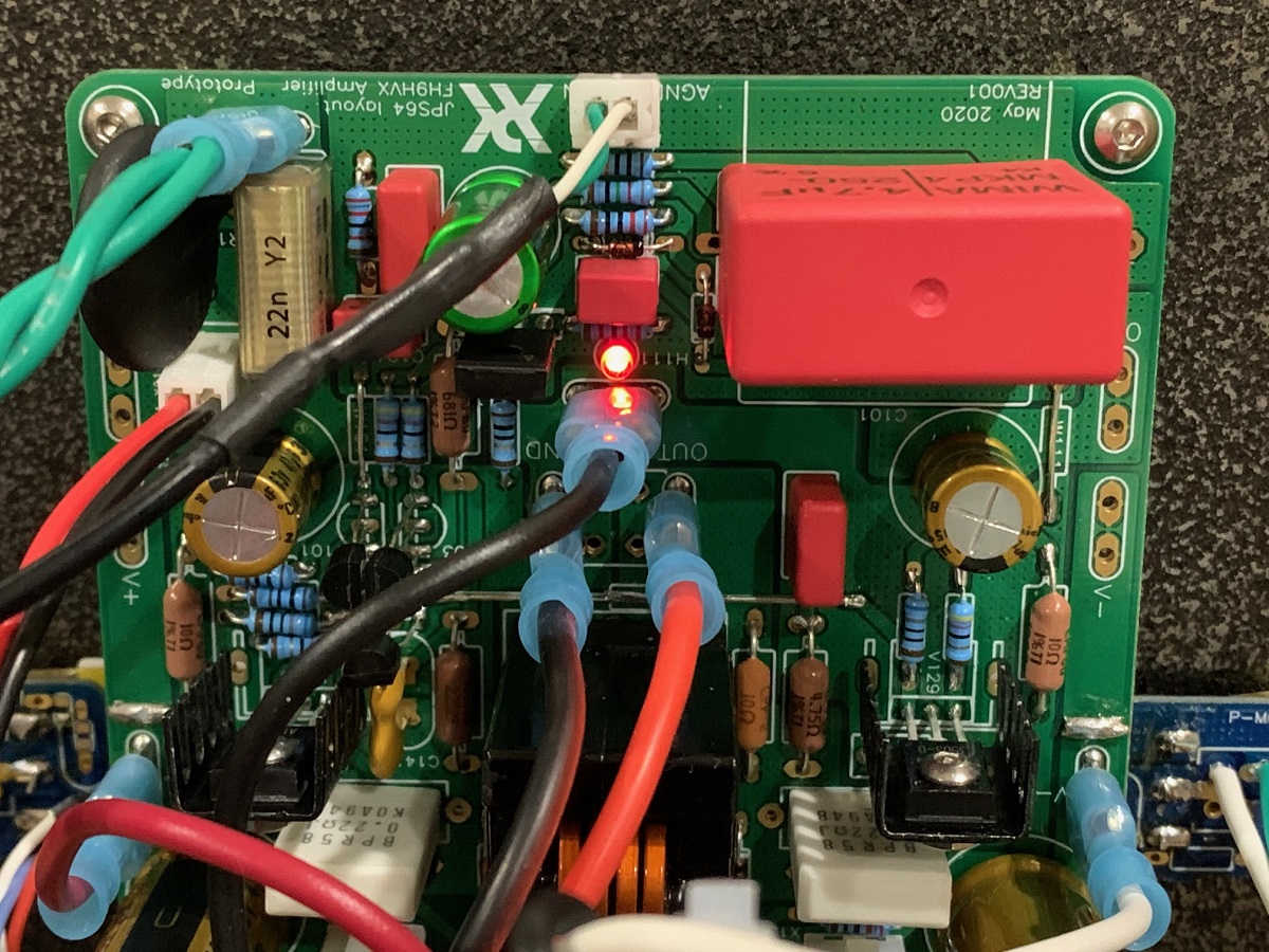

Here is the first sound of the FH9HVX amp - all went smoothly and the amp sounds great. The amp is running +/-35v at present and 150mA current. Playing music at normal listening levels, the griddle is about 39C near the MOSFET and barely warm 5 inches away. MOSFET body temp is about 52C.

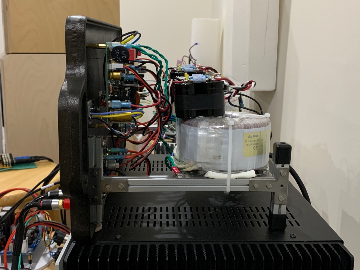

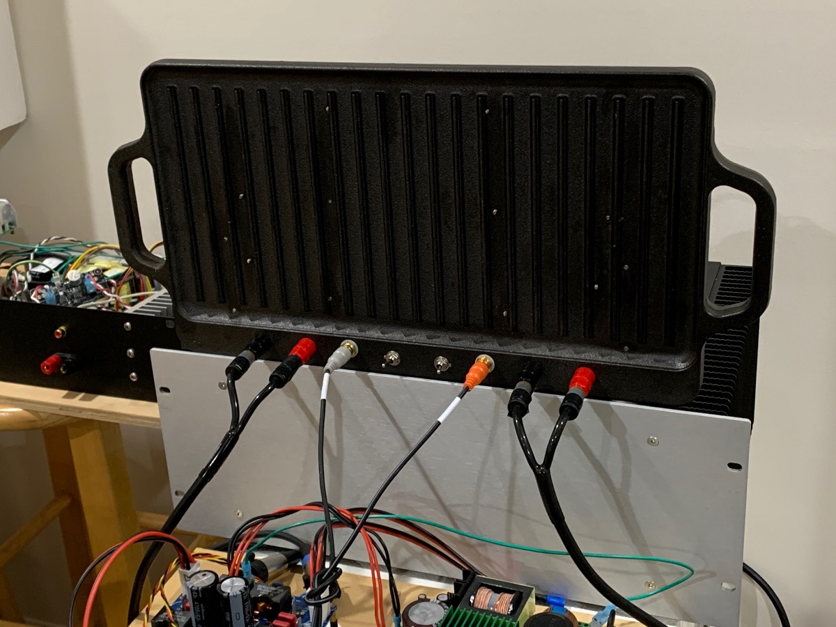

So far this is working out real well. I will install RCA jacks and binding posts for speaker out in the horizontal "grease well" as it provides a flat bulkhead. I will install a MakerBeam frame on the back for the trafos and PSU's, and the griddle will sit up vertically rather than flat and horizontal. That should help the natural convection cooling somewhat. It mught be fun to try this on a Class A like the Alpha Nirvana.

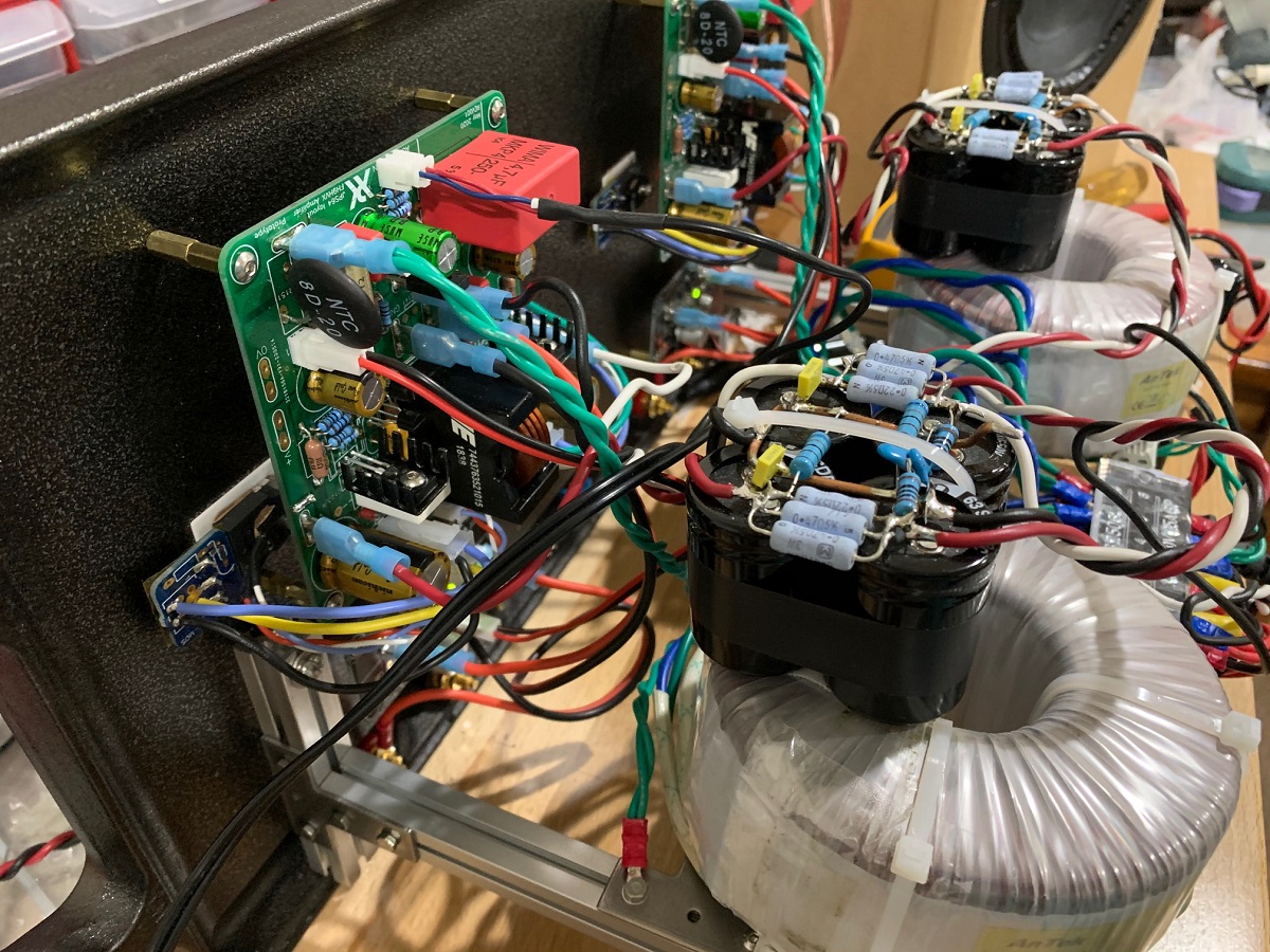

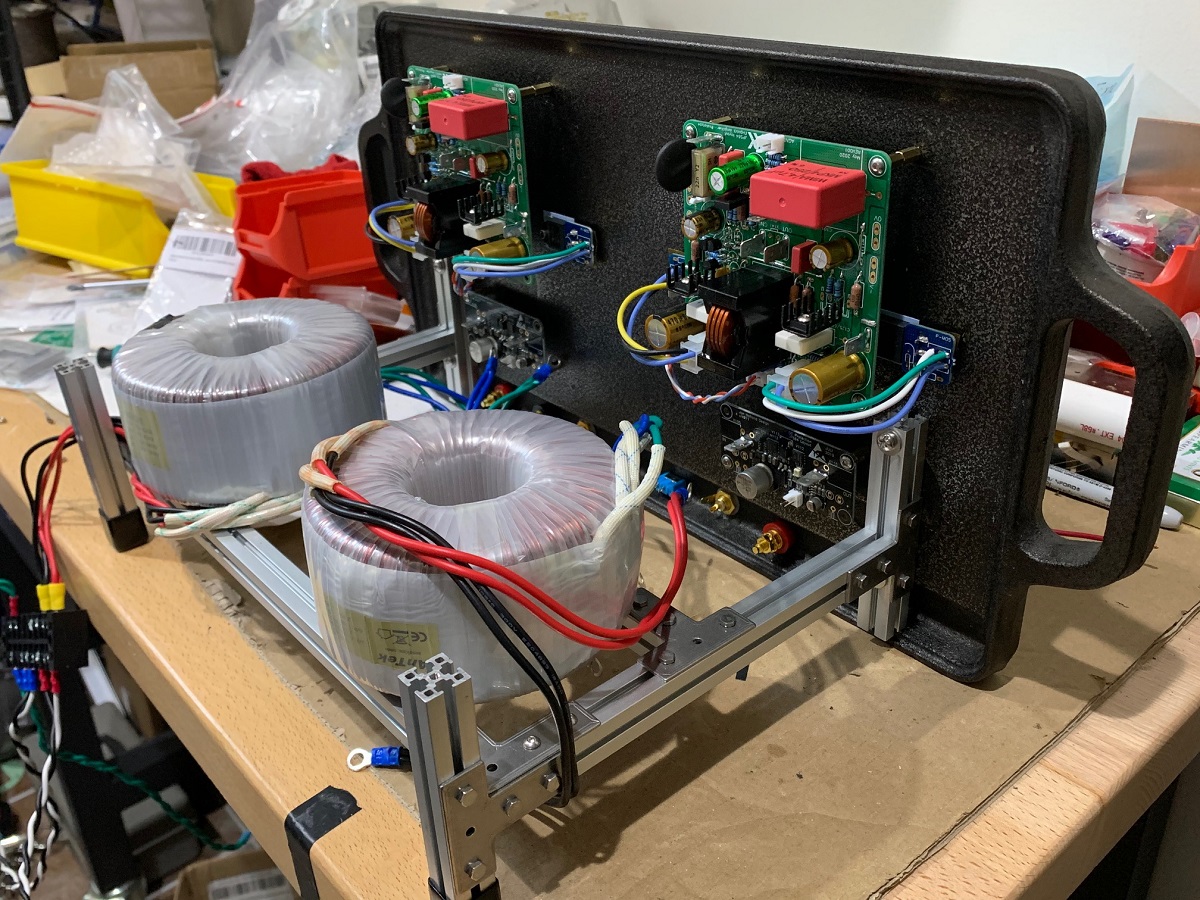

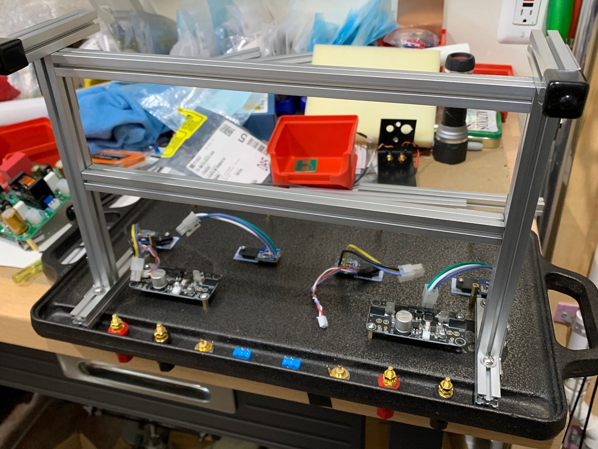

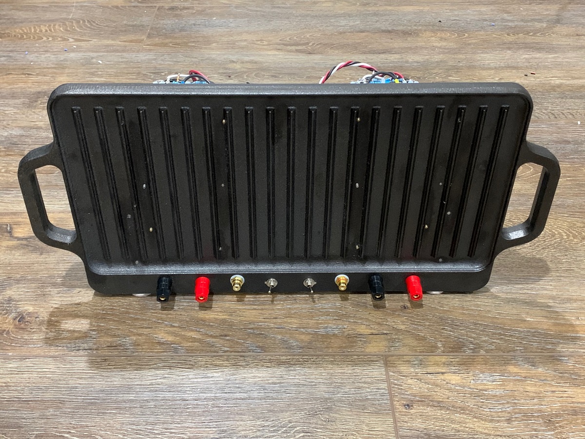

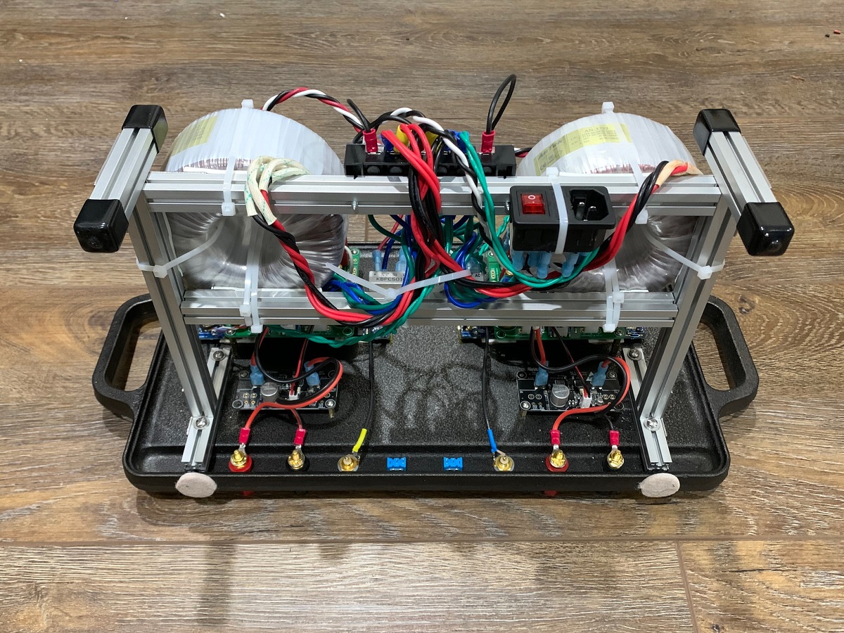

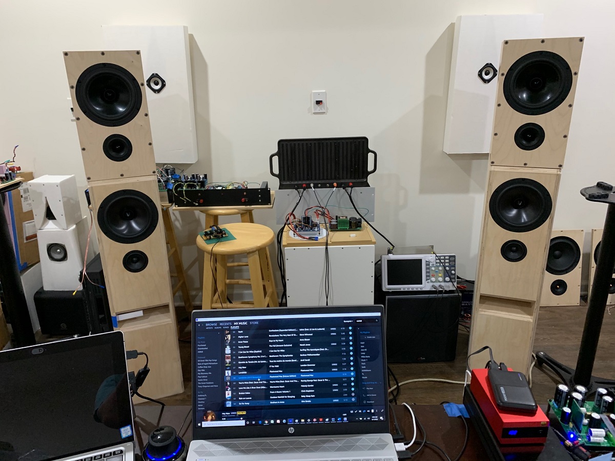

Some progress... MakerBeam XL framing for the rear support structure. All holes on griddle drilled and tapped. Holes for speaker output binding posts, RCA inputs, and some toggle swithes which I may use for a remotely enabled softstart or some sort of Arduino controller. Could be simple as shorting inputs to ground to enable pluggin/unplugging signal cables upstream.

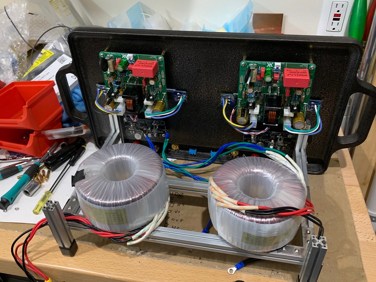

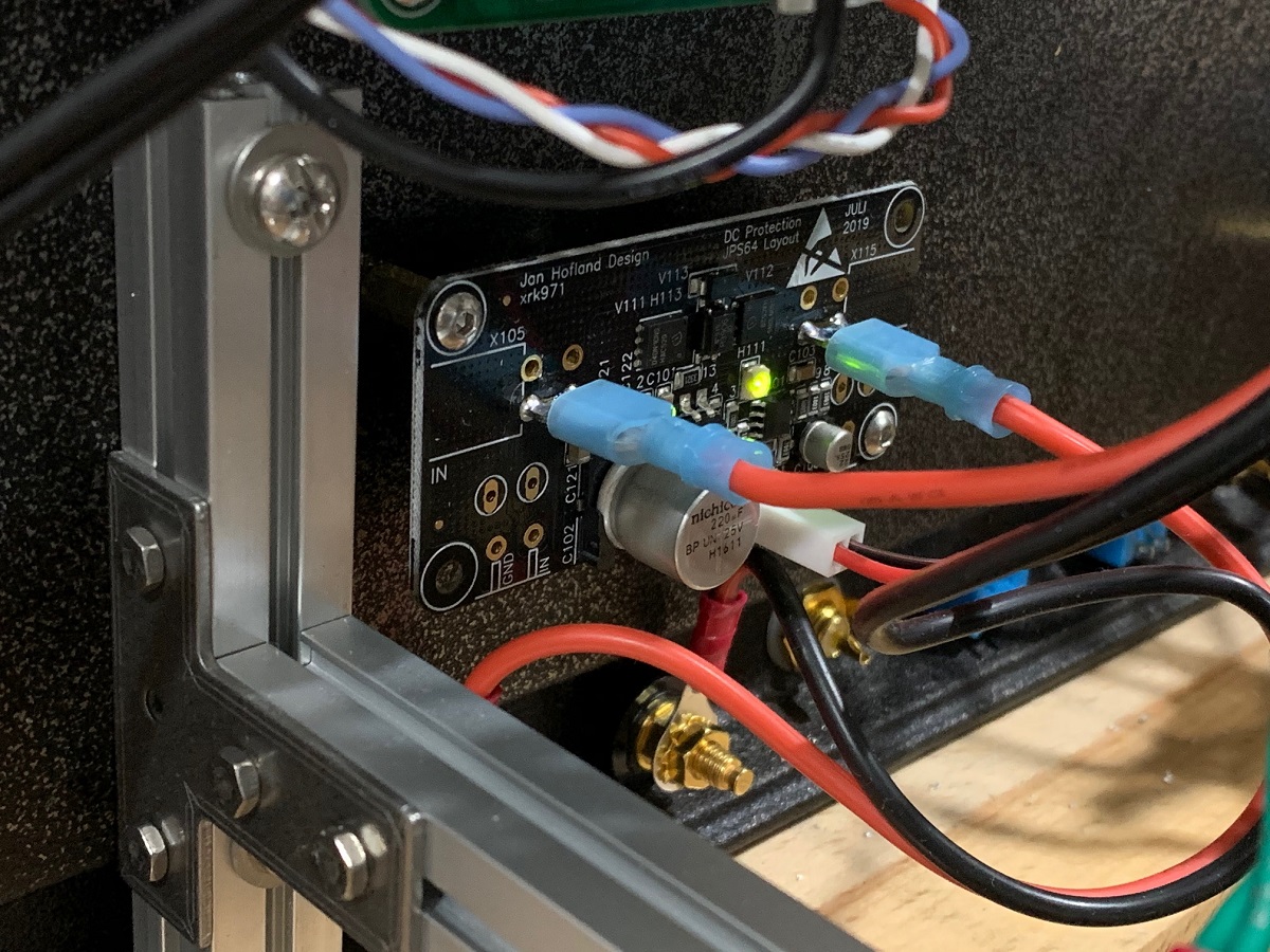

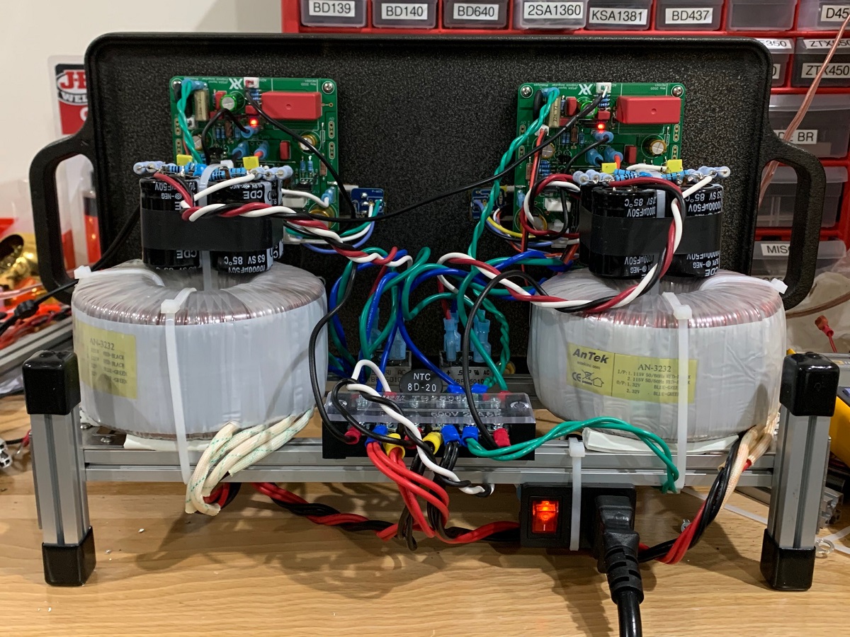

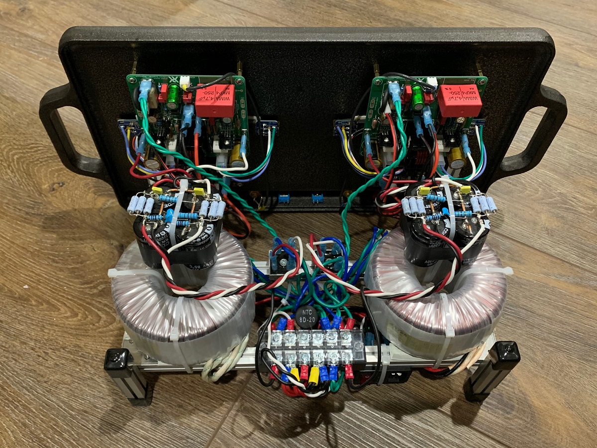

I finished the amp and listening to it now on my 10F/RS225 FAST TL speakers. What a great combination. Dual monoblock construction with two Antek AN-3232 trafos. PSU is 4x 10,000uF 50v caps in CRC with ~0.1ohm. I might jumper the R later to see if that helps the amp. I am getting +/-44v with quiescent bias current of 150mA.
SSR speaker protection circuit is a must at therse voltages:

Got to play it loud today since it was finished in the wee hours of the night. It sounds fantastic with some unbelievable bass authority. Very smooth and clean amp. No fatigue - just the opposite. You want to listen more and more of your collection.
The FH9HVX with 100w on tap is a superb sounding amp at a budget price BOM wise. Now paired with a budget heatsink we can really make this amp accessible to everyone.
