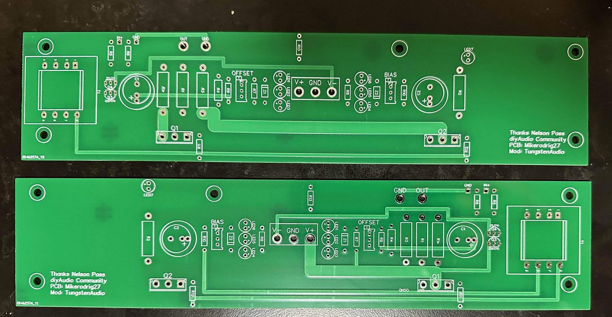

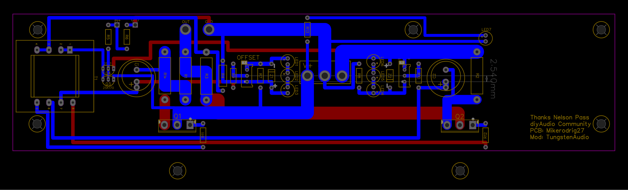

The JFet input stage version
Reactions: 3 users

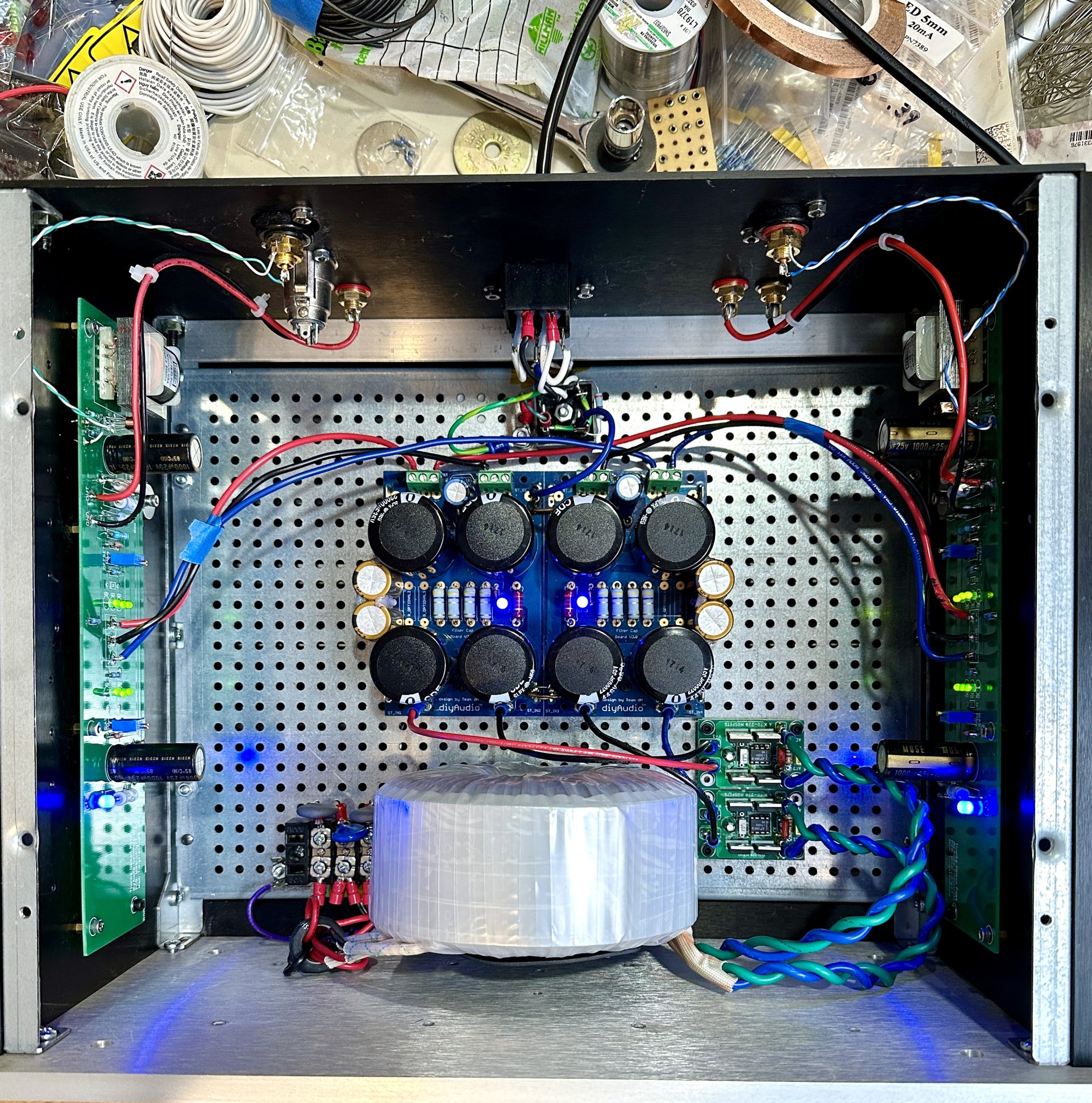

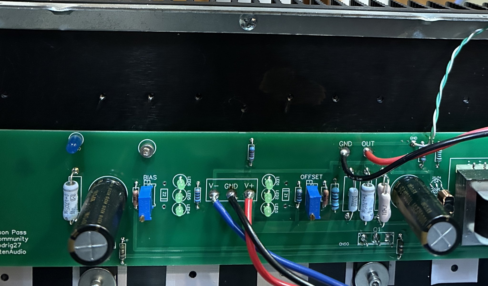

My test bed for the JFet input boards is an old Modushop 4U x 300mm "Jack of all Chassis." This has plenty of heat dissipation capacity to run F6 boards with +/– 24V rails and 1.6A or higher bias current. At 1.6A the heatsinks on my chassis are just warm to the touch. This chassis originally had the Universal PSU board mounted on the inside of the front panel and the 400VA power transformer somewhat in the middle. This arrangement plus an out of date grounding scheme and set of rectifiers was not adequate and required a change to the new configuration shown below. The PSU board and synchronous rectifiers were reused from the original build of my M2x. I must say that they sound better here than they did earlier.
This build is intended to represent one that is accessible to enthusiasts that already have some experience, or those who are fairly new. The channel boards support standard size resistors, but not the larger CM60 in every location. The footprints are well sized for CMF55 and typical 600mW metal film varieties from Vishay, Yaego and TDK. The large 3W resistors were taken from an older stash of Panasonic metal oxide resistors that I had, but newer KOA 3W metal oxide parts have worked well on other boards that I have built recently. Note that the R1 position is split into two footprints. Builders are free to insert a 0.56 Ohm part at R1 and a jumper at R1*, but I highly recommend splitting this into two values: 0.47 Ohm at R1 and 0.0909 Ohm at R1*. This last combination is one that seems to sound especially good with the IRFP048 Mosfets. C1 and C2 are preferred Nichicon MUSE. (Grab some while still available.) R11 and R12 can be from 110Ω to 68Ω. I'm using 68. R7 and R8 are best set at 3.0 kΩ to keep the green LEDs well lit.
The sound. This amp came into sonic focus more readily than several other in the recent year. Not too surprising since the PSU caps were previously used. The Nichicon MUSE caps use a split foil construction that is sadly going the way of many good things. Over the course of half a day, this F6 gave one of the clearest presentation of instrument harmonics that I have heard. Bass was extended and highs were sparkling without being overdone. I have come to expect a liquidity to the sound of N. Pass Class A designs, and this is well preserved. As the original F6 was built around the Semisouth power JFets, it seems to do better with higher transconductance Mosfets in their place. The IRFP048s are an excellent match for the capabillity of the F6. At a rated Vds of 60V, they seem to be in their sweet spot with +/– 24V power rails.
I listened to a couple of my favorite albums and came to notice the only shortcoming of this build. It shares a single PSU in common with both channels. This does ultimately limit the extent of the soundstage relative to the speaker locations. The soundstage exists between the centerlines of the speakers and does not extend above the tweeter locations, though there is a plesent front to back depth. While instruments sound full bodied, there is a slight deficit of spatial definition. I may tend to notice this as I am now used to listening to dual-mono builds. I want to try another tweak to the test bed PSU to see how that works. (Motor run caps) My recommendation for future builders would be to commit to a dual-mono constructions if at all feasible. A pair of ca. 200VA power transformers would be sufficient. Both Antek and Triad have suitable models with 18V secondary windings.

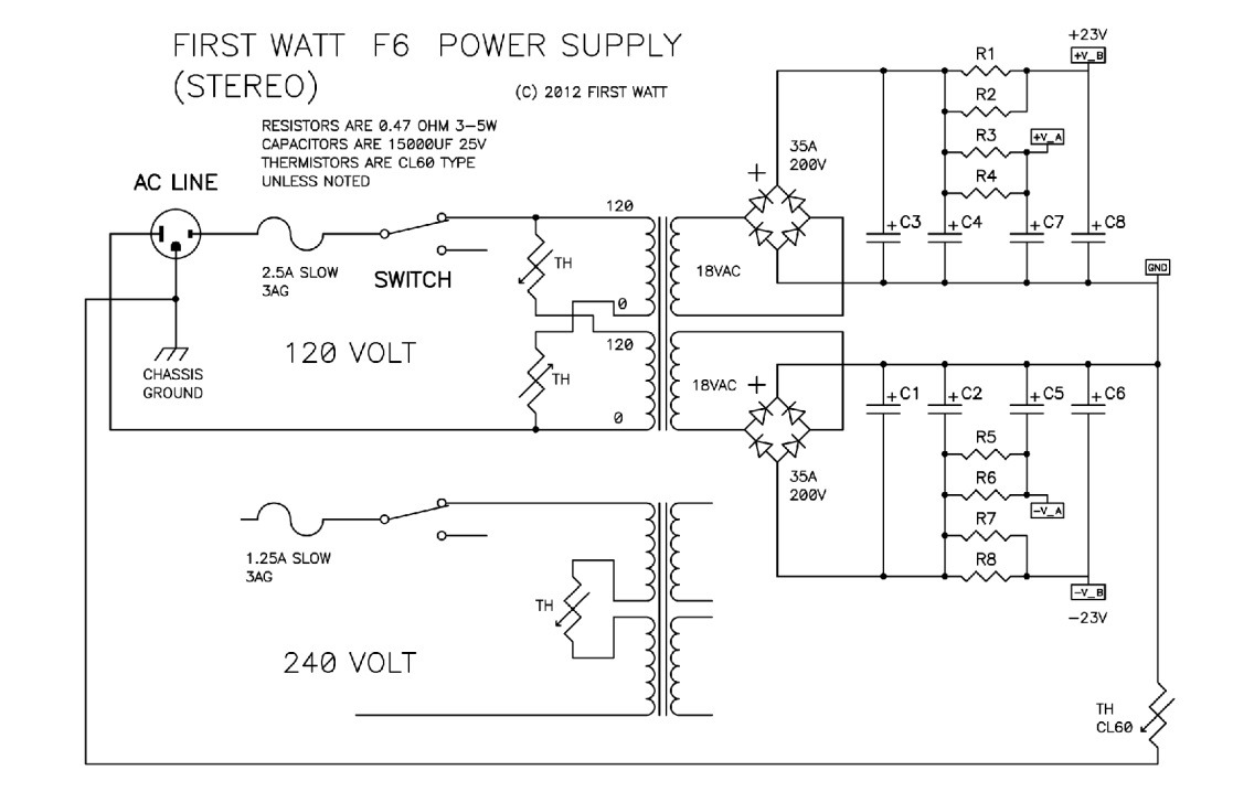

Hi TA,
You mention the PSU - is this a "standard" CRC design PSU or one based on Mr. Pass's recommended PSU for the F6?

The PSU that I used was a tweaked version of the standard CRC design sold in the store. I added some extra caps to make it the most it could be.
The PSU is one of the ways a builder can make an amp their own. My original F6 has a gonzo supply based on a pair of dual rail SLB boards and two Antek AS-3222 power transformers.
First Watt power supply for stereo F6 attached - excerpts from the F6 article by Mr. Pass:
"It's the same thing except that you can split the RC networks out to each channel separately.
These sorts of filters are very effective in lowering the noise, particularly the higher order
harmonics of the ripple noise."
Regarding a power supply as mentioned by zman01 above:
This can be built using a pair of the Universal PSU boards from the store and a single 400VA transformer. The trick would be to populate just three of the big capacitor locations on each side, leaving C2 and C3 empty. The boards may then be stacked vertically (in a 4U or taller), or arranged side by side. The two boards are then electrically connected using some nice 16ga wire between the corresponding C2 and C3 mounting pads. I would populate R1 through R3 and R8 through R6 with the recommended 0.47 Ohm, 3W resistors in each board. This will have the effect of a quasi dual-mono PSU as outlined by N. Pass for use in the F6. I tend to prefer the large snap-in caps from CDE (SLPX series) or EPCOS in 18,000 uF.
Reactions: 1 user
