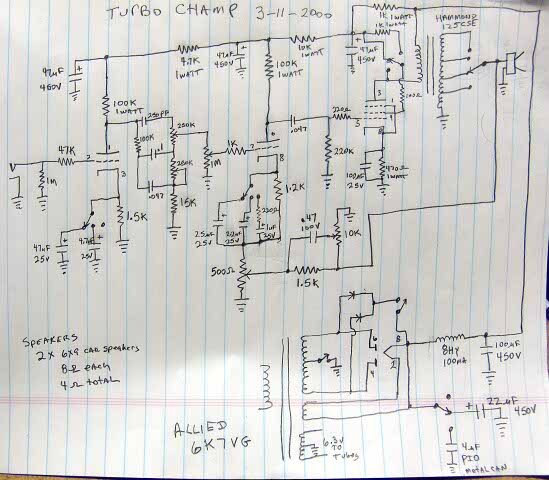

The challenge is to build a low-powered practice amp for electric guitar. Power output should be in the range of 2-5 watts. The amplifier project need not include a cabinet or speaker.
Total cost of the completed amplifier is not to exceed US $100 ( or equivalent value in non-US currency).
The power supply section can be solid state, but the signal stages must be all tube. Semiconductors may be used for biasing, current control, etc.
The amplifier must be reasonably safe. No line-powered (non-isolated) designs will be considered, and proper enclosure of high-voltage circuitry is required.
Parts may be sourced from any outlet available to the general public; the object is to develop an amp that anyone can build in the months to come.
Parts from vendors who have severely limited supplies or short-term discount pricing should not be used.

Too bad I can't find one of my "Turbo Champs" (sold the last one 10 years ago). They were quite popular and really screamed. Schematic enclosed. Probably over $100 at todays prices, but swap the KT88 for something cheap like a Chinese 6L6GC
