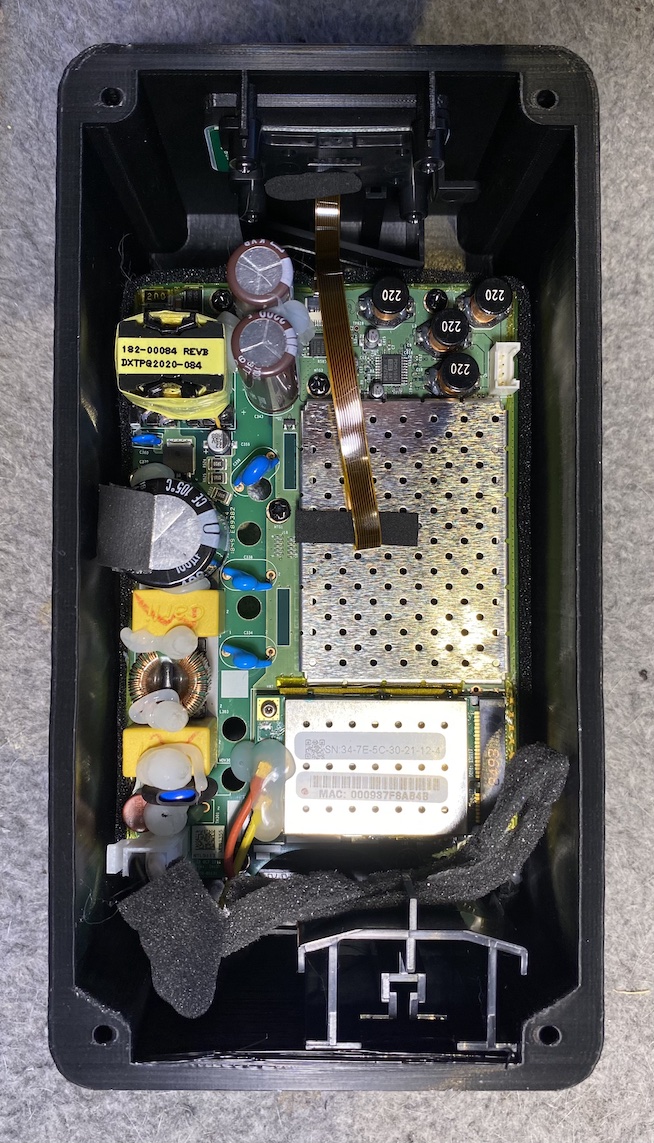

I am starting this new thread with the hope fellow forum members will benefit from the work already done, and possibly can help me with the work still ahead.
I too am working on the Ikea Symfonisk hack, mostly because we are already heavily invested into the Sonos system for casual listening.

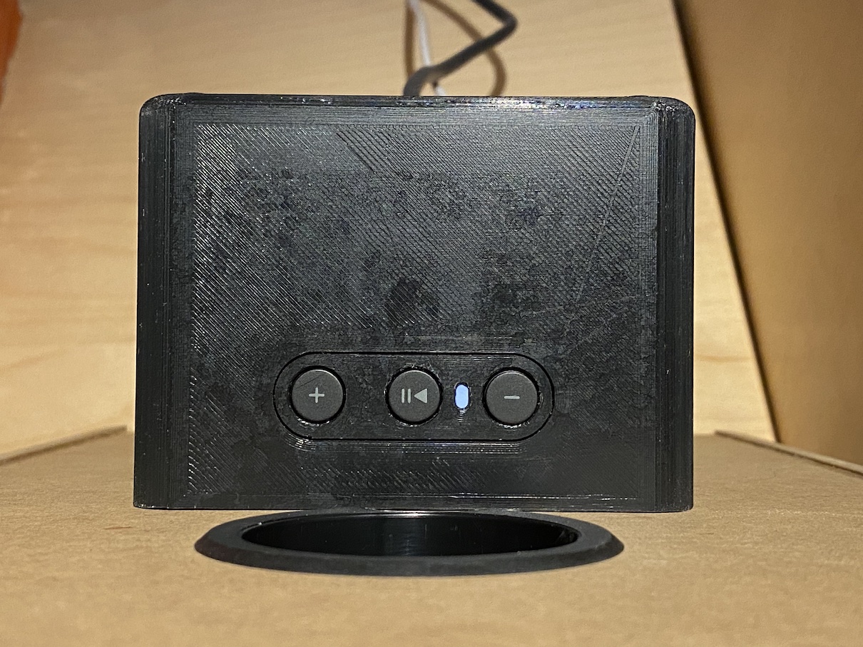

In my office,I used to have a Sonos Connect:AMP to drive two homebrew bookshelf speakers, but I got curious after reading about the Symfonisk hack. So I bought one, opened it up and hooked it up to the drivers directly and this sounded way more detailed to me. So I bought a second one and from thereon, the project got stuck.
But not before I got a friend to design a 3D printable enclosures to mount the Symfonisk board on the back of the speaker:
(It's a real pity the forum engine ignores the orientation property)

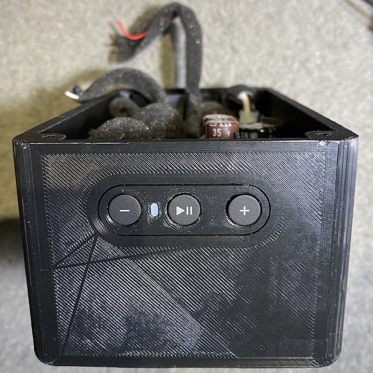

We even added the Sonos signature button panel:
It's got that 3D chique finish, but it's on the back, so nobody sees is. I have to lookup the .STL files and I will post them here later.

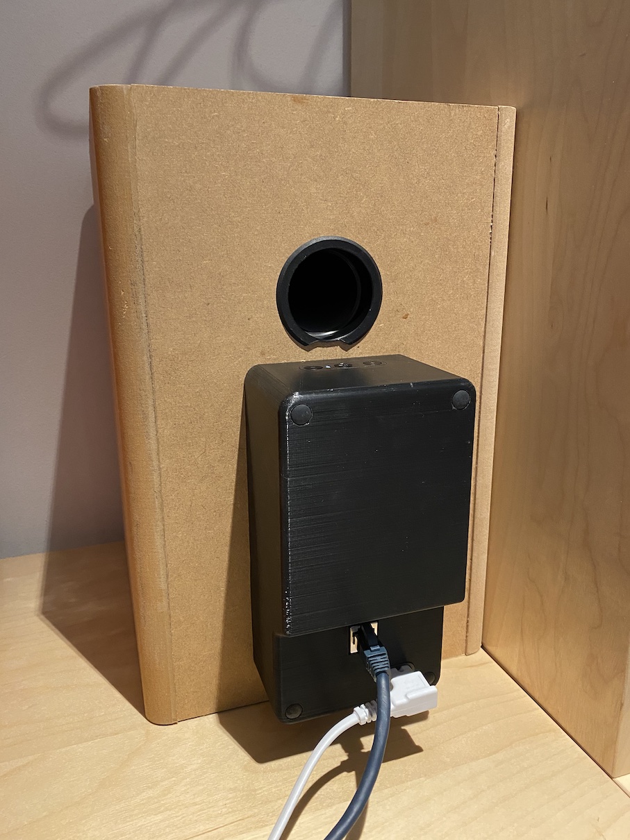

Two updated photos to illustrate the project

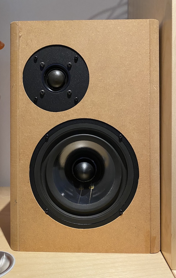

Below two photos illustrating this project. The first photo is of one of the speakers itself. I build it a long time ago, originally intended as rear-speakers for my cinema setup, but they didn't match my DIY Dynaudio Double-17's on the front very well. After being set aside because of that, I hooked them up as office speakers and they were surprisingly impressive on their own. Now they are high-quality Sonos (compatible) speakers.
Yeah, painting is not my strong suit. And I had to clip off a bit of the reflex port for the wall mounts I used in the cinema setup. It's a battle scar.

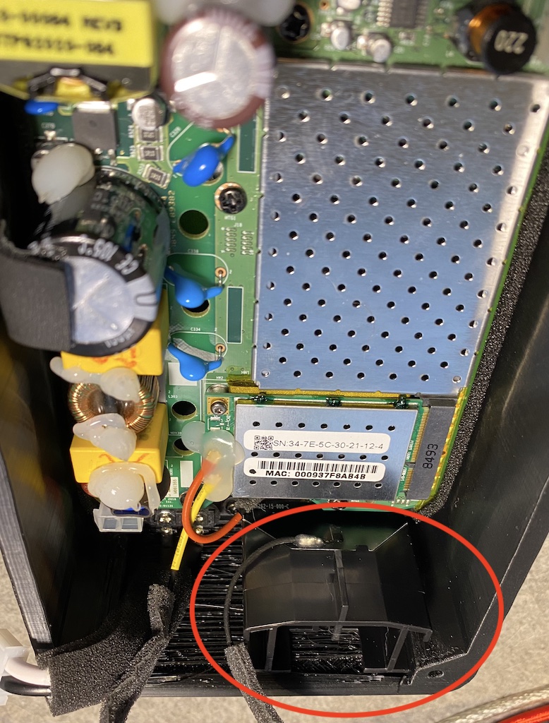

Step-by-step assembly instructions

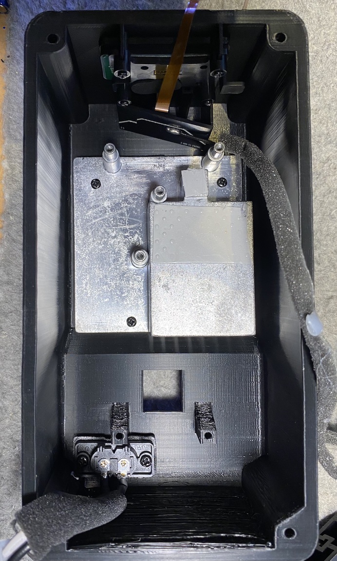

Step-by-step assembly instructions. Each step matches one of the photos attached.

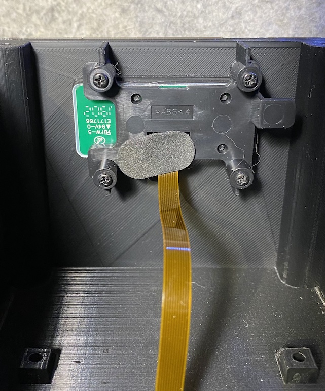

- Mount the Sonos-shaped control panel into the top op the box. It goes in only one way; with the flat flex cable inwards. Leave the flat flex cable attached to the control panel circuit board, as there is no reasonable way of connecting it after the control panel has been mounted.
- Use the same screws and mounting bracket that held it in place in the original Symfonisk enclosure and be sure not to over-tighten them.
- Mount the smaller of the two antennae below the control panel. If you pry it loose from the original Symfonisk enclosure carefully enough, you don't even need to apple new double sided tape. Orientation of the antenna is important!

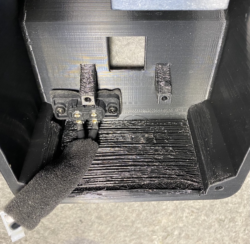

- Mount the mains socket. Again, use the same screws that held it in place in the original Symfonisk housing. Position the wire lugs downwards and don't remove the acoustic gasket. Again, use the same screws that held it in place in the original Symfonisk housing. It fits in only one way.
- Mount the heat sink. Again, Again, use the same screws that held it in place in the original Symfonisk housing.
- Mount the circuit board onto the heat sink. You can tuck the cable of the top antenna under it, but make sure it stays on the side of the heat sink, not interfering with the board contact. Four of the six screws fasten the board to the heat sink. Use the same screws that held it in place in the original Symfonisk housing. Tighten the two center screws first. For the two bottom screws, it is better to use two of the similarly sized, yet slightly thicker, blunter screws that came out of the Symfonisk. If you don't know what I mean, use the same pointy screws as the other four.

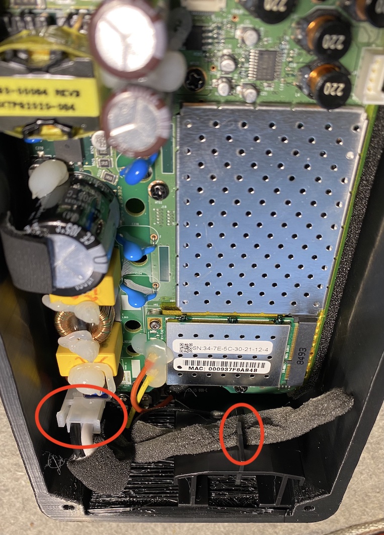

- Mount the larger antenna on the bottom of the enclosure as shown in the red circle. Again, you can reuse the tape still on it. Orientation of the antenna is important!
- Connect the mains connector to the board and tuck the antenna cable of the larger antenna under the hook of the antenna, as shown in the two red circles.
- Fold the flat flex cable for the control panel onto its own tape. Leave a loop at the end and fix it to the RF shield with a little piece of foam tape.
- Ready to be connected to a woofer and tweeter, and to be mounted on the rear of a loudspeaker.

Mounting tips
Mounting tips:
Mounting tips:

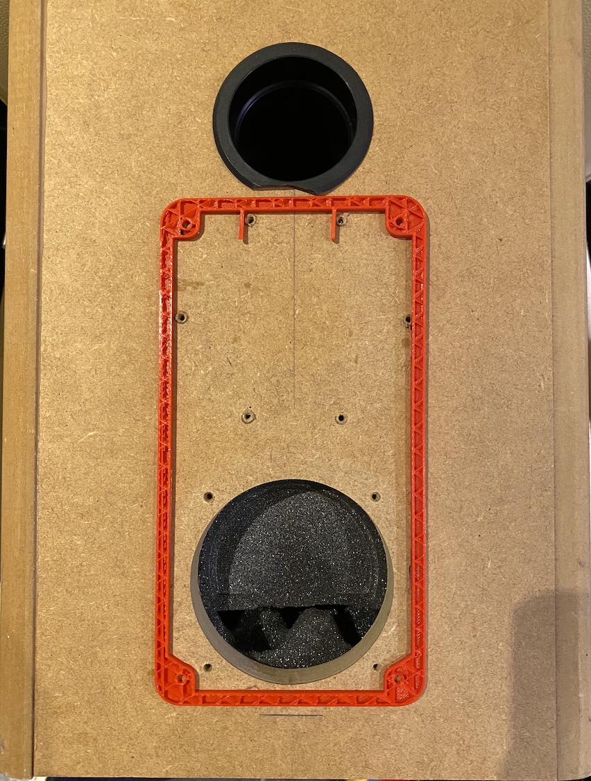

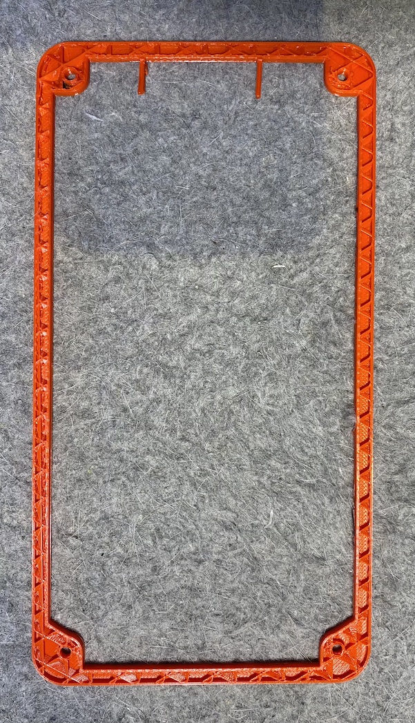

- Print a few layers of the housing with the mount-side on the build plate, as a drilling/fitting template.
- Use this template to fit the best possible location to mount the box and mark the mounting holes.
- Pry off four of the eight rubber-domed feet from the Symofnisk and use them as hole covers for the mounting holes on the back. The mounting holes have purposely made recessions for that.
- Yes, when looking over the speaker, the control panel appears upside-down. That's an after thought, but I'm not going to change is anymore.

The loudspeakers they're connected to now were once built for DynAudio 17W75LQ midtone woofers and D28 tweeters, but those because increasingly rare, so I settled for Seas T18REX/P-IT (H1013) woofers and Scanspeak D2905 tweeters. I was unable to find Boden-plots for those, so I have no idea how well/poorly they match the 1600Hz cross-over frequency.
But fully assembled they sound fine. It broke my heart having to rip out the Audin-cap based cross-over filters, but I was surprised how much better this Symfonisk setup sounds than when I was driver the same speakers with a Sonos:Amp.

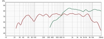

I think he estimates wrongly; The graph uses a logarithmic horizontal scale, not linear. When adding a log scale between the 1kHz and 2kHz line, the yellow line appears to be around 1300Hz.The crossover frequency he estimates is 1600hz, and it looks like its a pretty steep slope, so maybe even a DCF28 would work.
And that's good news for me, because my tweeters are good well down to 1kHz, taking over more high from my woofers (which are T17REX/P-IT, a typo i was unable to correct), of which I do not know their frequency response.

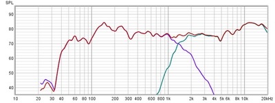

Hi
I have also did some measurements of the IKEA Symfonisk.
The Crossover is 1400 hz.
The org tweeter rolls of at the same freq 12 dB/oct so it ends up with 24 dB.
The woofer go straitht up to 7.000 hz so the DSP must here have at 24dB filter.
