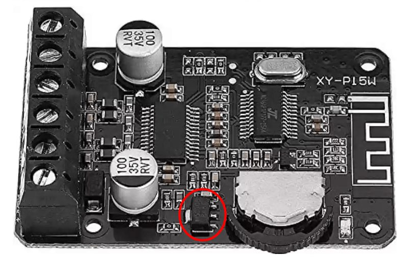

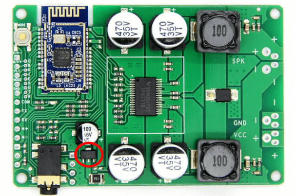

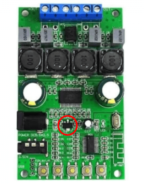

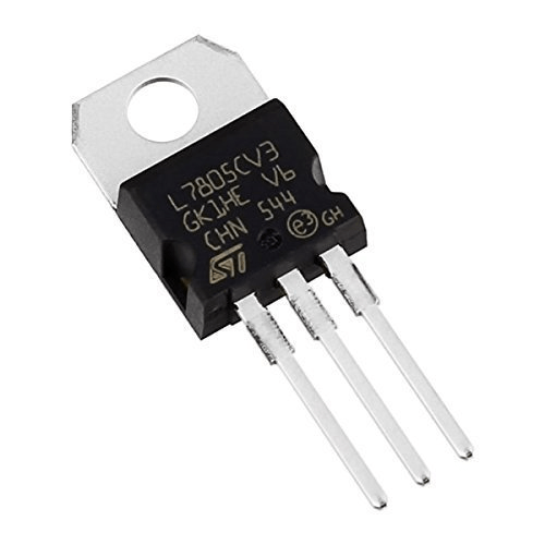

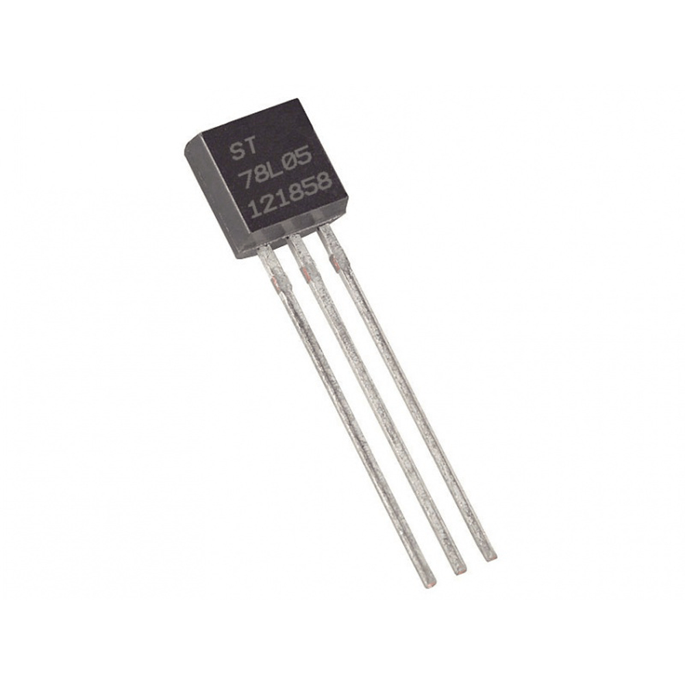

If you have a amp board with bluetooth by your hand, you might notice right away that they don't even have DC-DC converter on it. But, you would find something like this near its bluetooth module:

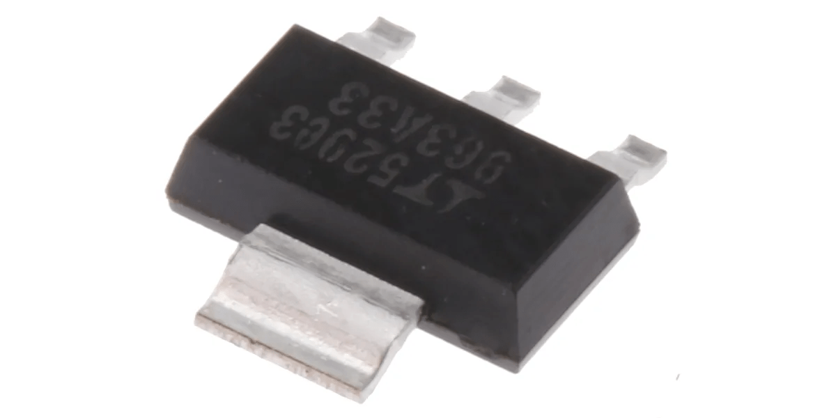

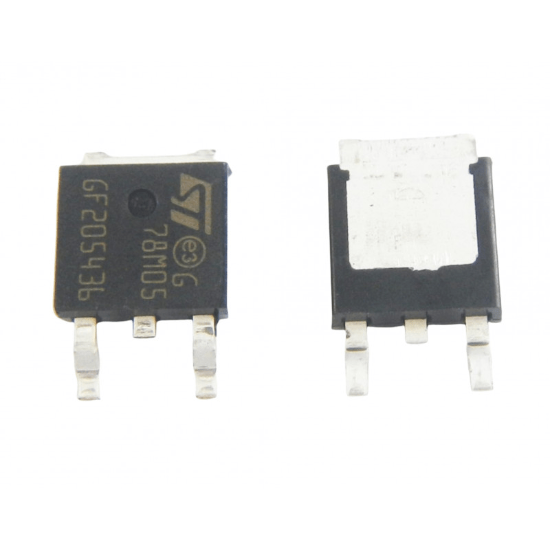

These are voltage regulators, or LDO. If you quick google what is LDO and its advantages, you would know why they are commonly used in these boards. They are cheap, small, require less components, yet offer very clean power source.
The solution is obvious, when the supply voltage is too high for your bluetooth receiver, use a voltage regulator to supply power to your bluetooth receiver. Typically, a LM7805 would do the job for you.

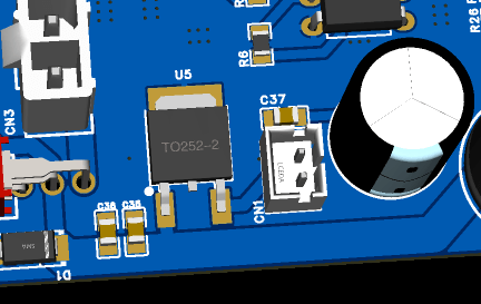

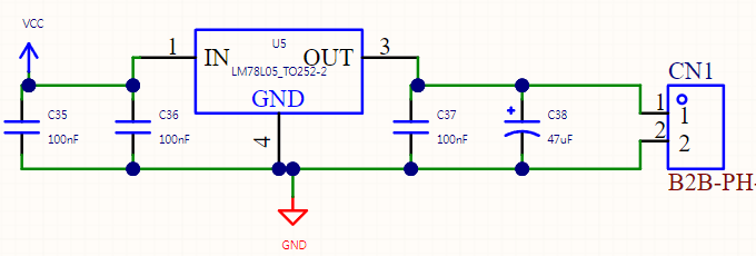

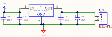

To make the power even cleaner, decoupling capacitors can be used in the circuit. Here I am providing an example of my own PCB design for supplying power to the bluetooth receiver. (Made it into a connector, where the receiver will be connected to get its power.)
PS: Voltage regulators are rated for very low current, they can be hot under normal operation. Therefore I recommend sizing a much larger one in your circuit. (I actually picked one that is rated for 500mA even tho my bluetooth receiver only draws 64mA from the aboves example.)
