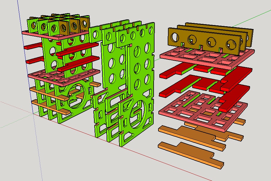

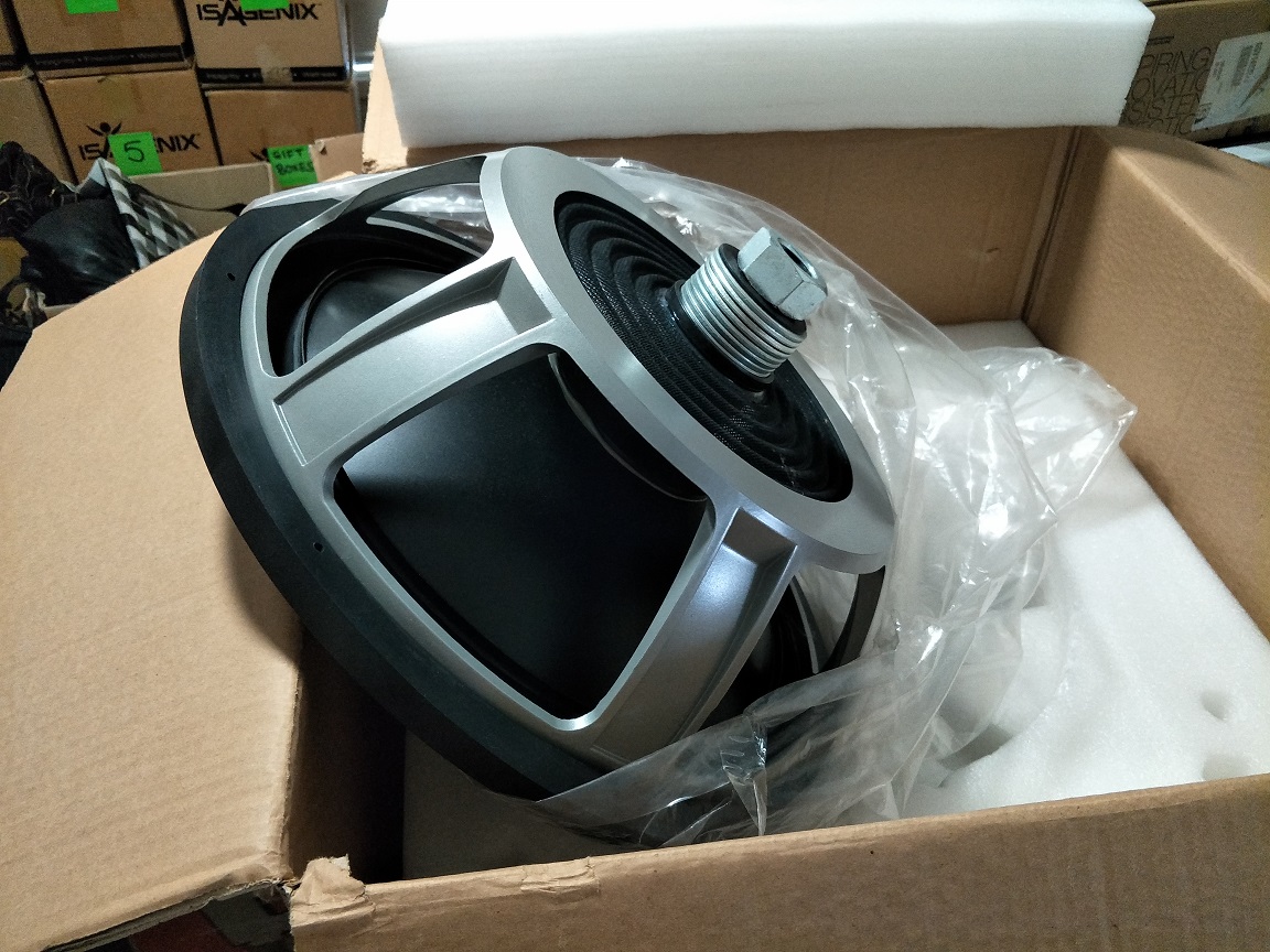

For years I have procrastinated and procrastinated building the mother of all subwoofers. I have gotten to the point where my own slackness is really ticking me off. For 4 or 5 years I have had 1 x TC Sounds LMS 5400 Ultra sitting in a box, along with another 2 x 18" TC Sounds VMP passive radiators.
I have even had the design done for several years, and my CNC machine is up to building it. I also have a Crown I-Tech 9000HD to power it. If I don't build it now I am going to be too old to enjoy it, so as soon as the weather gets better I have committed to getting this beast underway.
Comments and suggestions most welcome.

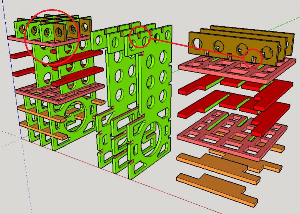

Shouldn't those inlets at the top (for the green and brown panels) be halfway deep, to allow them to fully integrated with each other?

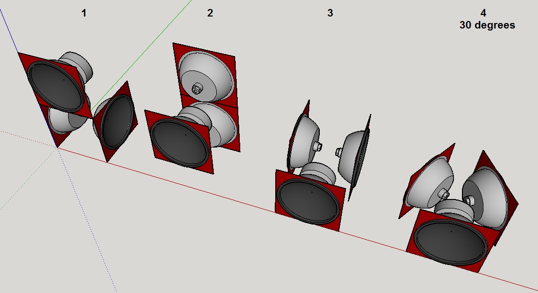

Are you suggesting moving the PRs more in line with the active driver?

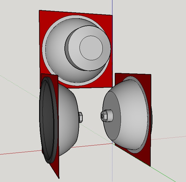

You could mount the passive radiators on opposing sides to cancel vibrations.
One PR will be on the left and the other on the right, with the active driver facing forward.
I think Rademakers was pointing out that the notches need to be half depth on each side to successfully create a Cross Lap joint.
Yes the plan is to slot as much as possible to interweave the pieces.
Material I am looking at something like 19mm-25mm ply internal. Up to 40mm for external walls depending on the weight.

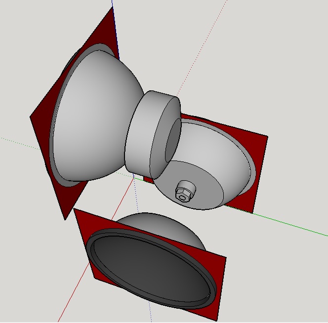

The box will to a large degree. TC Sounds PR's have an unusual mass system that allows you to add additional weight to the PR to tune as well.
Although the way I see it, air is compressible (otherwise there would be no turbos and it would be a very sad world). And if air can be compressed (which it can) then we need to consider the path of the air movement inside the box and its effect on timing relative to the active driver.
Theoretically the PR should move before the box sides due to a little thing called path of least resistance, but I propose that depending on where you place the PRs in the box, you might be able to increase of decrease the amount of resistance before the PRs move.

So long as the bracing is open and the box has a reasonable aspect ratio, the air within the box will act as a simple spring. One you get towards high-aspect-ratio cabinets, transmission line effects start to come into play.
Your cabinet will be fine.
I'd go for PRs arranged opposite to each other, so there's force cancellation and the cabinet itself doesn't walk around. You're looking at over a kilo of mass vibrating around.
So, the conclusion is that your cabinet is fine. Just make sure the PRs are mounted on opposite panels when you build the thing. You could have main driver and one PR firing forwards, and one PR firing backwards, or PRs firing out of each side with the driver firing forwards, or...
