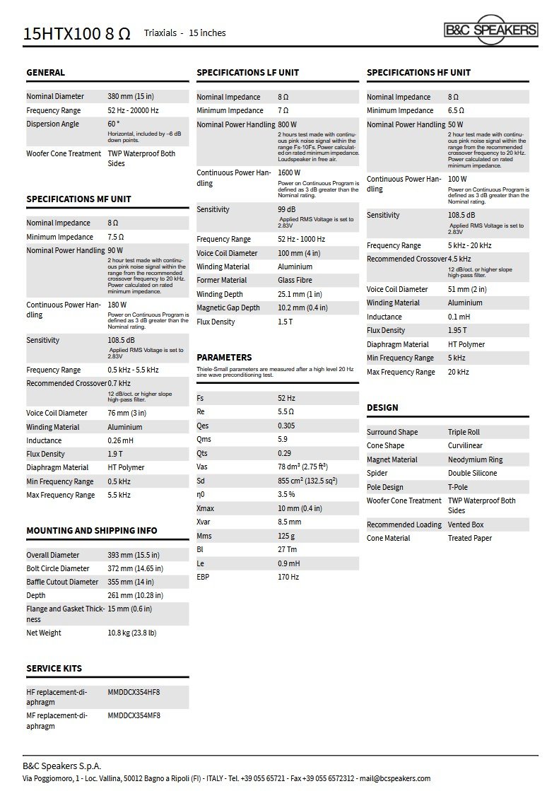

Anyone know what size cabinet this would need to go in?
60/40 is pretty narrow coverage though, but if you like giant headphone style speakers they sure look good.
Max flat with a little added series resistance:
Vented net volume (Vb) (L) = 20*173*0.34^3.3 (Ft^3 = (Vb)*~28.31685) = 98.4 L
Vented box tuning (Fb) (Hz) = 0.42*44*0.34^-0.96 = 52 Hz
Dunno, wrote out the math from the Margolis-Small's HP 67/97 & 41C calculator program that I often post and used the attached specs except subbed Qes for Qts' to cover a little series resistance and use this little program for conversions which 'says' ~3.475 ft^3.
That said, noticed I copied this wrong! (Ft^3 = (Vb)*~28.31685)
s/b (Ft^3 = (Vb)/~28.31685)

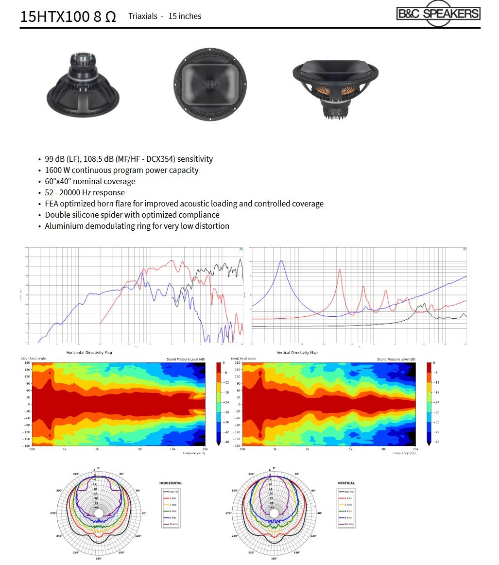

Pardon for necromancing this thread but didn't find any discussion about the new B&C 15" triaxial, released few weeks ago but not yet available. Thomann price 899€ (incl. Finnish VAT 25.5%) https://www.bcspeakers.com/en/products/triaxial/15/8/15HTX100
- The new triaxial speaker by BC Speakers
