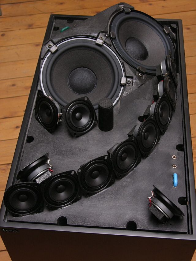

The big thing that differs is that Carlsson actually released quite alot of technical information, some even in english:
You might have to cut and paste because faktiskt.io will deny linking from other audio sites.
https://user.faktiskt.io/schmutziger/OA51 FAQ/pdf/oa-51 speaker and listening room.pdf
https://user.faktiskt.io/schmutziger/OA51 FAQ/pdf/carlsson_ortho_design_principles.pdf
Please remember that these documents were written in ~1984
a faq about OA51: https://www.faktiskt.io/phpBB3/viewtopic.php?f=17&t=20120
For LTAS measurements of most Carlsson models, go to www.carlssonkult.se, click "modellerna"
The OA-5 & OA-6 was constructed as mono speakers, OA-12,OA-14, 116, 2212 were inbetween and the OA50, 51 & 52 were stereo speakers with more on axis sound than the previous ones.

I have owned several older Sonab models and still use OA-12 in my "lab". Fitted with modern replacement tweeters it sounds great and much bigger than it looks and it also works reasonably well with tube amps. But it is not suited for large rooms.

Attached, for this who may not be familiar, is a condensed paper on the basics of Stig’s loudspeaker design principles.
