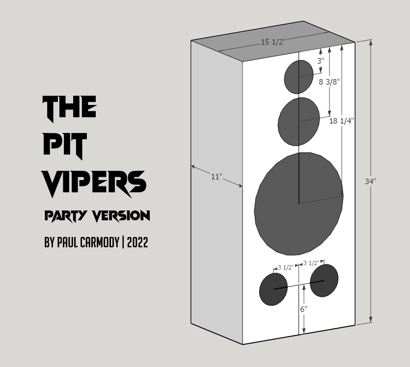

Planning on building the Paul Carmodys The Pit Vipers.
Built a couple of amps and pre-amps with a lot of help from this amazing forum.
Recently got a workshop in my possession so I think its time to make a couple of speakers now when I have the space.
The plan is to make something quite simple and I found the Pit Vipers which seem pretty straight forward.
I do have a few questions though. (probably stupid)
1. What is the best kind of material for this kind of speaker? MDF?
2. The plan that Paul Carmody doesnt specify the thickness of the material. Can I just assume the thicker is better? Thickness would change the volume but not to any large extent.
3. He is using a 6" PVC end cap on the midrange. Wouldn't be better to make a proper enclosure?
4. How much damping should be done? All sides, top/bottom?

Torstensson,
Good questions 🙂. Some quick thoughts:
1. Material: MDF works, but nowadays many folks on the forum would prefer good quality plywood, as it is stiffer for the same thickness.
2. Material thickness: Thicker is not always better; rather, it is better to have a well braced cabinet. As Paul has mentioned, these are large cabinets, and without proper bracing they will resonate - which is not a good thing - so brace them well internally. if you are using good quality plywood, then 18-19 mm thickness material should be sufficient, and as mentioned before, use bracing throughout. It is also important to keep the width of the front baffle as close as possible to the original design. For the front baffle you can use 25 mm or 30 mm (glue together 18 mm + 12 mm material) to make it stronger.
3. Mid-range cabinet: By proper enclosure for the mid-range, do you mean one built with MDF or plywood? Such an enclosure would likely have thicker walls and take up more space inside of the cabinet - please keep that in mind.
4. Damping: Paul has some guidance on lining the inside of the back wall of the cabinet. In addition to that, maybe you can use 12-18 mm lining for the top and bottom too if you fancy. And if the bass feels a bit bloaty/congested, you can add some Dacron / hollow poly fill later.

+1. Not the "Birch Plywood" at Home Depot. A specialty lumberyard can help you with Furniture grade 11- or 13-ply Baltic Birch. And yes it matters. Not just for rigidity, but also for the cleanness of the cuts with a saw or router bit.good quality plywood

I‘ve shifted by method on cabinet material to a dual layer system. I build the initial box with standard 3/4 MDF and then laminate the entire box with 3mm HDF using outdoor carpet adhesive. The adhesive never hardens completely so it becomes a constraining layer and fully insulates the HDF surface from any vibration or resonance. The density of the HDF also produces excellent edges and surfaces which are perfect for veneer application. Constructing the main box is also easier and stronger as now I can use wood screws along with glue to build the box……the screw heads are all covered by the HDF layer.I do have a few questions though. (probably stupid)

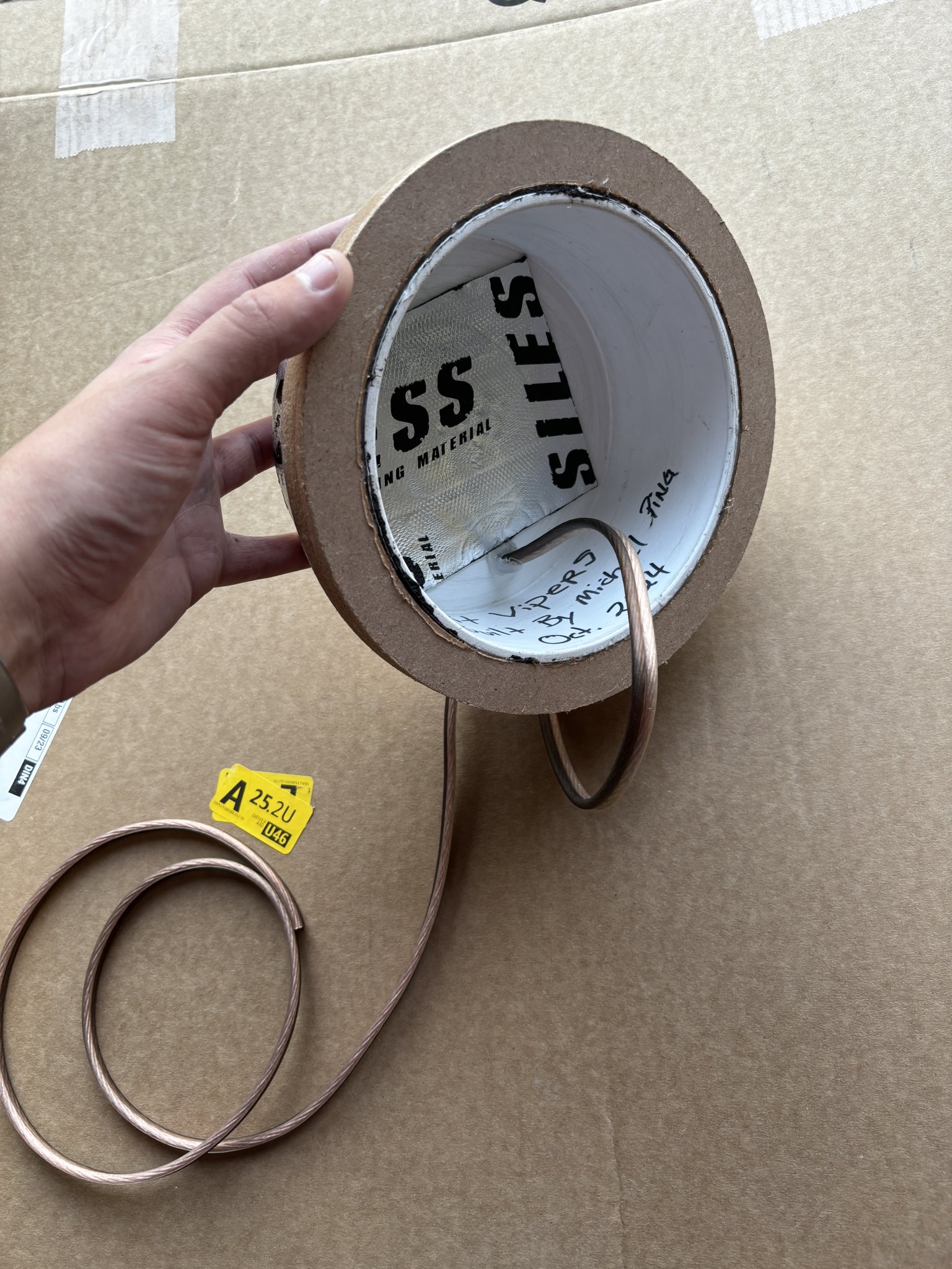

If you take this route, make sure to flush mount your drivers and use a surface hole that is 1mm larger than the drivers mounting diamete. When installing the driver, use shims to fully center it this way the driver does not transfer energy to the HDF. Don’t worry about this with the tweeter though….it doesn’t matter with those high frequencies.
The PVC end cap is fine….no need to overthink things here
With the dual layer construction, I no longer have to ‘dampen’ the interior……a layer of 1/2” recycled denim insulation or similar is all that is needed.

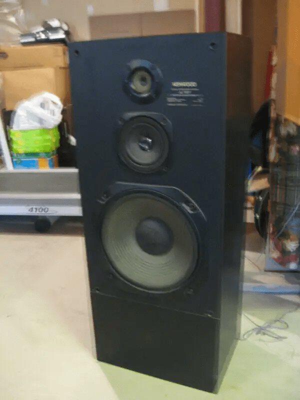

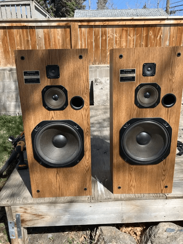

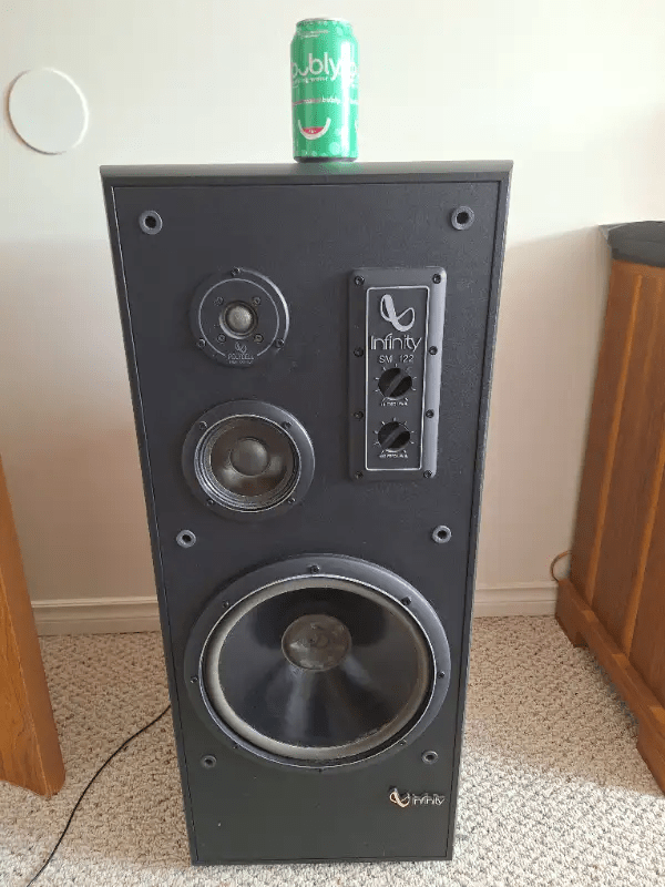

Another option for the box:
Buy good used speakers, add a new baffle (if necessary).
Add bracing, additional panel, etc- for your desired box volume.
Some examples:
Pioneer CSG7000
35.5"h x 15" w x 11 5/8 d
Kenwood Speakers
36" h x 15" w x 11" d
Infinity SM122 Tower speakers
35.5"h x 15" w x 13" d

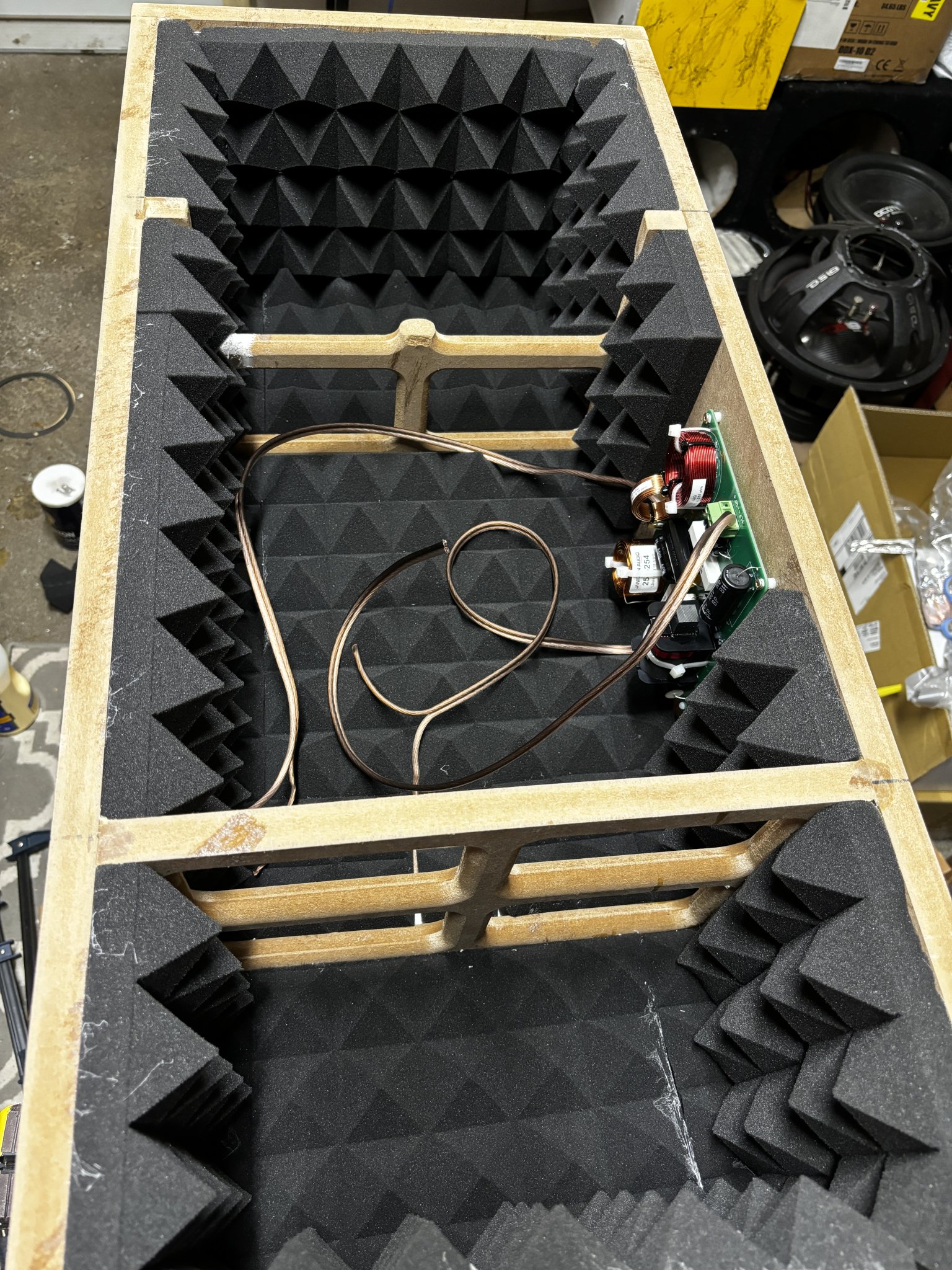

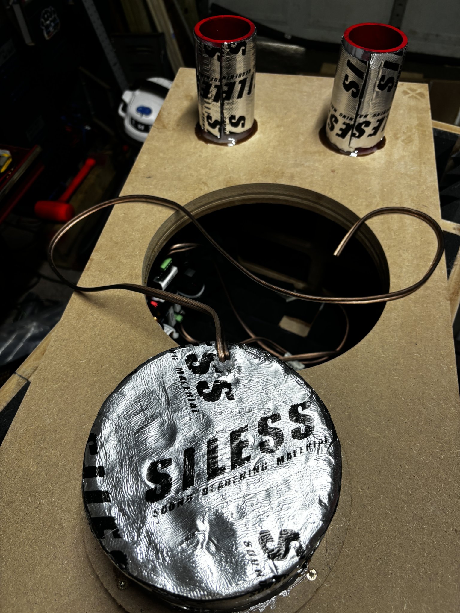

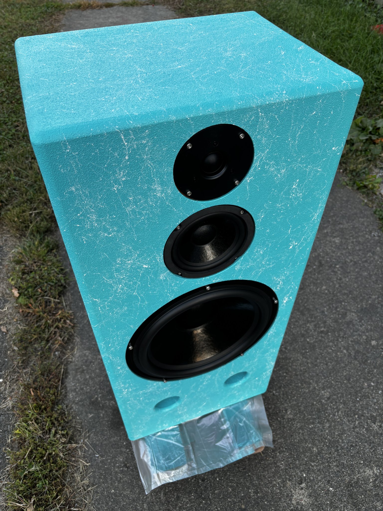

Started the build of the Pit Vipers now. Still waiting for some things for the box but the crossovers are done.
Is there a good way test these? Besides connecting the drivers and see if everything works.
