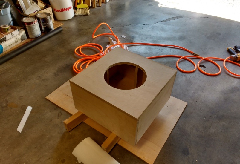

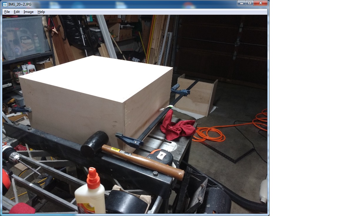

My buddy Howard with his big van helped me acquire a fresh sheet of Appleply plywood and he even cut it up. One sheet yielded two new 50 Liter woofer boxes, and I finally got them glued up yesterday. Glue dries fast in a 90 deg garage. With this plywood the 50 Liter box seems to weigh as almost as much as the 70 liter box I built last time.

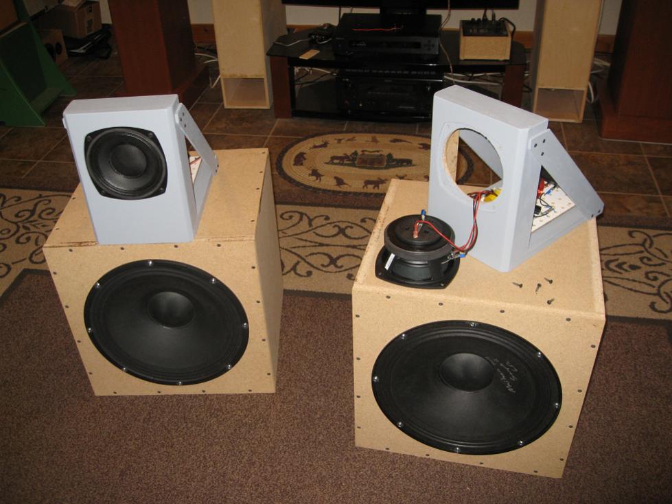

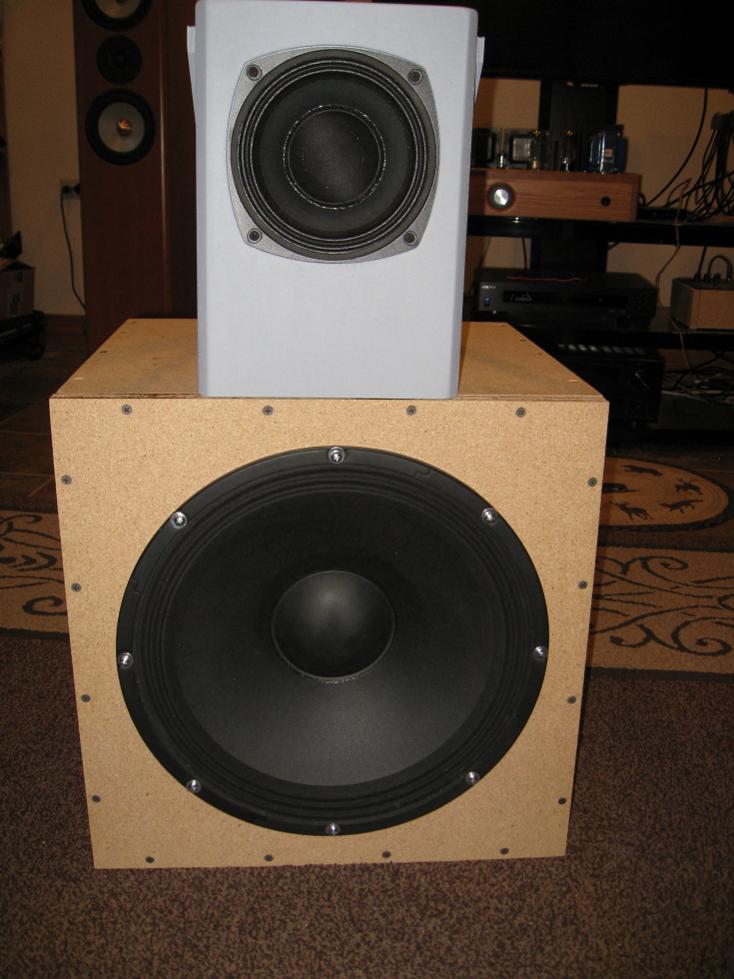

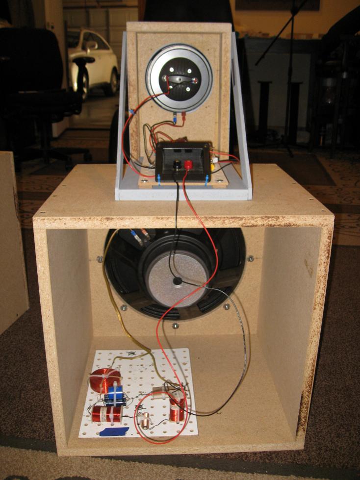

Decided to give open baffles a whirl.
On top is a Celestion 6.5" coax, and rounding out the bottom is a 15-inch (unknown) in a U-frame. I made a template for flush mounting the Celestion which was tedious.
The coax woofer crosses over to the HF driver at 3200, and the 15's do the work below about 100 Hz.
Got the whole thing hooked up this evening for the first time. It makes noise! Still a couple more weeks to tinker with it.
