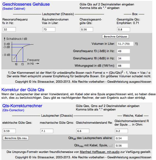

50 Liters seems to be good. A stuffed cabinet of 50 liters gives a Qt of 0.8, that is a bit high to modern standards but the Dual sounded a bit full in the bass.
It is still less boomy then reflex and stuffing the inside more can reduce the Ot and resonance further.
I used the Lautsprechershop tool. It is easy busyness to calculate a closed box.
