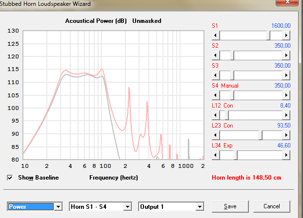

Haven't gotten 'comfortable' yet with HR's new wizards, but here's a simple 6th order [tapped] pipe with a cheap JBL 12" mobile audio driver with near enough spot on specs that you can tinker with/convert.

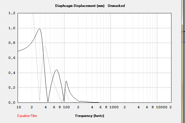

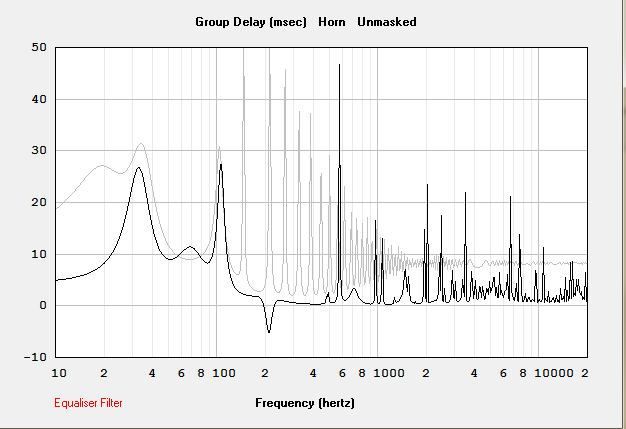

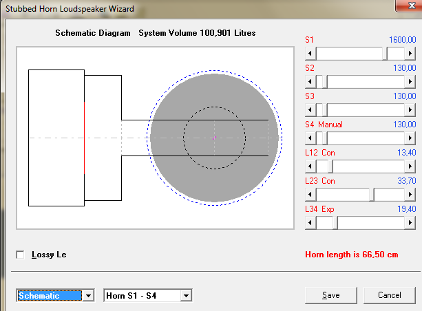

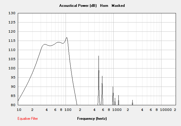

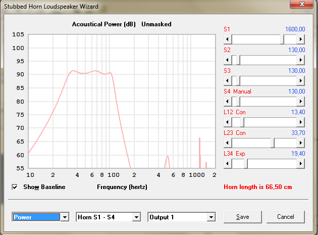

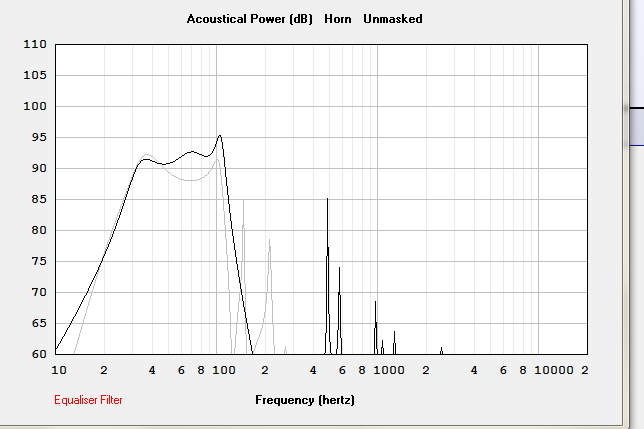

Since it's for sound quality...Maybe a DFCBPCB ( "Dual Front Chamber BandPass Closed Back" -since everything needs a name ^^). Only one source wave since it's closed back. Magnet on front chamber side. Limited output from port small size needed compression and chuffing. Here a fast 5 minutes example with same driver as GM, same size enclosure. Not optimized, need EQ. 2nd chamber is easy to build, it's a reducing PAR segment.
Same driver :
Picture 1, black DFCBPCB, grey GM file, response without stuffing
Picture 2, black DFCBPCB, grey GM file, group delay
Picture 3, black DFCBPCB, grey GM file, excursion
Picture 4, DFCBPCB schematic
Picture 5, black DFCBPCB stuffed (will ne some more eq to smooth curve)
Picture 6 maximum recommanded output due to vent velocity

I didn't look that much to Karlson. I prefer directive speakers since i can get low reflection in my main room. I'm actually building sound diffuser (from magic sponges ^^) and ceiling mounted absorber but i suspect it won't be enough.papasteack re "lol" - that's an impressive SH3. Got any ideas for a "new" Karlson with a stub?
At the moment, i'm on the idea that i much prefer closed back with magnet outside. I don't like the idea that different front and back path can lead to offset pressure while speaker motor yet got so rectifying effect from non symetrical field. At least, i'm on this hype actually 😀
papasteack - what would "lol" SH3 ( DFCBPCB ( "Dual Front Chamber BandPass Closed Back") look like in its most simple cabinet build? How about the parabolic stub's shap? A quick stab at a rectangular stub didn't look as clean (maybe that could be optimized better)
re: Karlson - this K18 sounds fine with the K-tube mounted internally in that hole above the woofer.
It has a curved reflector. I just don't know how to calculate it - a smaller version - maybe with a stub
could be good - could go "wrong"
note the 2/3 ilters difference. Thinnest spikes in hornresp seems to just not happen in real life or at really lower level.
I didn't try to get the absorber chambers the same in volume. This double front chamber BP you illustrated looks useful. I'm trying to figure out how its all packed into a simple box and not waste volume.

DFCBPCB: i don't understand that schematic. what does this box look like?
Imagine a 4th order BP enclosure with sealed and vented sections. Now imagine the vent from the vented section of that enclosure is vented into another enclosure with a vent.
