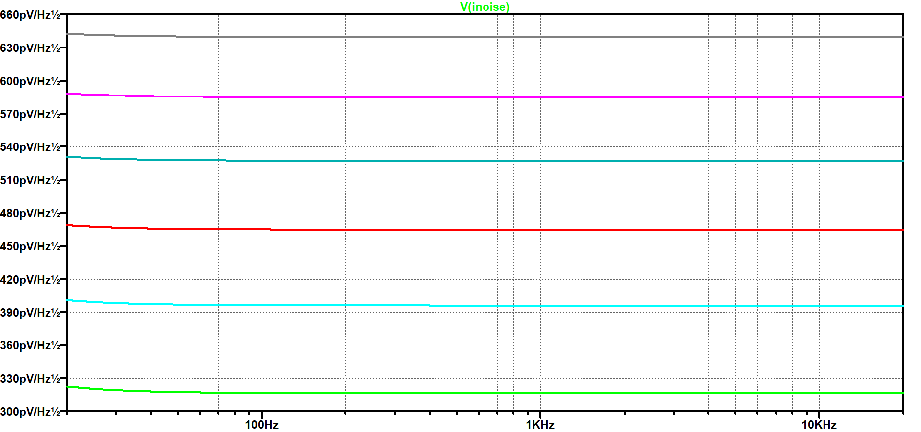

Here is the stepped plot of the X-Altra MC 3 Ohms to 18 Ohms. The total RTI noise with an 18 Ohm Rcart is 640 pV/rt Hz. The thermal noise of just the 18 Ohms is 545pV/rt Hz. With a 12 Ohm Benz cart and set for 5mV output, the total RTI noise is 530 pV/rt Hz. Even with the test input resistance of 47 Ohms (880pV/rt Hz), the total system noise is 918pV/rt Hz. Where do you get 1.1nV/rt Hz?

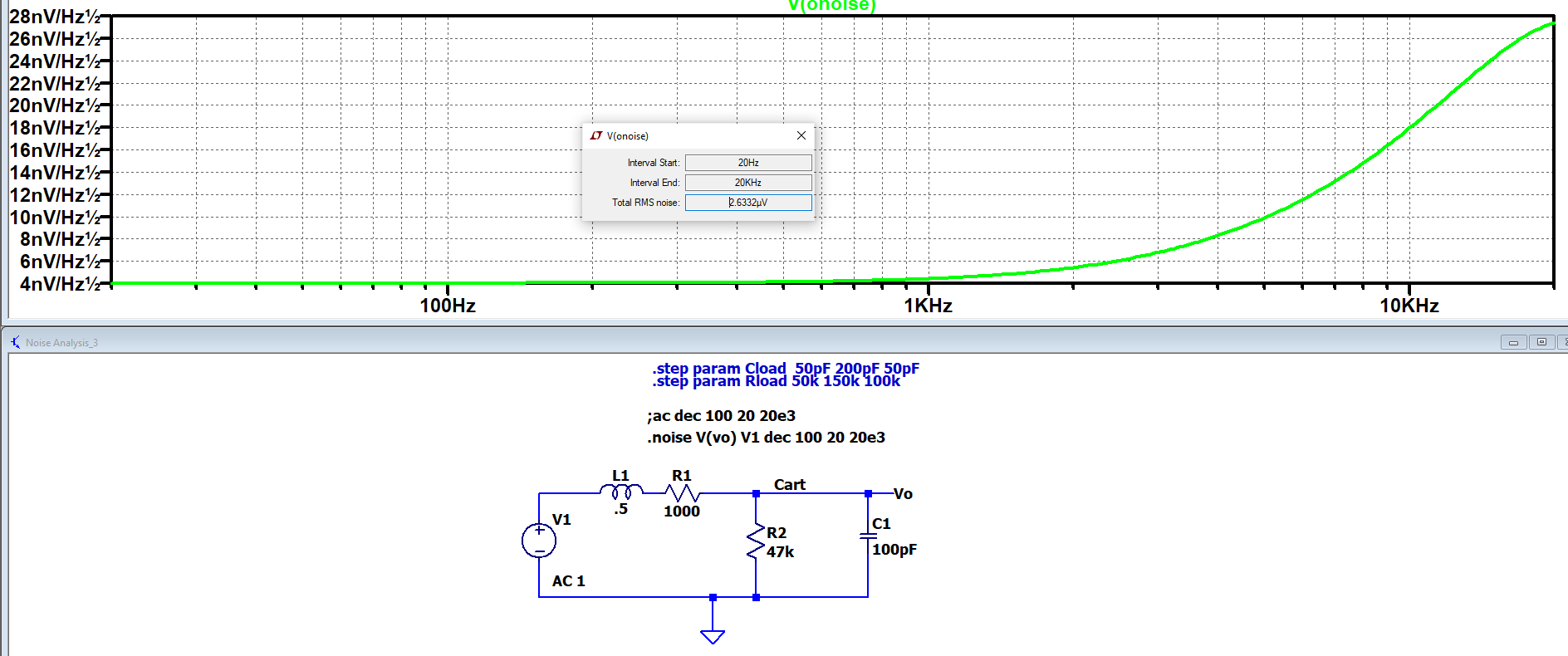

The old IHF standard A-202 (now CEA-490) required that the preamp noise be measured with a standard cartridge terminated with a standard load. The standard cartridge was 500 mH in series with 1 kOhm, (Shure M-75) and the standard load was 47 kOhms paralleled by a 125 pF capacitor. A noise simulation of the standard cartridge and load gives an A weighted noise of about 430 nV over the 20-20kHz bandwidth. That is about 78 dB below the standard reference level of 5mV at 1 kHz. That is about the best you can do with a noiseless preamp. Now Nick claims that with a non-standard cartridge and load he can get an SNR of 85 dB and it is the best. If I recall correctly, the SNR for a quiet record grove is about 60 dB. So what do you get for that extra 25 dB of SNR?

"Shouldn't you also be giving that noise an RIAA deemphasis? "
I did. The A weighting is just because the IHF standard requires it.

Moving on, this is the wideband raw input noise that the RIAA preamp will see - this does not include any amplifier noise voltage or noise current contribution. For a typical input stage (JFET or low noise bip), the total input noise will be around 3.1uV. Obviously, this noise is then severely shaped by the RIAA EQ.
