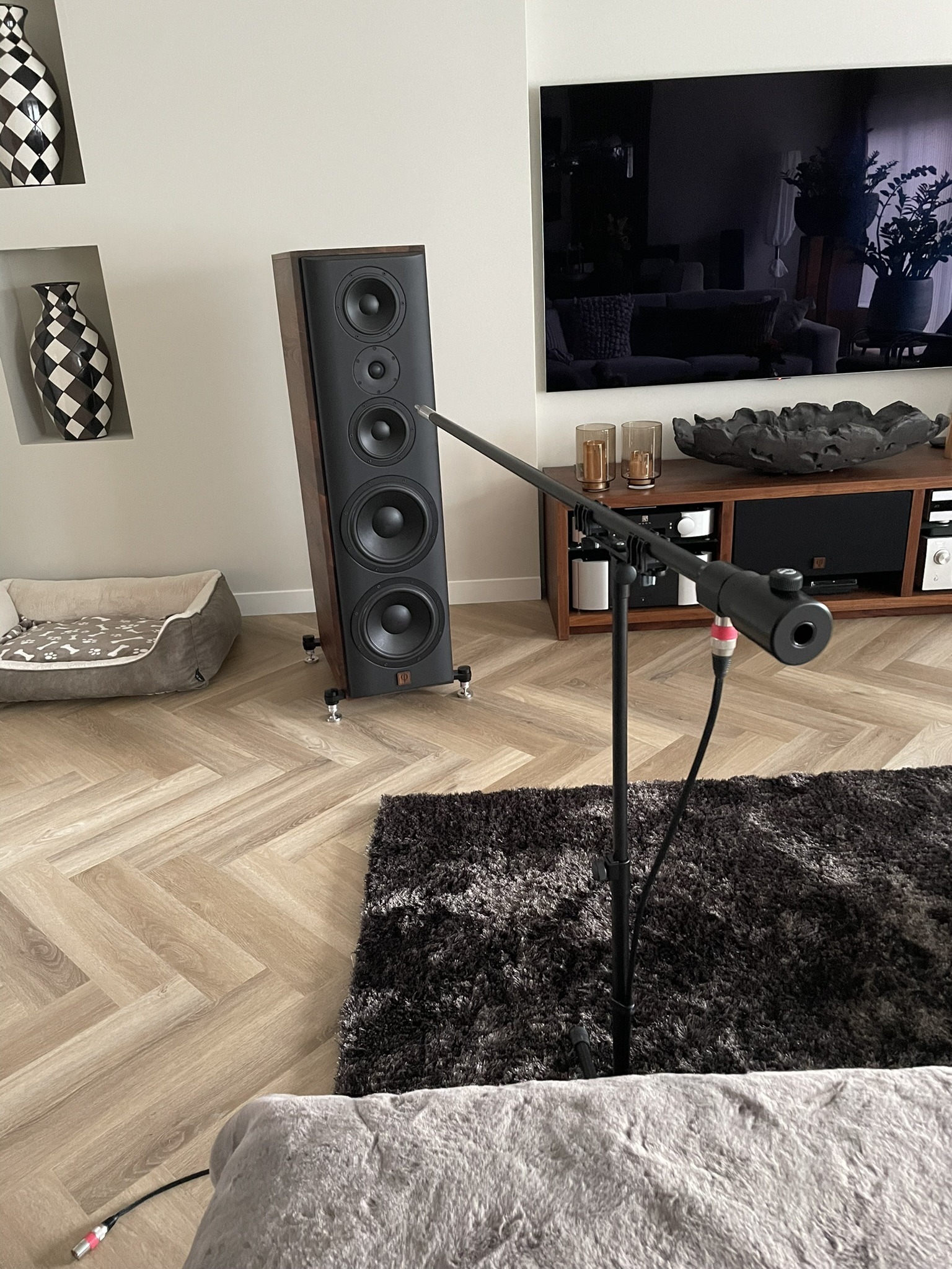

So, I bought an Earthworks M23R reference microphone.
This unit has an insane flat curve with a correction file that onlu has +/- 0.16dB of correction.

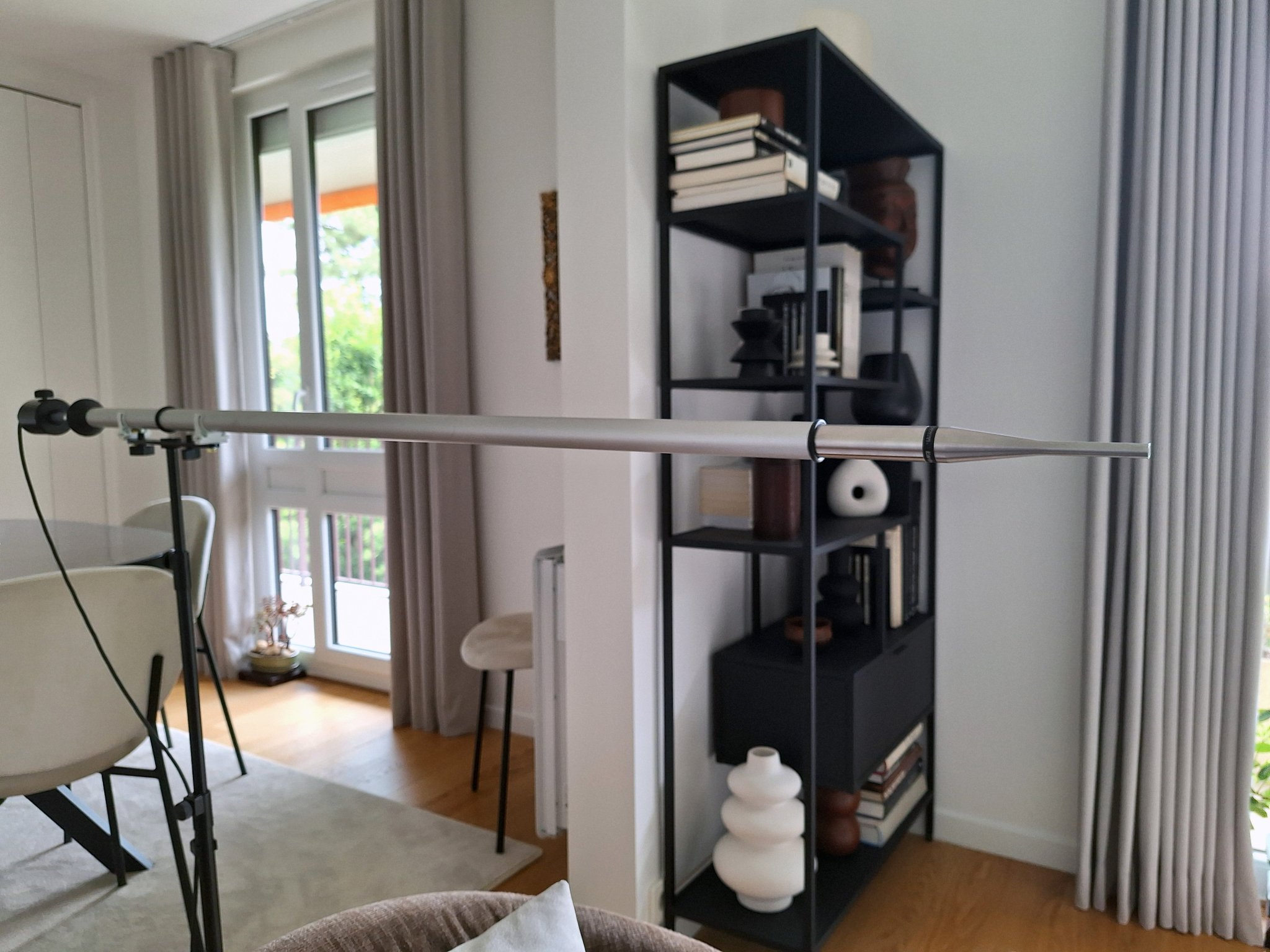

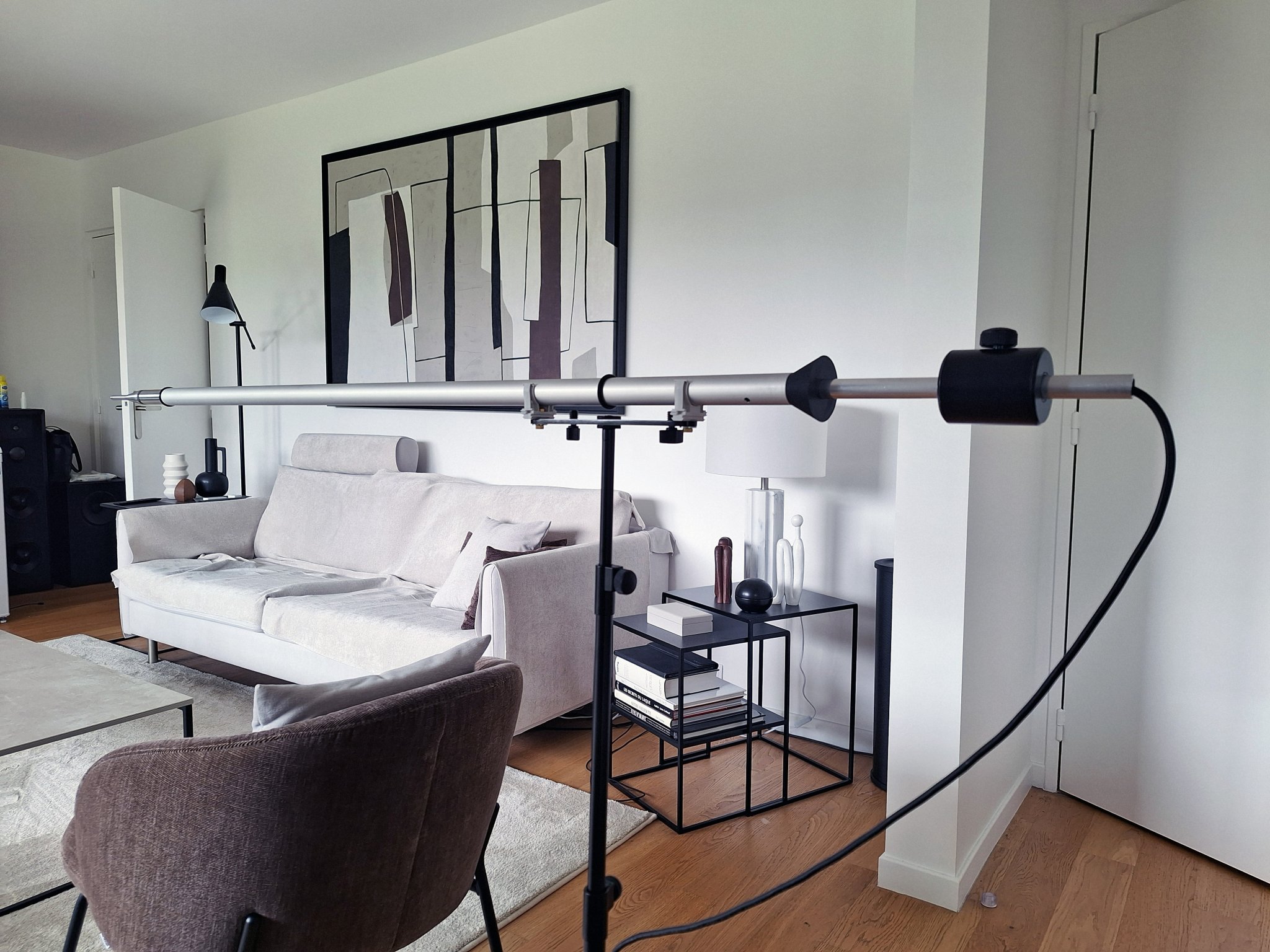

I designed a new mic stand by combining some parts of existing good available mic stand parts.
The reason not to go with a standard mic stand is the possible reflections the boom and mic-clamp can introduce.
So the ideal speaker measurement setup is kind of a floating microphone with nothing close that can cause reflections,
The parts I used are:

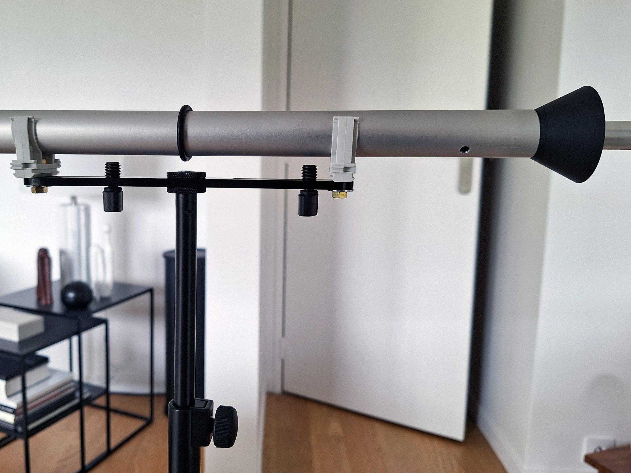

  • The main tube of a Gravity MS 23 XLR B Microphone Stand
  • K&M 252 Black standard mic stand where the main tube is build out of 3 parts so the vertical pole can go pretty low
  • An Adam Hall SDMSB 190 Stereo Bar that gets mounted on the K&M stand by standard 3/8” threaded bolt
  • A K&M 21105 Counterweight (that I mount to the mic tube with a rubber door stopper)
  • Some bolts, nuts, washers and 4 black electricity tube clamps.
And this is the result:

This was a bit of a fiddle as the M20 thread on the gravity tube was different then what I could get in a hardware store.
So I took an M10 hex bolt that I made thicker with tape and pushed that in the hole of the M20 end of the tube.
I also had a rubber doorstop that mounted snug over the M20 thread and that was in the end a nice enough construction to mount the counter weight dat I could fasten over the hex bolt head
Hope this makes sense (I rather leave all in place now it is still snug)

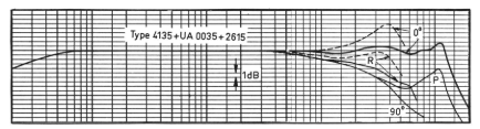

Not too difficult with a pressure transducer like a mike. You are above the internal vent frequency and below any acoustic resonances. That range can be tested with a coupler or a pistonphone ( not to 800 Hz) The problems start around 4 KHz with a 1/4" capsule. It gets complicated from 4K up and above 70 KHz the filter in the front limits the performance. Below is the spec for the B&K 4135 1/4". The solid line is no grid, the dotted one is with grid. The grid limits performance to 40 KHz.

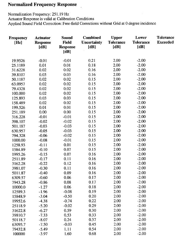

For what its worth here is a recent cal file for my 4135. The low frequency range is pretty flat. At 20+ KHz there are some fluctuations but for humans they are academic. The cal on this mike has not changed in 35 years. I will be using it to benchmark my calibration capabilities.
