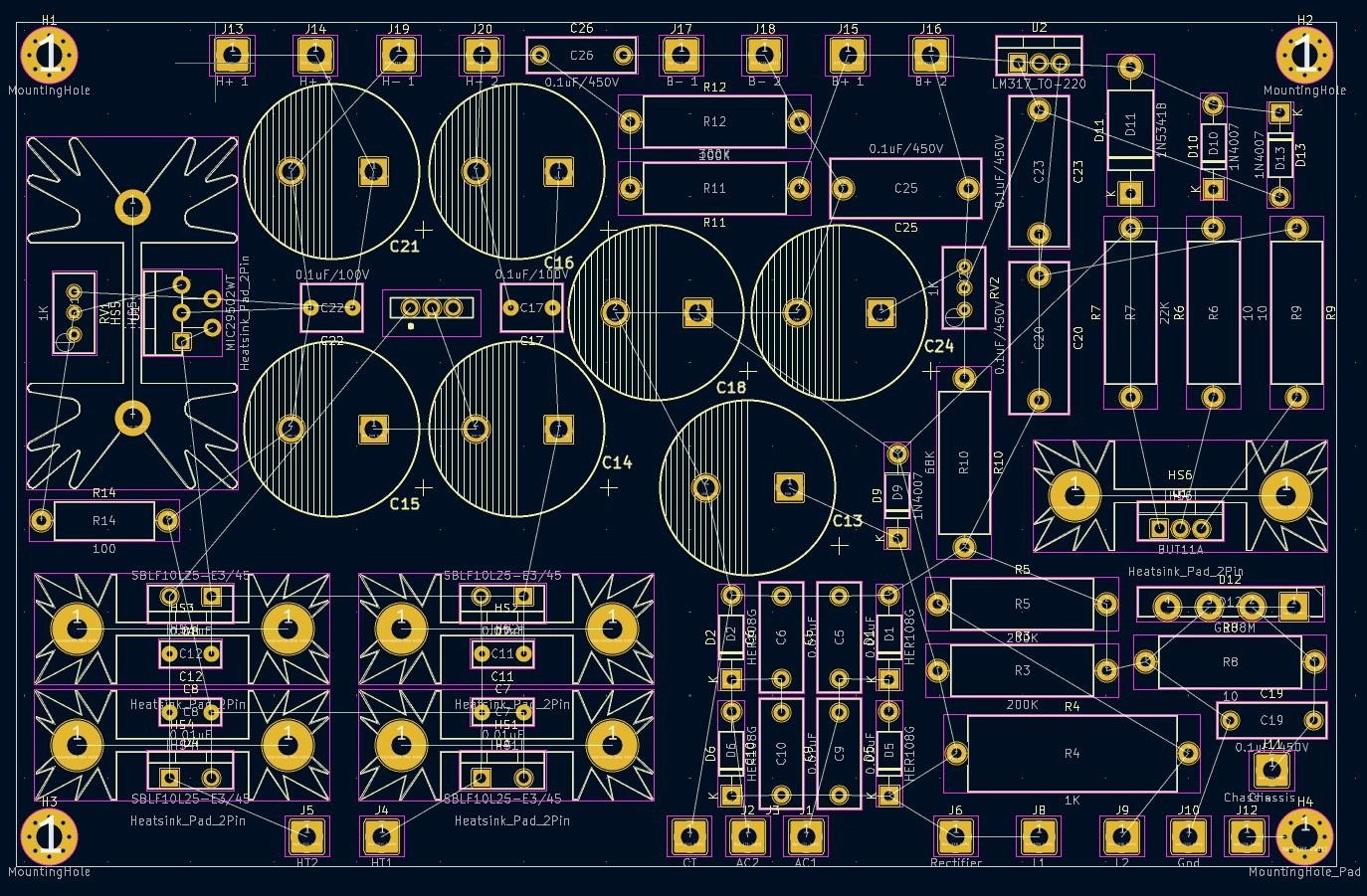

I've laid the components out on a board matching the size of the original board, which doesn't leave room for the snubber circuit. I am debating if it would be better to slightly increase the board size, for that, or swap the resistor footprints to vertical mounting and see if more space can be squeezed out of the existing size?
KiCad 6 didn't have a built in footprint for a 20mm diameter 10mm pitch capacitor, the one I found online didn't have a nice filled in spot for the negative side of the cap. As mentioned I am a novice at this, so I just drew some evenly spaced lines, but would appreciate if anyone has a source for a more proper looking cap footprint, or maybe there's some sort of repository of better footprints than what's built in?
My solder pads might not be the best choice either, I picked OD 3.9mm ones listed as "1.5sqmm_1x01_D1.7mm_OD3.9mm", honestly I am not sure what's really appropriate here.
If anyone has any thoughts on component layout I am all ears, so far I'm just matching the original.

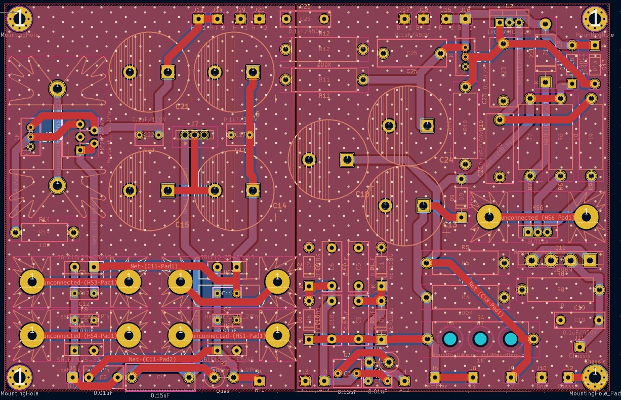

Tentatively thinking about this for a grounding layout. I'll get back to it tomorrow.
The left side is a ground plane on the top and bottom stitched with ~5-600 some via holes, elevated by C26, R11, and R12 to 1/4 B+ voltage. On the right side is a top and bottom ground plane stitched together with anouther ~5-600 via holes.

You'll pay dearly for all those vias. Run a quote and see.
I just generated two sets of gerbers, one with vias, one without. I then loaded both into jlcpcb, they are the same price for 5 boards, 20 boards, etc, options selected were default of 1.6mm thick, 1oz copper.
That said, deleting the vias is a trivial task so I will try to provide gerbers in both formats in case other PCB houses are going to charge extra people on vias.
I believe if you choose the option “tented vias” they are covered with solder mask which eliminates the chance of solder bridges when soldering components close to an exposed via creating a short to gnd.
Looks like KiCad by default has tented vias, I created another gerbers with no tented vias, still the same price on JLCPCB so perhaps they are just kind with pricing over there.
Good to know, well regardless in the interest of making sure there are options for everyone without people needing to go through KiCad, I'll try to remember to generate gerbers with vias, un-tented vias, and no vias. Tomorrow I'll get cracking on making sure the silk screening looks good, and we'll take it from there.

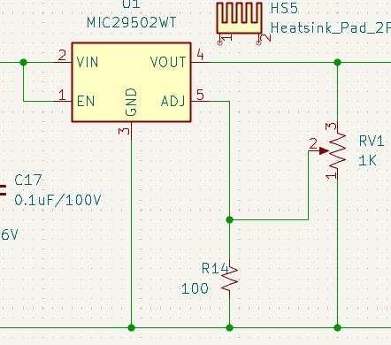

For the trimpots in both HV and LV regulators, these are shown wired as variable resistors. Most variable reg circuits will have the trimpot wired as a potentiometer, with one end of the pot and the wiper connected to GND. This way if the wiper goes open circuit, the output/Adj is still referenced to GND. With the way it is currently drawn, if the wiper goes OC then the output will rise to the input voltage with damage likely to the reg chip and connected circuit (tube filaments for instance). Also normal convention is to have a fixed resistor between out and adj pins with the trimpot from adj to GND.

I am not keen on vertically mounted resistors - heat rises and the high point of the vertically mounted resistor will run hotter than the lower end. Horizontally mounted resistors with 3W types spaced off the pcb will at least be evenly heated across the resistor body.

Tented vias are good and should not add to the pcb cost at JLCPCB. Definitely need 2 ounce copper especially for the tube filament currents that might be required. Might be wise to increase the track width on the filament supply.

I'm hoping I follow your comment on the trimpots correctly, is the fix as simple as just terminating pin 1 on both of them to the ground like in this picture?

Yeh the trimpot is as I said, but normal practice is to have a fixed resistor between Vout and ADJ pin and the trimpot in the lower position with the wiper (pin 2) and pin 1 to GND. Or to be more safe a fixed resistor in place of the pot calculated for the exact filament voltage. In your circuit with 100 ohm resistor between Vout and ADJ, the bottom resistor would be 408 ohms based on the IC ref volts as being 1.240VDC, for a 6.3VDC supply and 916ohms for a 12.6VDC supply. Use the nearest 1% value = 407ohms and 910ohms.
