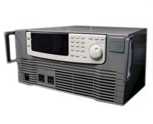

Like many present here I spend (squander, fritter etc 😱) far too much time on internet sites like this one....eBay is another.
In a nearby suburb I spied one of these.
Kikusui PCR-500L Variable AC/DC power supply for $221.50, and I just had to have it. 😉
This thing is physically a beast..430 wide, 217 high, 550 deep and 30kg.
Electrically a beast also...it is programmable via GPIB to output 0-300V AC 1Hz-999Hz 0.3% THD, 0-420V DC, and a combination of both, ie it can output regenerated mains AC with DC offset !.
Via software interface arbitary waveforms can be defined, including clipped sine, sine with noise, square, rectangular, triangle, and waveform captures from a DSO.
Multistep sequences are definable also, each step being pretty much any waveform or voltage level desired.
I am interested to find out if the clean output improves my sound system ala hifi mains regenerators/filters.
The other usage of course is to simulate 'dirty' mains supply with glitches, phase steps, noise, distortion etc and measure effects on typical audio gear, and as an aid to optimising power supply arrangements.
All in all, this looks to be a very useful item in the 'shed'.
From what I can glean, the output stage is pretty much a standard (ruggedised/protected) audio amplifier, with definable input.
Anybody here have experience of this kind of gear, or thoughts toward a DIY version with soundcard input.

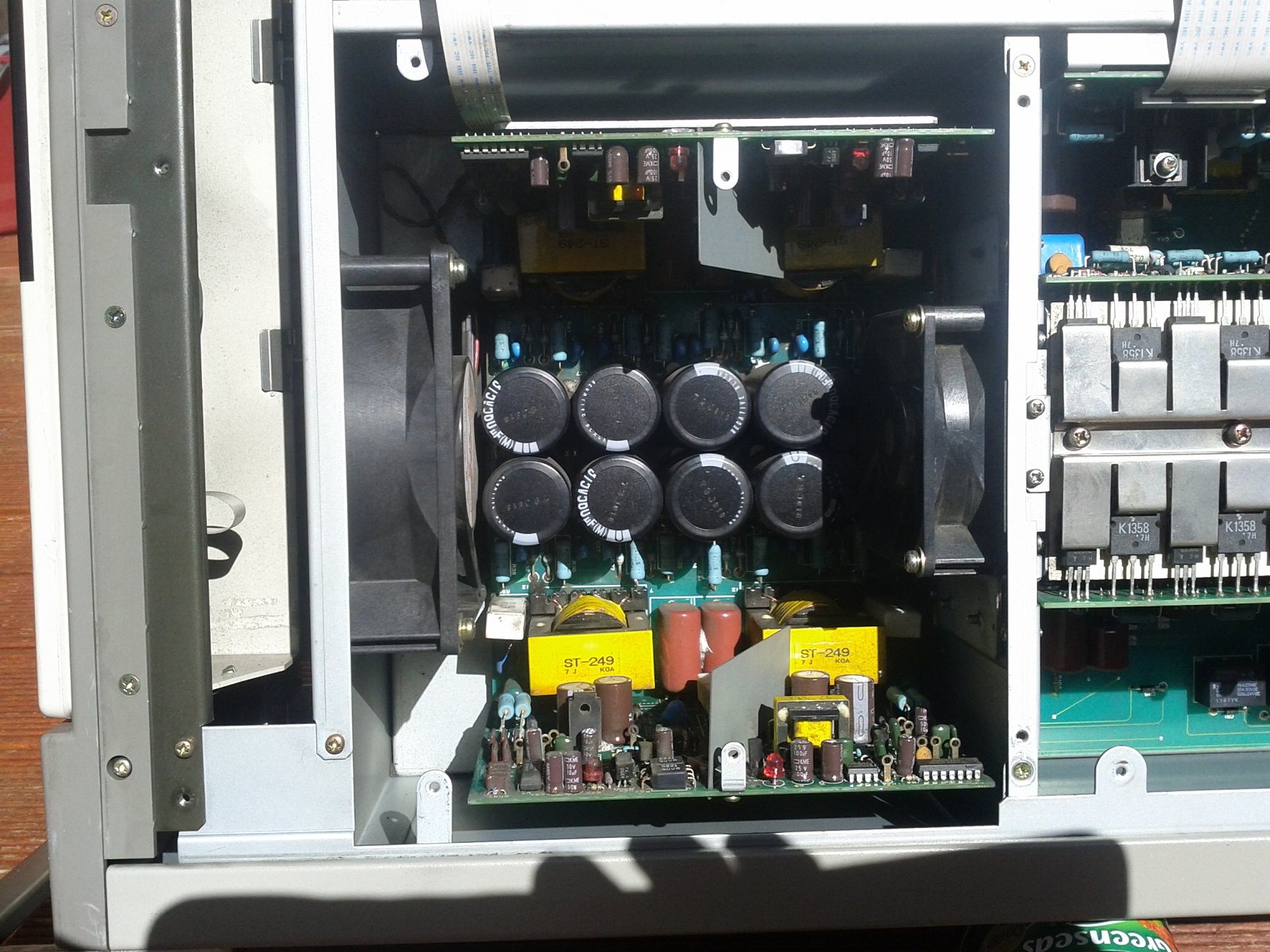

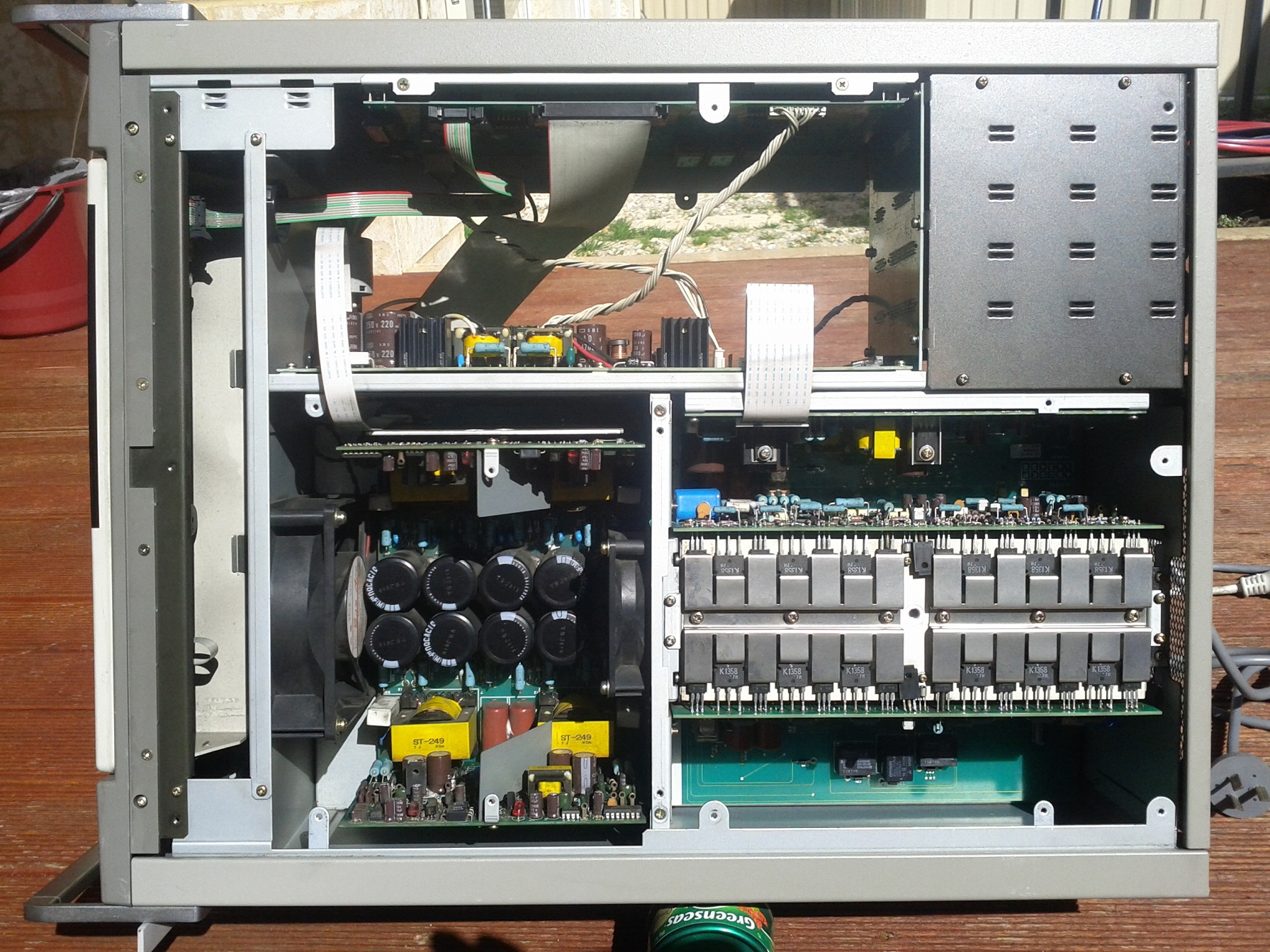

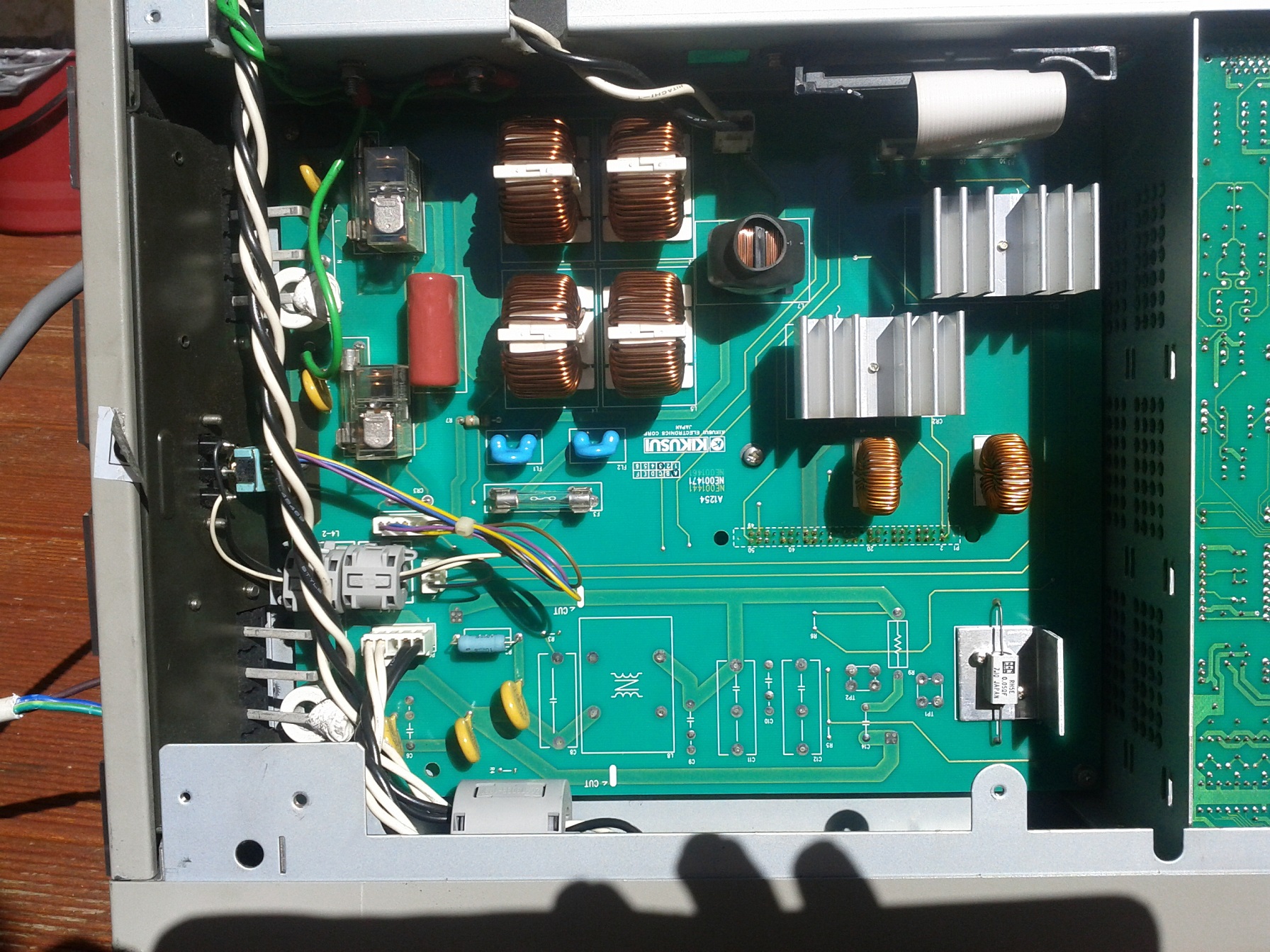

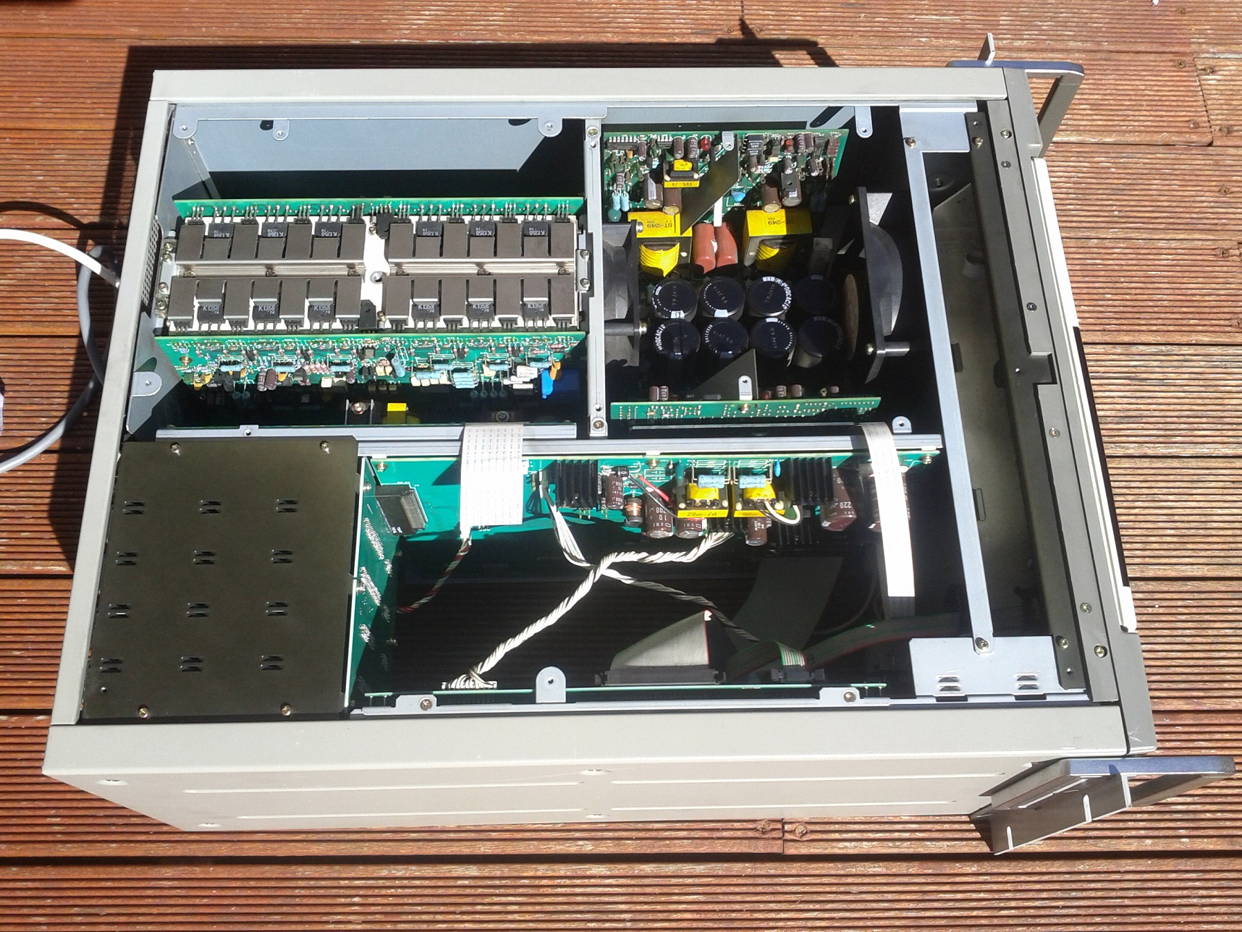

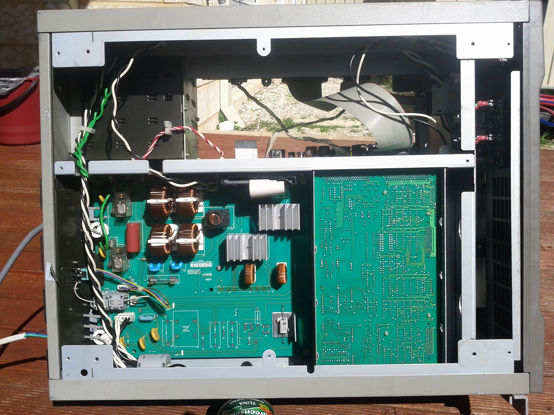

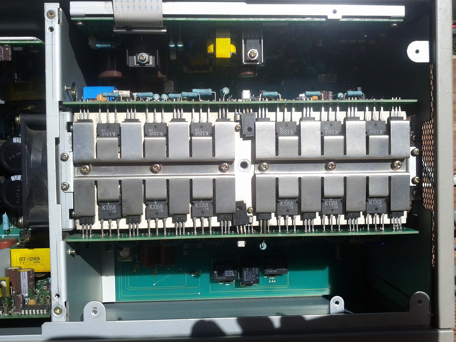

It looks like the block diagram is two independent swps stages (B+ and B- ??) feeding the output stage.
No output transformer evident.
Dan.
That makes sense, with a couple of SMPSs you can mix AC and DC outputs easily.
Man, there's enough stuff there to build a nuclear power plant 😉
jan

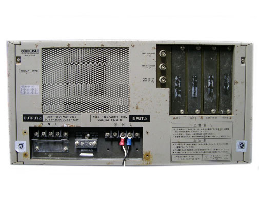

The outputs are marked A, N, and E. I haven't checked yet but I expect the N connects to the E........ That's how AC with DC offset must be.
I will find out tonight.
Dan.
