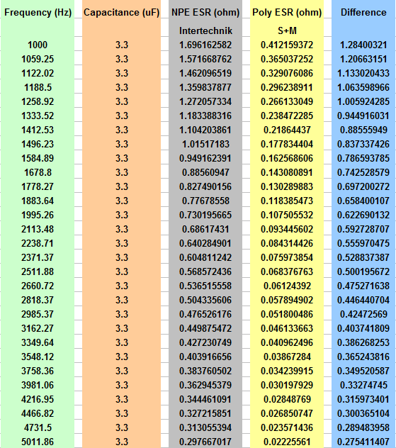

ESR measurement of a NPE vs. MKP
I have had an idea to check how NPE ESR may keep up with a poly type so I gave myself a little work to satisfy curiosity. Intertechnik states for glatte folie caps a tangent delta of 0,023 at 1 kHz. One might assume this to be a constant value, and it appears that in this duel the difference is not all that great but evident. A small cap value like this will have greater influence at higher frequencies so the 1 kHz ESR spec is not very much detrimental.
