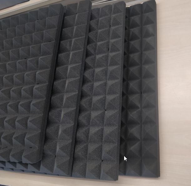

I am coating the interior of a speaker enclosure with these bitumen damping pads:
Solen Electronique Inc. | DAMPING PAD
The pad have a thick easy to remove plastic film under the self adhesive side, but on the other side, there is a very thin plastic film that is very hard to remove.
If I try to peel it, only small sections can be peeled peel off at a time, as the film has no elasticity.
Is it meant to be removed ?
I would prefer to leave it, because the pads have an unpleasant bitumen smell, and it would save the trouble.
On the other hand, felt needs to be glued to the pads, and perhaps the film is not a great surface.
Suggestions would be appreciated.
