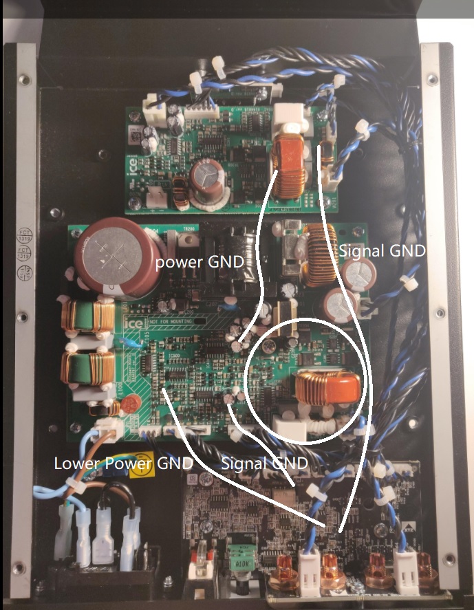

Inside pics of the XTZ shows some sort of active circuitry, but no idea what it is more specifically. XTZ EDGE A2-300 - Pictures from Inside | Audio Science Review (ASR) ForumI have question on the "adjustable gain" thing: what do you think it is in the original product? Is this simply a voltage divider potentiometer on the input path, or something else? XTZ A2-300 is based on Icepower 300 AS. As far as I know, it does not have any built in gain regulation.

I am thinking why the xtz's engineer put one channel together with the power supply, while another channel is standalone.
I doubt that they might wanted to go for dual mono for better performance in beginning but end up the chassis are too small to fit?
This is how the ICEpower modules are designed so you can do modular 2/3-channel designs using just one PSU. The only XTZ decision here is if they wanted to pay a fair bit extra for a full dual-mono design and that answer was obviously "no" 😀
I see... i wouldn't do that because it might end up using much more time to solve the ground loop issues later on. 😱
If you were starting from scratch then yes. However, when you buy a pre-made amplifier as a subassembly from a manufacturer that is able to provide you with design-in support and good documentation on what to do, then that concern is mostly out the window.
And if you can get (say) 90% of the performance for a (say) 80% cost-reduction on the BoM for second channel, then that decision becomes extremely easy 😀
Remember that if you build one unit then the math looks different, but if you can amortise your R&D efforts over thousands of units sold, then even a small cost saving on the final product becomes well worth fighting for.
This mechanism drives a lot of decision-making for manufacturers and it also informs things like how IC datasheets are written, because those small cost savings are part of what design engineers have to look for 🙂
