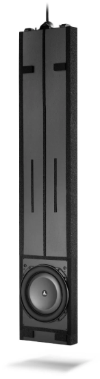

It's not cheap, but it's a thing.10" max
www.jlaudio.com/collections/home-audio-fathom-in-wall-subwoofers/products/iwsv2-sys-113-home-audio-in-wall-subwoofer-systems
Fathom® IWSv2-SYS-113
13.5-inch (345 mm) In-Wall v2 Powered Subwoofer System

From the installation manual on Support page:I presume that means opening the wall?
"The Fathom IWS enclosure is designed to suspend from a single anchor
point inside the wall cavity of 16-inch, on-center stud (aluminum or wood)
construction homes. Once installed, the enclosure will “hang” snugly within
the wall cavity. The enclosure has various spacers and padding applied to
specific areas, allowing it to only make gentle contact with its surrounding
wallboard surfaces."
Spec page says:I wonder how high in frequency that goes
"Frequency Response (Anechoic) 26 Hz - 101 Hz (± 1.5 dB) -3dB at 25 Hz / 112 Hz -10dB at 22 Hz / 150 Hz"
and
"Filter Slope(s) 12/24 dB/octave
Filter Frequency Range 30 Hz - 130 Hz"
