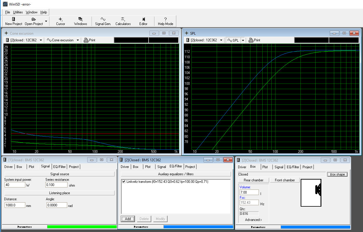

BMS falls sharply after 400hz, in the spec it says small reflex box achieves F3 at 103HZ, but I don't want reflex box, especially for midrange driver (am I wrong?). Tried simulating with winisd, and it could get to 200hz F3 in about 5-15L sealed box. Is this box not too small? And could it be EQed to 80-100Hz F3 without compromising sound quality, rising distortion too much?

I tried simulation with WinISD, after LT EQ, excursion looks within limits, even at 40W. Only thing still bothering me is box size, in simulation it is 7L, is it OK or WinISD not calculating this properly? Maybe box size should be increased as it is going to be EQed?

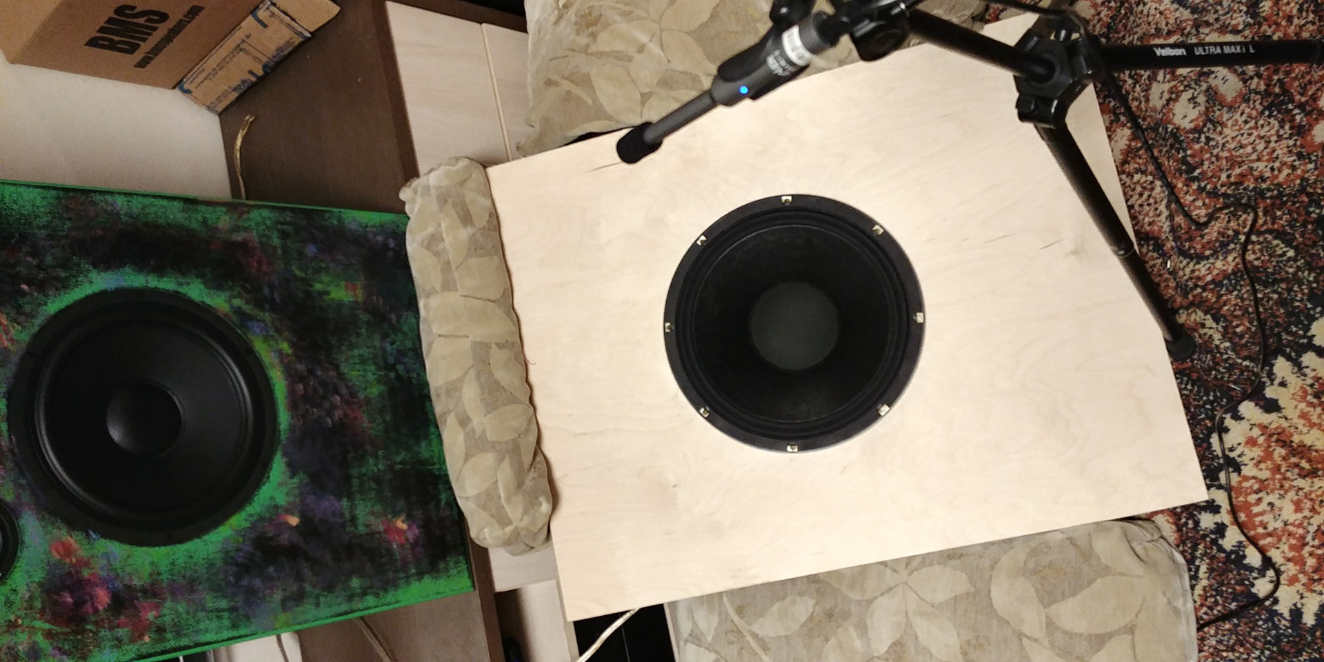

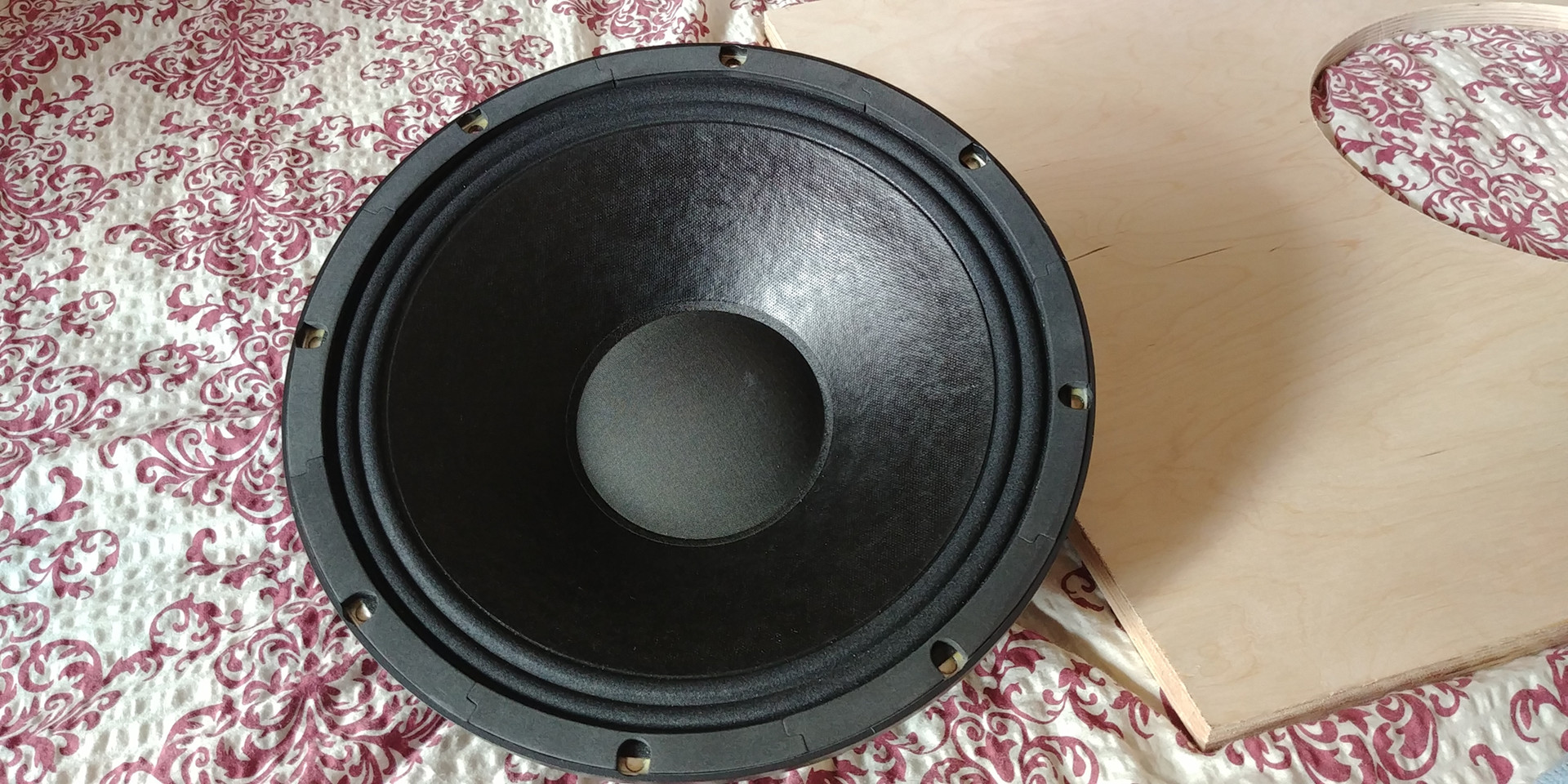

Finally have the drivers, took a while, were out of stock, plus some issues with shipping.
Put one of them on a plywood baffle for quick listening, did some basic measurements, used minidsp to add crossover LR24 at 1100hz and shelving filter to compensate for falling HF. It sounds great, as this is my first speaker with compression driver, was afraid of that harshness people often talk about. But no such thing, it sounds very accurate especially with some electronic music, it has sort of "attack/dynamics" if its right word, I don't think my FAST system can compete.
And they can go really loud, was not aware how loud I was listening until I added bass from my FAST speakers, woofer couldn't keep up.

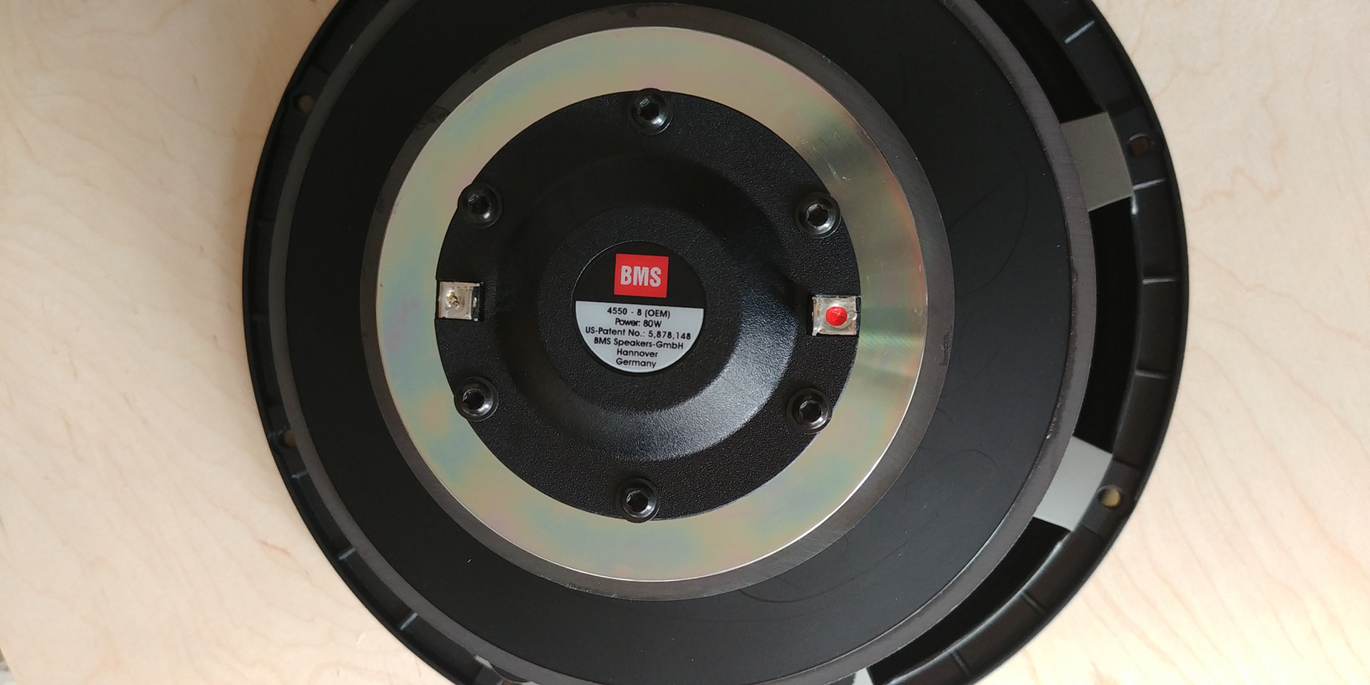

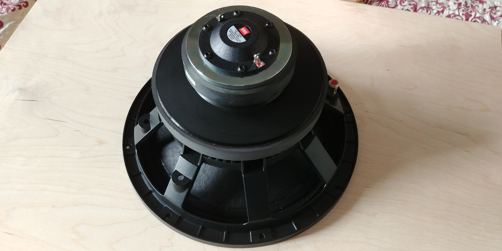

Is that HF driver a screw-on detachable? Just curious to understand why its a double magnet system.
I am not sure how they are put together, did not try to unscrew it. But HF driver seems to be BMS 4550 which can be bought separately.
Probably done because the most famous coax of all has them 😉: http://www.lansingheritage.org/images/altec/catalogs/1975-home/page13.jpg
I guess a longer throat make more sense than trying to achieve phase alignment where it’s not possible anyway. Interesting for sure. I guess it’s not detachable then but bolted somehow through the LF magnet system and perhaps inside the spider.
