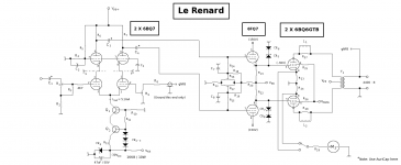

Been there; done that: Le Renard
The 6BQ6s, especially, make great audio finals, even though there is no mention of such use mentioned anywhere in the spec sheet. These sound as good as the 6V6, but can handle a lot more power, and some spec busting doesn't hurt at all, but improves the sonic performance.
The 6BQ7s also make excellent cascoded LTPs. This is another type that doesn't mention audio applications, and it does have some squirrelly plate characteristics (undocumented variable-u feature?) that makes it a bit more difficult to find a good audio load line. However, for this particular application, it works quite good.

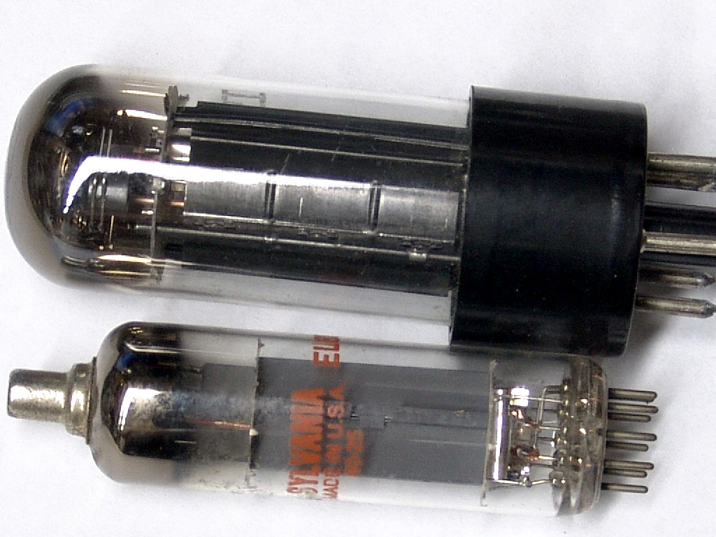

Most readers here know that I have been playing with TV tubes since the 60's when they were free for the taking at the local trash dump. I have been going through my tube collection sorting out the stuff to keep, and the stuff that must find a new home. In the process I have found a few oddities that even I didn't know existed.
Ever seen an EL84 with a plate cap????? Yeah I didn't think so until I had it in my hand. This one is made in the USA by Sylvania and has a 1980 date code. It is an EL804. The specs reveal that it is really a 6CW5/EL86 with a plate cap.
Most of us here know by now that the venerable 6L6GA was repurposed as a transmitting tube, the 807, and a sweep tube, the 6BG6GA. Do you know that it was also stuffed into a 6V6GT sized envelope and sold as a sweep tube for smaller TV sets? Would you want to find some NOS black plate RCA 6L6GA's in a tiny bottle with a different pinout for $3 each?
