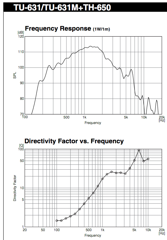

Andy,
Just for reference, these types of loudspeaker components are normally referred to as "compression drivers", as they use a compression chamber behind the diaphragm.
In over 40 years in the business had never seen the term "pressure driver" used before seeing your thread(s) and looking at the old Vitavox literature.
1) All compression drivers can be used on exponential horns.
"P.A." compression drivers like the TOA you are considering have a much lower resonant frequency than most current thread on drivers that are designed for use above 1000Hz. The TOA TH-650 or TH-660 are folded ("re-entrant"/"reflex") horns similar to your straight exponential horns.
The straight exponential horns have a bit smoother frequency response, but a lot more wind resistance, and the depth obviously is a disadvantage in many locations.
With a steep crossover filter at around 300 Hz and some equalization, your horn with those drivers should provide flat response from 300Hz to 6kHz.
2) "A bit" would be an understatement, that height difference will lessen the near to far SPL variation by around 20dB, and eliminate most overlap areas that would be perceived as echos.
3)Tapped transformers are a huge help for this type of work, each of the 5 taps on the TU-631M reducing level by 3dB, making it easy to reduce the level of a horn that covers a lesser distance, while still using single cable runs.
Art
