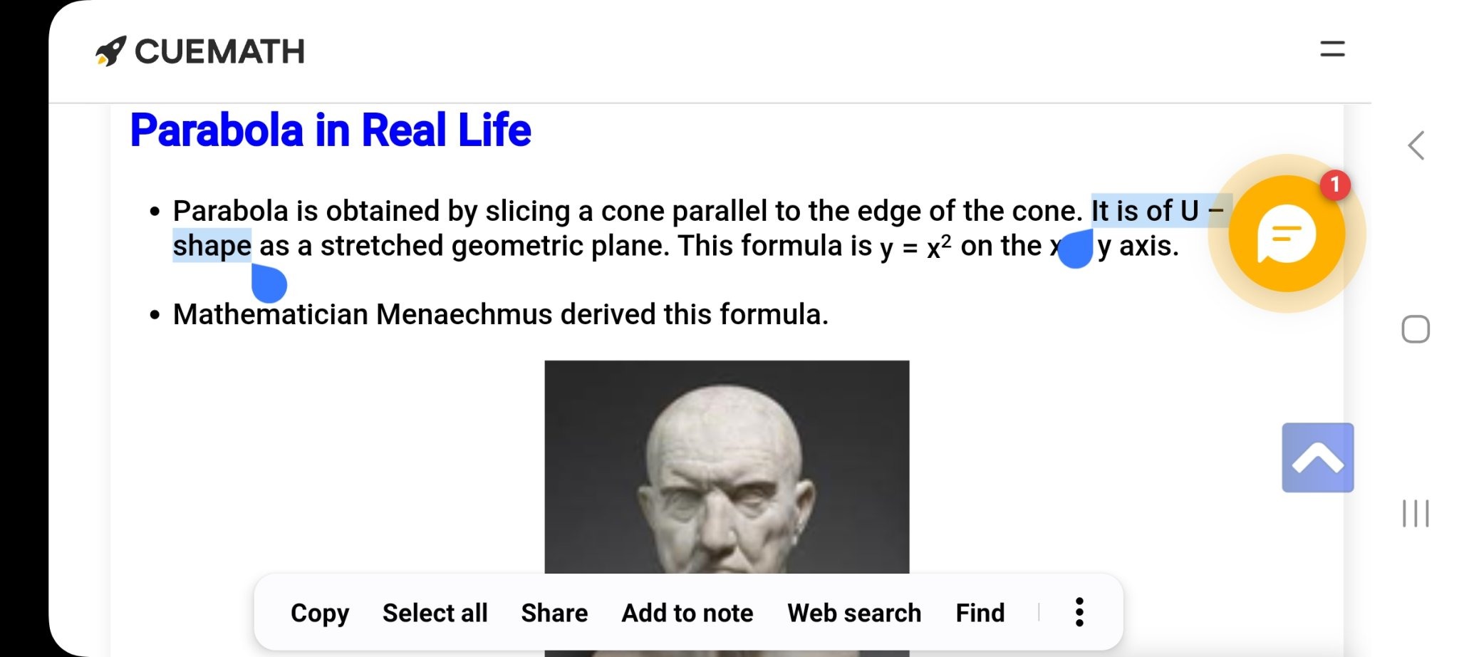

but on the other hand it is okay for a parabolic horn to look nothing like a parabola. In the case of the parabolic horn you are in fact agreeing that it is the linear area expansion rate that defines it.
A parabolic ENCLOSURE can have ANY flare rate as long as 2 sides run parallel to each other.
A U has 2 parallel sides.
