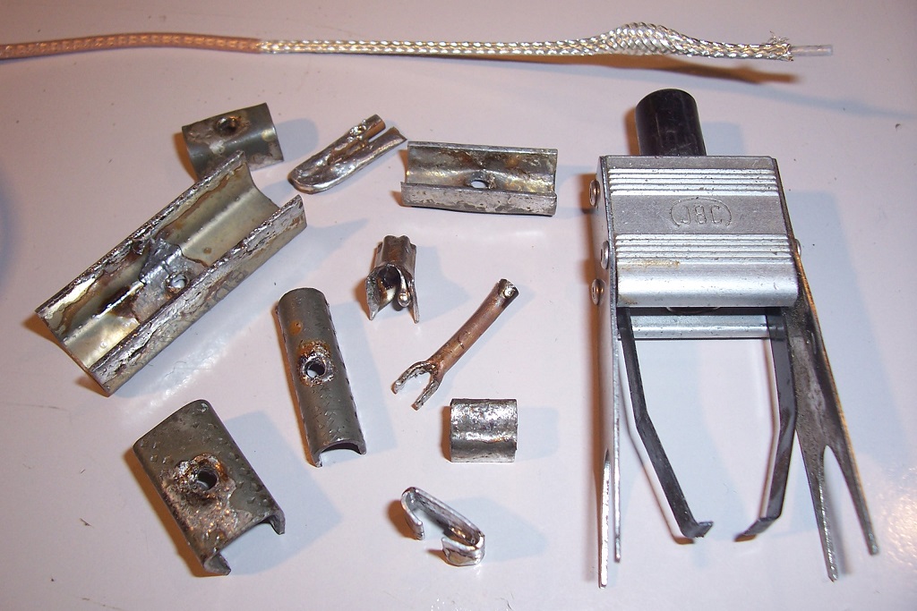

In such cases, I often make an improvised tool from copper sheet (1mm or so).
It is soft, easy to cut with a shear, easy to form, stamp or punch with the tools of a small, basic mechanical workshop, and once adapted to the right shape, it is easy to tin and with a good thermostat-controlled iron, you can heat and melt one or two dozens of solders simultaneously, gently, and in a very localized way.
Tomorrow, I'll post some example pictures.
Some are used only once, but most can be used on different patterns.
Once all the solder points are melted, the component falls almost by itself, like a ripe fruit.

Here they are:In such cases, I often make an improvised tool from copper sheet (1mm or so).
On the left, various examples made from copper sheet or tubing.
On the right, a spring-loaded gripping tool for DIP, through-hole IC's: before the heating, you install it on the components side, and it exerts a permanent traction on the component.
As soon as the last solder is melted, the component is extracted automatically.
On the top is a stripped coaxial cable having a silver-plated braid.
When it is freshly stripped, the braid acts as a "tin magnet", more effective than conventional solder wick, because of the affinity of tin for silver.
A drop or two of flux, and you can remove the tiniest remains of solder
