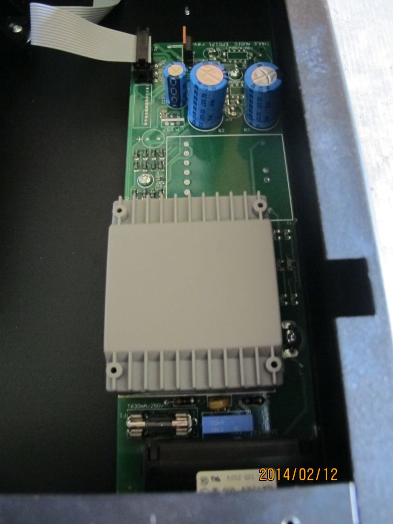

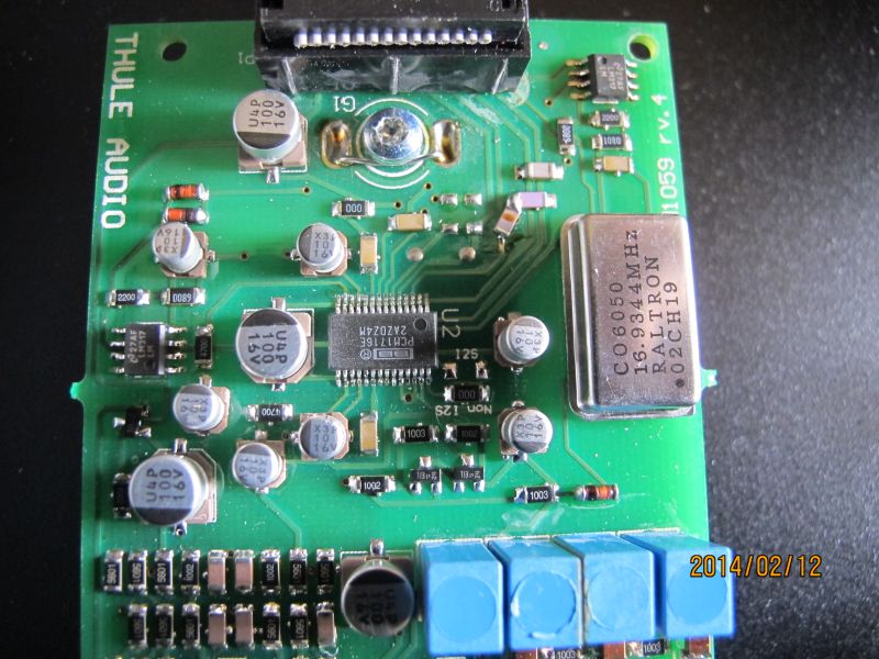

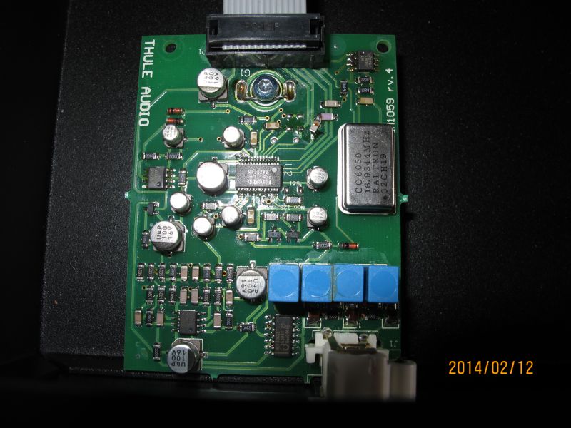

Hi guys. I was given a Thule spirit 100 cd player with some issues. It loaded and read the disc ok but there is a few different noises ie hum in the back ground, also static sound which intermittently dropping off. I did cleaned the laser but made no difference. I would like to fix the problem and perhaps upgrade the clock later. Please advise where i should be looking or do measurements to trouble shoot. I can only see some brown discoloration btw the blue block caps( marked 1uF). TIA.

No suggestions guys?. The main analog board is all smd stuff and no schematics so i am not sure where to start. Distorted sound could be from the D/A chip? or surrounding filter caps?.

Not meaning any insult, but this player is barely better than junk. It's built as cheaply as possible, with just enough "extra" to make a feeble attempt at marketing it as a high end piece, i.e., the TCXO clock, 24/96 dac chip(albeit the cheapest early in format PCM1716), and, well, nothing else. I would consider it barely worth repairing, let alone upgrading. The symptoms could be caused by the cheap few thru-hole lytic caps on the supply board, by any or all of the SMD lytic caps on the audio board, by a defective PCM1716 dac chip, or by bad output opamp(can't make out the #, but that 14pin smd chip near the jacks is placed like a quad opamp for output stages), or by a combo of faults of above. Unless it turns out that replacing the power supply board lytic caps cures it, it would not be easy to track down the problem(s). I would personally give up after replacing the supply caps if they didn't fix it, and use the quite nice power transformer & TCXO clock for more worthy projects, and save the cheap but reliable Sony laser/mech for the next player needing it.

Thank you Stephen. My gut feeling is the same when i first opened up the lid. I am not confident with working on smd parts esp without the schematic. I certainly would not want to buy the schematic for 30euros if it is not going to make head waves. I tried to run the player with external DAC and the distortion is much better but still some noise(crackling) but only on the right channel. I would go ahead and change the PSU caps to see if it makes any difference.
