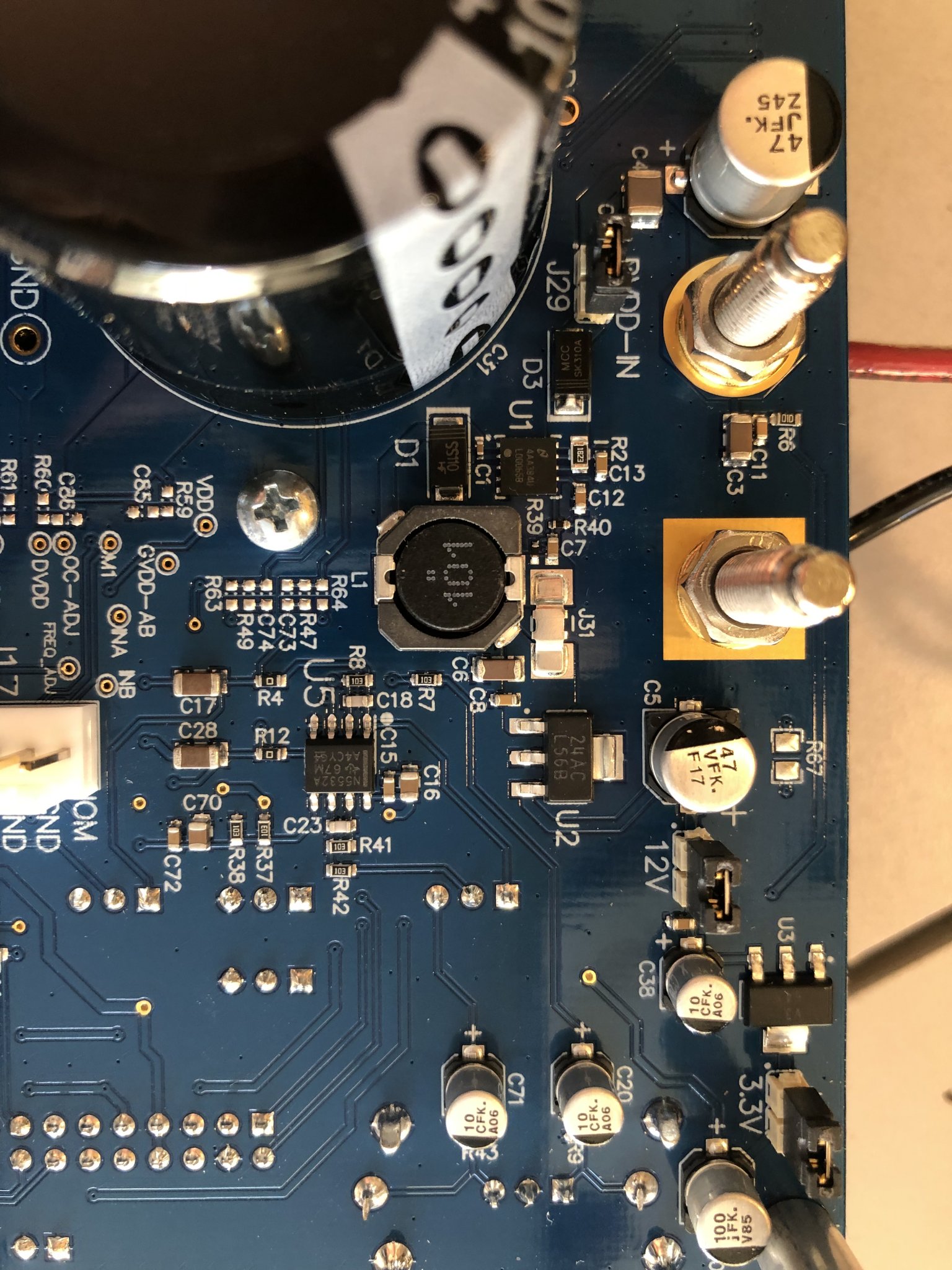

The things that go bad on these amps are usually the 15v DCDC buck converter U1 which is then regulated down to 12v and then again to 3.3v. The LDO's hardly ever fail unless over-voltage driven. Do you have steady 12v and 3.3v? This is indicated by two green LEDs. Sometimes the bootstrap cap C1 (o.047uF 100v X7R) on the buck converter goes bad so replace that to get the 15v output U1 working.
If the 12v and 3.3v LEDs are good, the other place to look at are blown bootstrap caps at the amp chip output. These are C27/29 & 52/54 0.033uF 100v X7R MLCC caps. Measure with an ohm meter across these and if one is shorted, replace it. Look for signs of burning.
Finally, the last thing that can be bad is the TPA3255 chip itself. If you have a hot air desoldering tool, remove the chip, clean the excess solder from the pads with copper wock, and replace with a new one using solder paste and hot air for $12.
That is about it.

Thank you very much for that easy to understand explanation. It gives me hope to resurrect the unit.The things that go bad on these amps are usually the 15v DCDC buck converter U1 which is then regulated down to 12v and then again to 3.3v. The LDO's hardly ever fail unless over-voltage driven. Do you have steady 12v and 3.3v? This is indicated by two green LEDs. Sometimes the bootstrap cap C1 (o.047uF 100v X7R) on the buck converter goes bad so replace that to get the 15v output U1 working.
That is about it.
I will go through the steps you just described, beginning with the first one. I do not have extensive desoldering/soldering experience, let alone SMD soldering. However, my brother-in-law used to work on SMD board as his primary job. I will ask him if he can do it for me.
Thanks again, that is an excellent help!!!

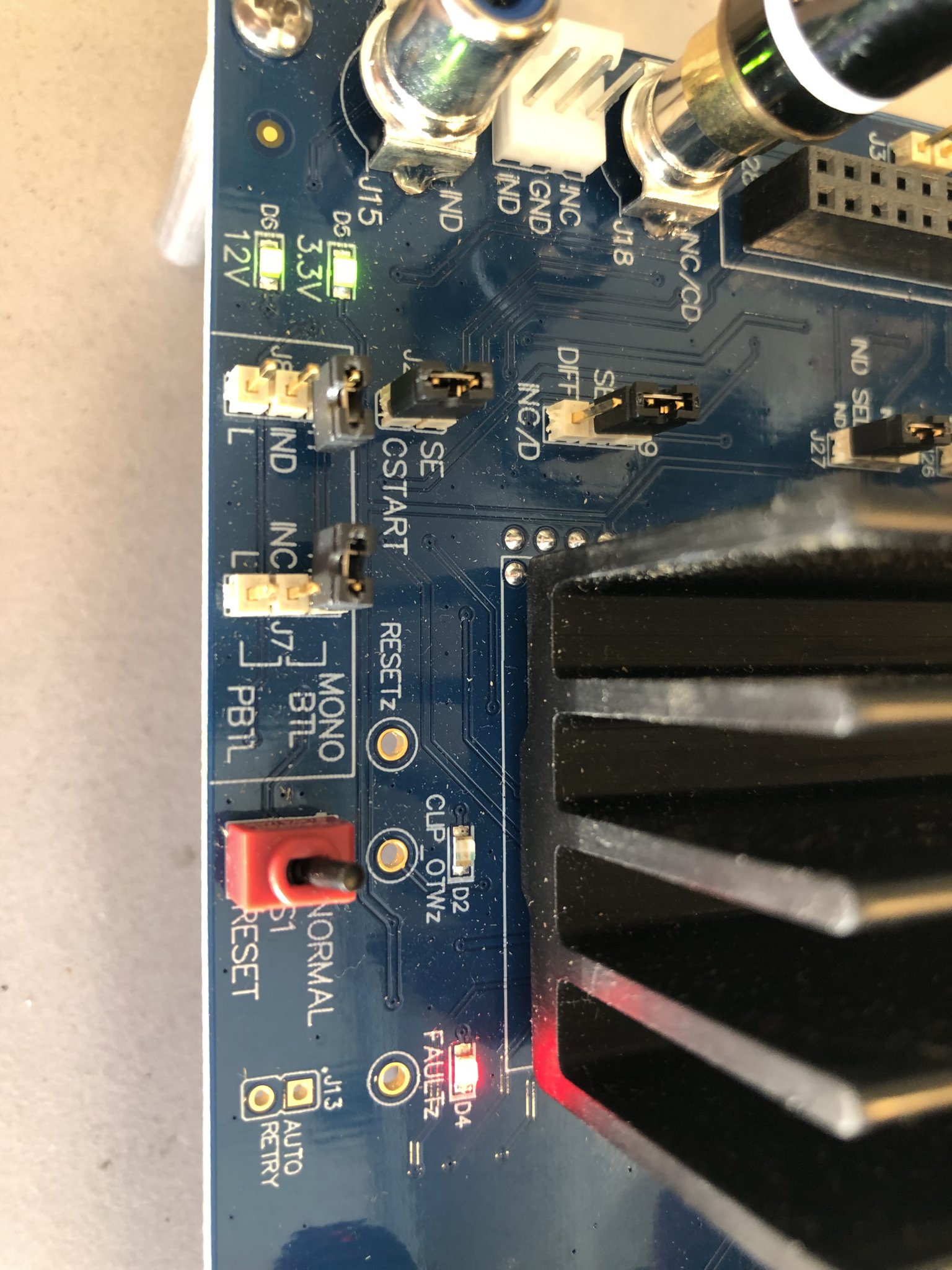

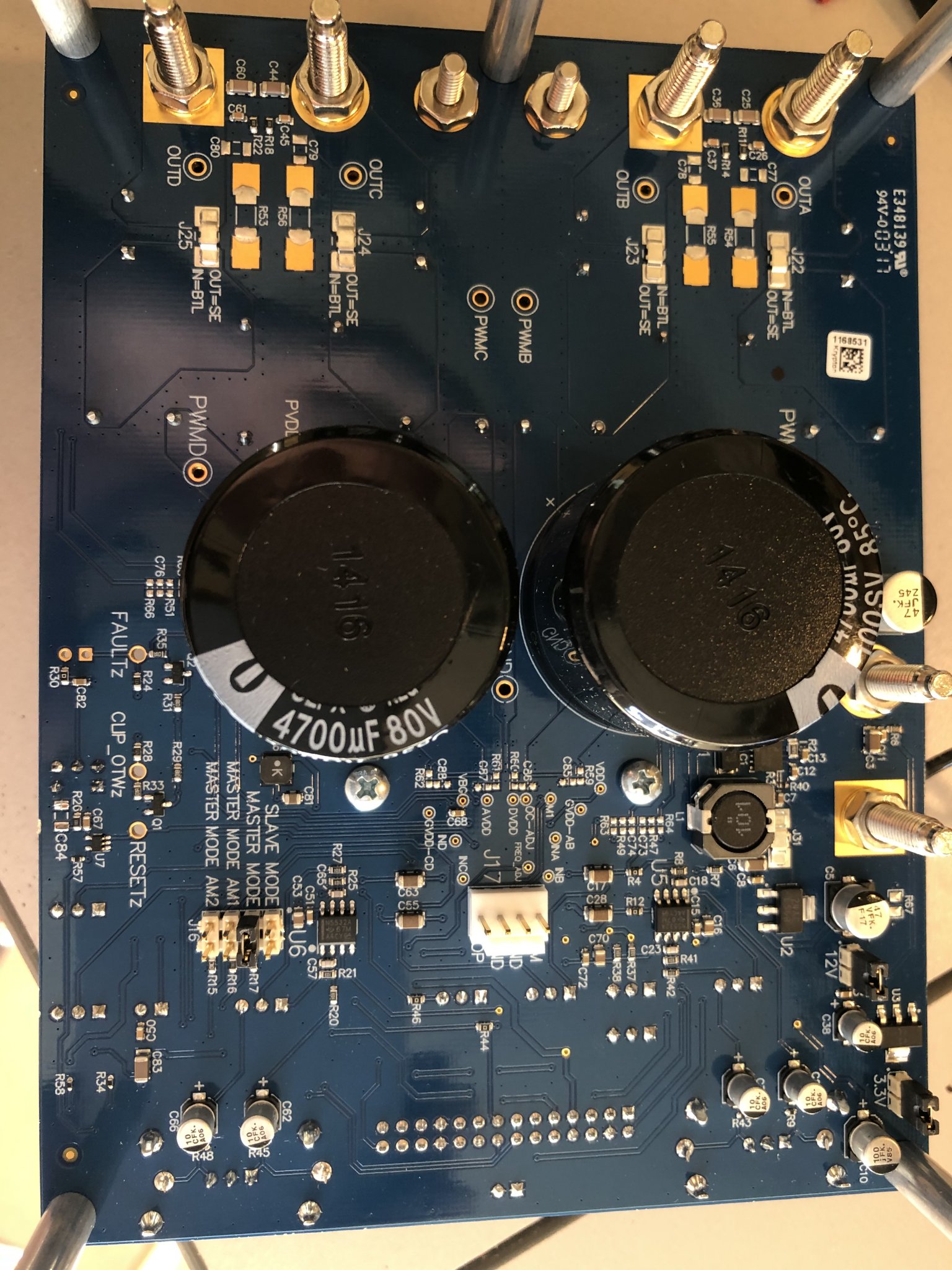

I tested the board again and the two green LED’s are on , including the FAULTz (red). See attached pics. I tried flipping the reset switch a few times but no luck, all lights are on. The red did not disappear as it should.The things that go bad on these amps are usually the 15v DCDC buck converter U1 which is then regulated down to 12v and then again to 3.3v. The LDO's hardly ever fail unless over-voltage driven. Do you have steady 12v and 3.3v? This is indicated by two green LEDs. Sometimes the bootstrap cap C1 (o.047uF 100v X7R) on the buck converter goes bad so replace that to get the 15v output U1 working.

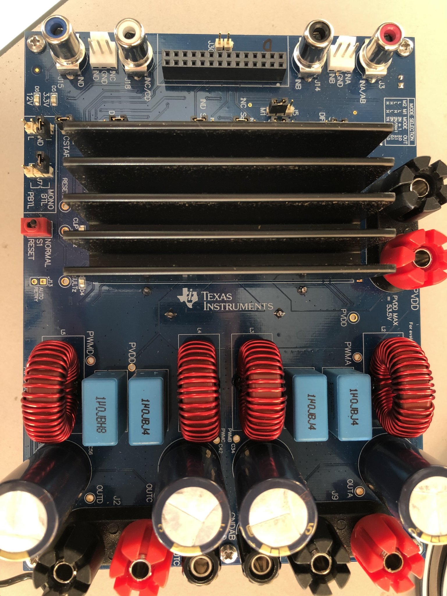

I then proceeded with the 2nd diagnosis as you suggested. Hard as I try, I cannot locate the C27/29 & C52/54. Am I missing something? I looked at both sides of the board but cannot find it. I looked several times. The only caps I saw are C26 & C25.
You have to remove the heatsink to get to the bootstrap caps as they are mounted very close to the pins on the chip. The red light constnatly on means something is bad, probably the bootstrap cap or a blown output MOSFET. In which case, replacing the TPA3255 is the only solution. It is fixable though and good clue that both 12v and 3.3v LEDs glow. Your power systems are good.
