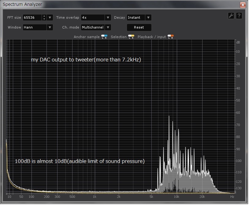

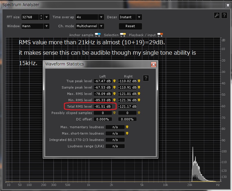

My listening ability is 15kHz at max. It's reasonable to have a brick-wall filter at 21kHz like red book CD. That's the way I used to. But incredibly, I must admit I can hear the difference between without 21kHz and with more than 21kHz. My system is a digital crossover 4-way. The tweeter is more than 7.2kHz. Someday I happened to design the coefficients without 21kHz cutoff, the 1st pic(the input is real music). The 2nd is with 21kHz brick-wall.
Both had a clear audible difference. I could hear better bass in the 1st pic(more than 21kHz). Some people say if you want bass, improve treble. I'm for this since my several experiences say yes. I'm sure I can clear the ABX test because several instruments have an audible difference in bass. So, my music files now don't have a 21kHz cutoff. I need to remaster my 44.1kHz files to 48kHz. It's not difficult to convert 44.1kHz to 48kHz since the original ones are digitalized from vinyl at 96kHz.
My hypothesis about the "hyper ability" is bandwidth. Removed power by brick-wall isn't small because it's not single tone but bandwidth. I calculate the power more than 21kHz. The 3rd pic shows -81.51dB. So, sound pressure is almost 29dB, which can have a different effect from a single tone. Audible ability on a single tone(15kHz in my case) isn't an optimum probe to decide max frequency. Sound pressure by the bandwidth may be more important for the human ear.
