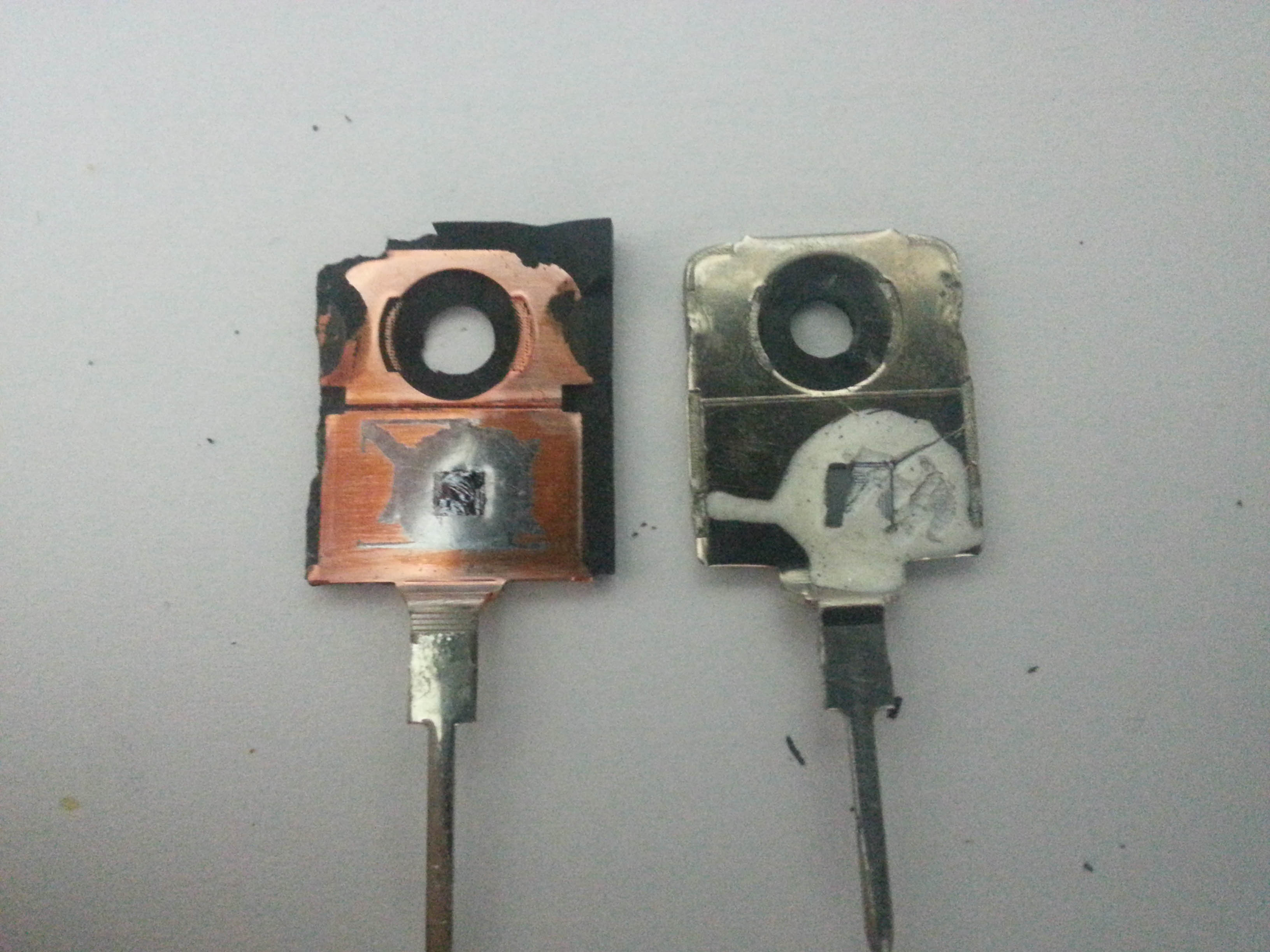

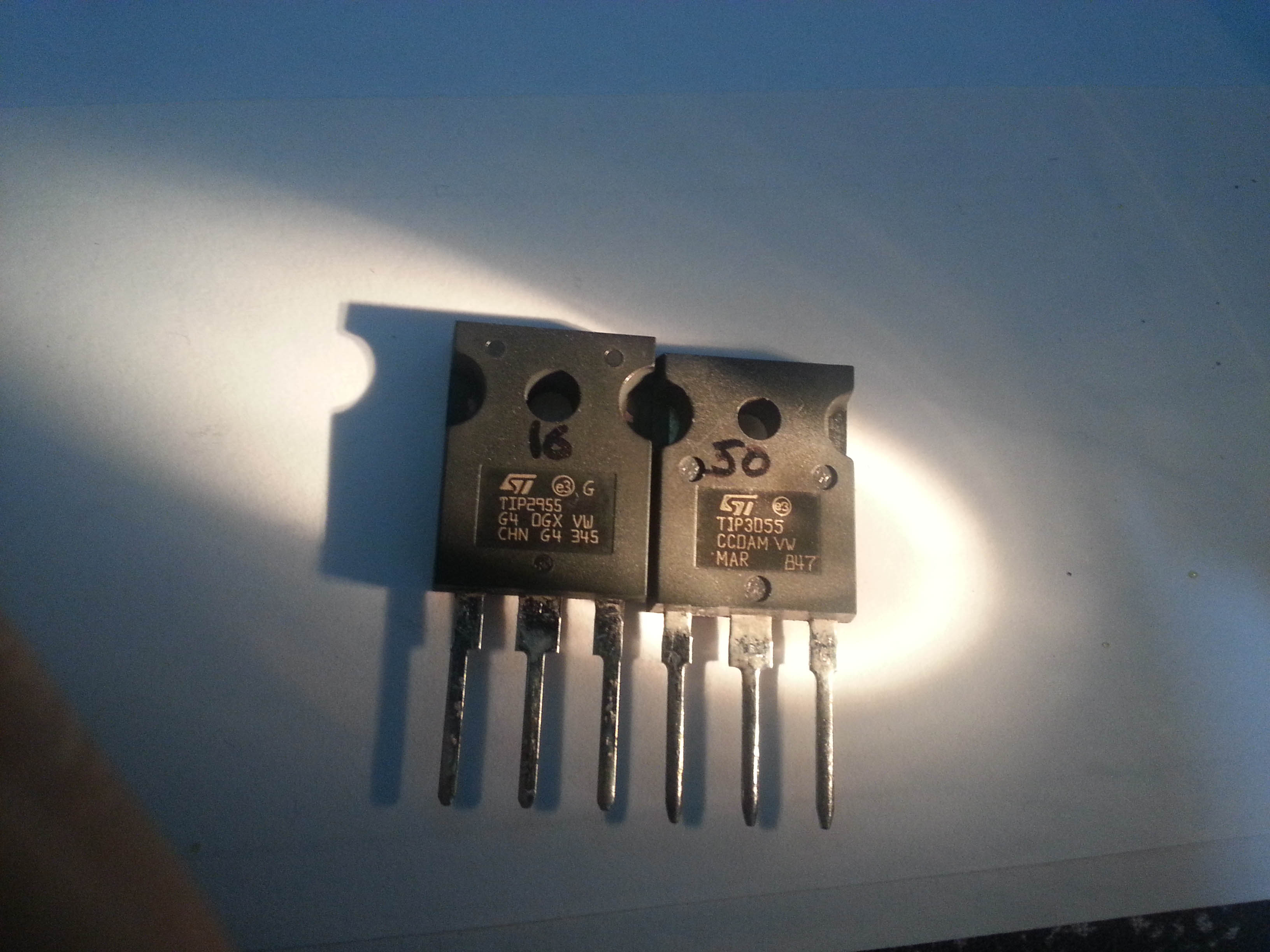

Hi people all from the world.im confused 😕 here with these transistors.I need professional look and tell what hell is this.I will be thankfull all.Thank you my friends from the world...
Thank you for your reply welcome.Is it really fake.it is very cheap transistor and it is fake 🙁
It has better hfe and bigger die size.(3055)

They both have inconsistent appearance - likely both fakes because the 2955 has the wrong backplate and leadframe for ST Micro TO247 products - as established in your previous thread.
http://www.st.com/st-web-ui/static/active/en/resource/technical/document/datasheet/CD00000918.pdf
